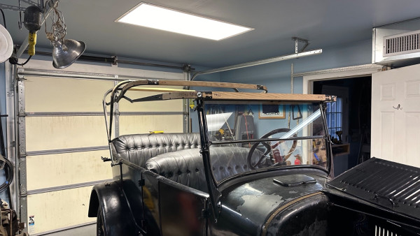

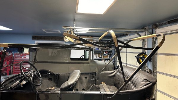

I’m working on a `26 touring ..
It came with a nice set of top bows,,wood kit for bows,,and the rivets …..
I got it all fit and ready to drill and install rivets..I have the backup tool but wonder what the driving tool looks like to round it over …
They have a hole down the center …..
Should I heat before I set them ….
Thanks for ANY help you can offer with the process…..Carl
