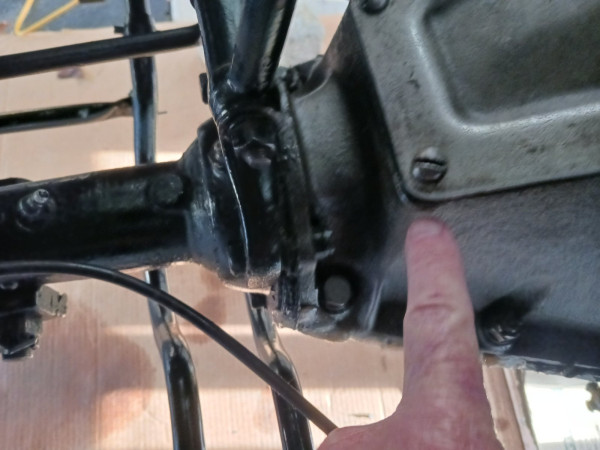

Is it possible to take a picture of the area where it leaks? Right rear of hogs head is very close to the Universal joint and could be coming from that area.

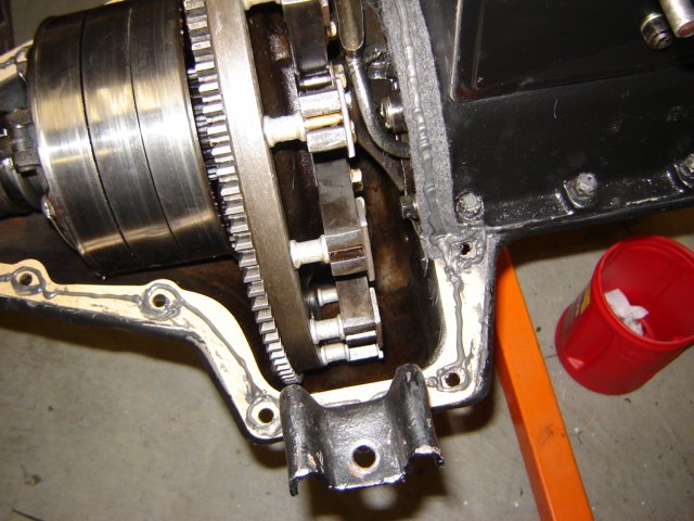

I chased an oil leak down near both lower corners of the hogshead - turns out someone previously had used too long of bolts on the field coil mounting holes down on both bottom block holes and just "cracked" through the casting - copious amount of Brakleen then black RTV and bye-bye oil leak !

Post by TheSaintDiscJockey » Wed Nov 01, 2023 9:06 am
Did some looking around this morning.
Since oil doesn't run up, it has to run down.
Looks like the screws affixing the transmission inspection cover were loose, particularly the corner where the offending oil drip was coming.
(Keep in mind the other day, I was viewing the leak from underneath the TT)
With the floorboard lifted off, I could see the oil path.
Tightened screws.
I do have a gasket in there.
This should do it.
Will start up on Saturday morning. Many thanks for the helpful comments.

BTW, your transmission cover is upside down. V goes down to drip on the band centers.
N/A if you have a screen.

speedytinc wrote:
Wed Nov 01, 2023 10:26 am
…And that’s probably why it doesn’t seal good. It doesn’t seat properly against the hogshead.

That inspection plate is easy to remove. Just 6 screws. A little sealer on top of the hogs head then a new gasket with no sealer on top of the gasket. Turn the plate over so the V is down and tighten. Start with the two center screws and then the outer screws later. After you tighten all 6 of them start again and tighten as tight as you can with the screw driver but not enough to strip the threads or break the screws. Should be good. Since you have already tightened the screws, you could try it as is and maybe not need to replace the gasket at this time.
