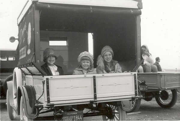

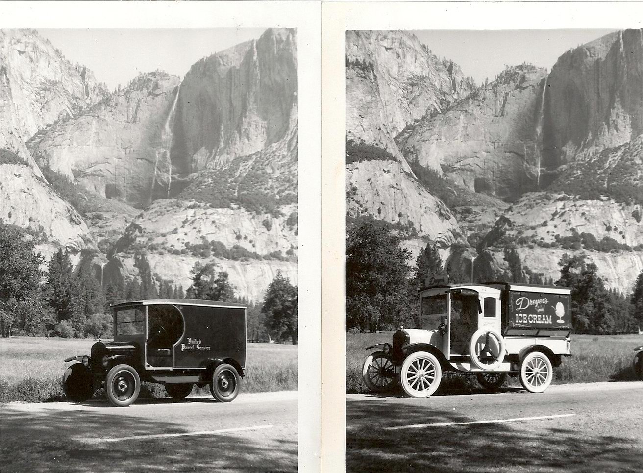

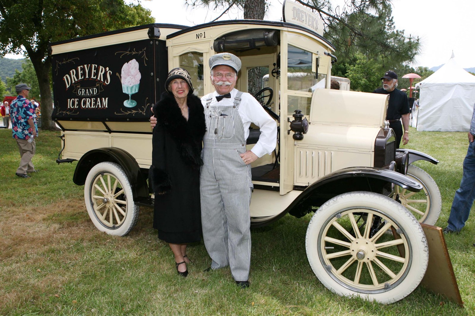

Ed is dead to rights right.
If you're relying on low gear, you MASH that low pedal and hold it. Once you commit to Ford low, you commit. Those transmissions will NOT crap out on you. Serious beans, they were built for the duration! (And yes, the motor will put up with it!)
I remember a LOOOONG time ago when he and Karen came from Calistoga to our folks house in Santa Rosa for Dinner in their centerdoor (I must have been in my teens.... yeah!)... it's one squirrley road from Calistoga to Sana Rosa... but it was then that I realized Ford knew what he was doing, once you locked that "low" band into place, that car was going to stay in Low until the driver gave upon it. It's a lesson I never forgot...
You don't play that low band like a "baby maybe"... you LOCK that mutha into place, and you let those triple gears work their magic. Honest to pre-Godfrey, Ford and Couzins KNEW what they were talking about in that planetary gearbox, it's really darned near indestructable IF you trust it to do it's job.
Have faith in your car. It will NOT let you down.
