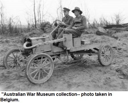

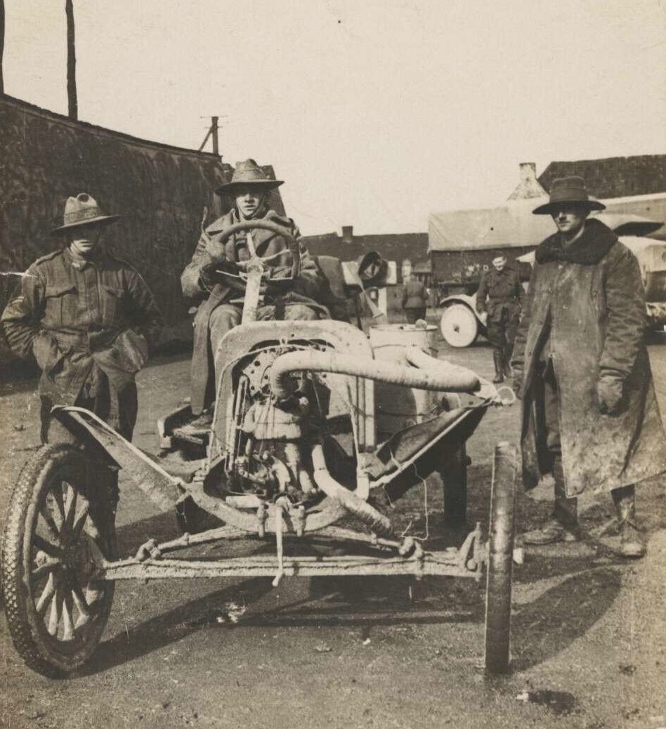

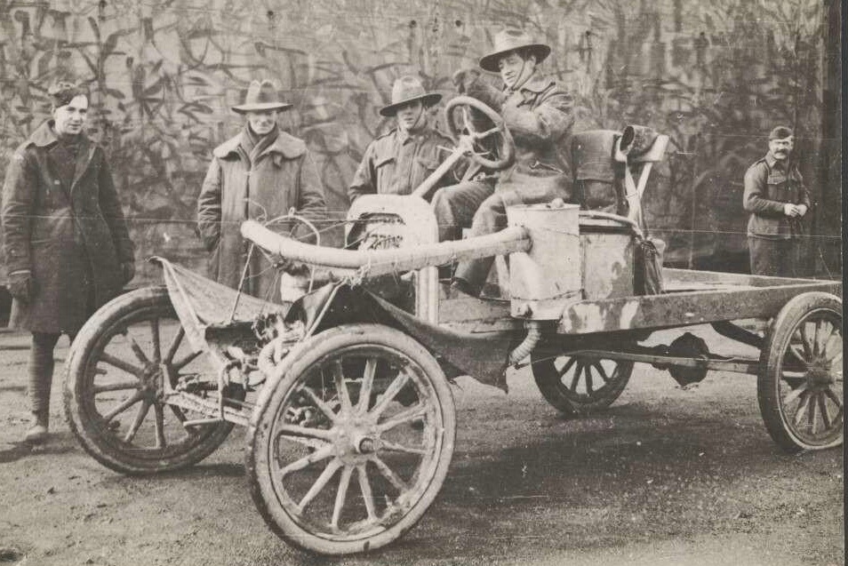

Thanks for that, Henry. Here's a better photo of the rig. It looks like the frame was lengthened. I wonder what its purpose was in the flying squadron ?

Its better to pull a plane into a hanger than to push it.Rich P. Bingham wrote: ↑Sat Nov 11, 2023 12:24 pmThanks for that, Henry. Here's a better photo of the rig. It looks like the frame was lengthened. I wonder what its purpose was in the flying squadron ?
(Thanks to the IMG_4732.jpegFB Model T group for the pix)
The above photos are in this earlier MTFCA Forum & very very large https://www.mtfca.com/discus/messages/5 ... 1449227796
Caption for both- "Members of 3 Squadron, Australian Flying Corps, with a skeletal Ford Model T car, Bailleul, France, 1917"
and this additional photo

Some of the earliest water cooled automobiles had only a cooling tank to keep the engine from overheating. The cooling tank isn't very efficient, but the small single cylinder engine running a lightweight runabout short distances and low speeds didn't generate a lot of heat either.
A lot of stationary industrial engines used only an evaporative chamber surrounding the single cylinder to dissipate heat. They often ran enough that the water around the cylinder would boil, taking the heat away as steam. The operator had to keep a watch on the water level to maintain the cooling efficiency, such as it was. If the water level got too low, and left exposed part of the cylinder, or cold water too quickly added to a low water condition, serious damage could result.
Radiators were often the first casualties of battle. Only a few bullets or shrapnel from one nearby bomb hit could render a radiator practically beyond repair. Replacements could be weeks away. Two holes from a bullet (one in, one out) on a cooling tank could be easily and quickly patched. A single bullet traveling at an angle could sever maybe a dozen tubes! Most inside the core where they could not be easy to repair.
The life expectancy for an automobile used near the front lines was short. They were large enough to be seen from quite distance, and gunnery crews liked to try to hit them! Chassis were continuously being straightened and repurposed as transport vehicles for use near the battle zones. They could run in with supplies, meals ammunition as needed, just a very few miles in and back. Or they could carry messages between command and the front lines. Remember, practical radio was still a couple years away. Horses died or panicked if too close to a cannon shot. The old Ford might be patched up again and again.
