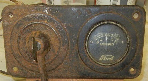

To add to the discussion, and of course be criticized, if you observe your ampere meter, set the ignition switch to battery, and turn your motor by hand crank, with the coil buzzing, you should observe that the meter will show a discharge of about 2 amps, or one line to the left (a discharge). Of course if you use a buzz box with a three ampere meter, you will note a current draw of 1.5 to 2 amperes.

The Ford ammeter installed in the dash is far from a precision instrument, and is certainly not accurate enough to set coil current using the buzz box method. It's just a rough guide that everything is working properly.
