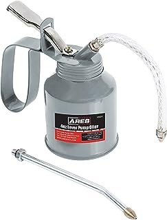

I assume you are suggesting a pump like this one?

Craig I been thinking about your oil pump idea. My calipers have 4 bleeders, two up, two down I assume so there will be 2 up on which ever side they are mounted. If you pump from the top, where does the air go? The fluid line in to the caliper is about half way between the ends of the caliper - wouldn't this leave an air pocket on the top? - Or do you open both bleeders and let the caliper fill befor sending fluid up line?

Post by Bill Robinson » Tue Nov 07, 2023 3:41 pm
Doug- start at either caliper. Connect the oil can & tube to the lower bleeder valve.
Open the upper bleeder. Pump until fluid exits the bleeder with no air. Close the upper bleeder.
Then move up to the T at the frame where left and right meet.
Loosen the connector on the line the you are working on. Pump until fluid escapes with no air. Close the connector.
Now- move to the caliper on the opposite side of the axle and repeat the process. If done correctly, there should be no air in either side, in other words- no air from the lower bleeder up to the T- on both sides.
Leave the pump connected to #2 caliper. Work your way up the tube and at each connection - loosen it and pump until fluid flows with no air.
Continue until you get to the master cyl, open the bleeder, pump until no air.

The new pump oiler I bought seemed to be working pretty well, until it stopped pumping anything. Cheap junk you find today. Any suggestions on where to find one that will last?

Post by GG Gregory » Sun Nov 12, 2023 5:33 pm
You might try antique shops. I picked up a USA made pump yesterday.
