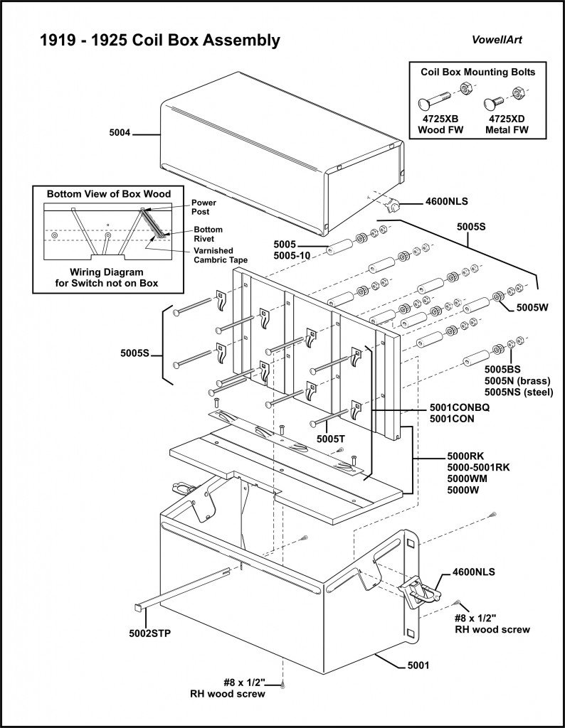

TimCarlson92 wrote: ↑Sat Nov 11, 2023 6:30 pmCan someone direct me to some schematics for rebuilding a coil box? It's for my 1924 coupe.
Thanks in advance!
Here is the Assembly schematic, found on Gallery link at top right of Forum page, under Vowell Art, lots of great schematics of T parts.
https://www.mtfca.com/phpBB3/app.php/gallery/image/127
The only wiring is for the positive terminal bolt, that is wired to the base common strip, at the rivet on the end, the wire goes to the brass bolt. Cut a slot in the head to lay the stripped wire into, and solder to the brass bolt. On assembly of the bottom plate, weave the wire into the slot below the hole for that + terminal bolt which is below the other standoffs.

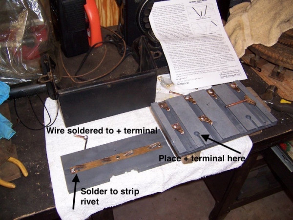

If you have a wood backers then seal it with something. I use Min-Wax wood hardner --
The picture is for the underside of the bottom - like your looking at the wire in the grooves
