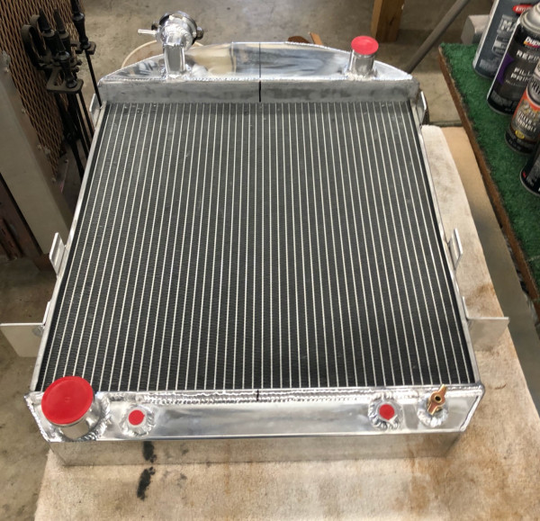

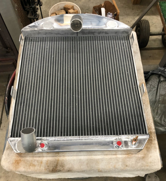

A Champion Brand aftermarket radiator for a street rod.., is it adaptable to a stock Model T? $178.00 vs ????? You tell me!

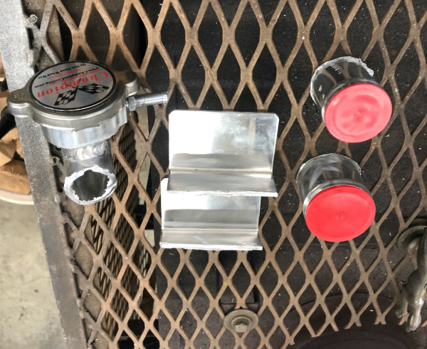

Just need to dimple the bottom for the front engine mount, weld in steam relief tube, reposition upper/lower hoses, filler neck, and mounting wings.This is a 3 row and appears to be pretty good quality.., will see when I start welding.
NO..., Not interested in doing modifications for others, just posting to show it is not that hard with a little skill.

Vernon I have bead roll machine too so that is the plan, just mocking up at the moment. Will keep you all posted. These radiators come in both high and low styles with pretty close measurements. Just a cheaper alternative for the driver and on a budget person. OPTIONS!

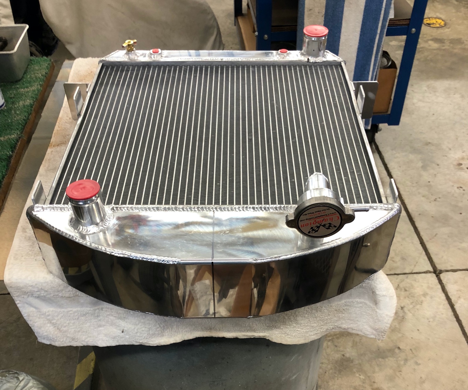

..., this being a 3 row (2 row are available) the core thickness is 3"thick vs 2 3/4" Fan may be close?
..., With the radiator shell installed it shows a bad fit at the top, meaning the radius on the radiator does not match well with the semi-flat/peak radius on the factory shell. Not a big deal but this pushes the radiator down causing interference with the front crossmember on the frame. Soooo approximately 1" will need to be removed from the lower tank to compensate. OK, this is doable.
Just doing preliminary adjustments in the fit before going stupid. Will keep track of time and materials to give a real cost for you all. These were made for street rods so the mounting ears that rest on top of the frame were up high for a double down horn frame like what is normally used on a 32 Ford High Boy. So the bottom tank was larger.
Hank

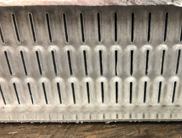

Not really impressed, the core is attached to the tank support by means of aluminum solder. This I have to be very care when using the TIG and use a shunt to control over heating. The core tubes are of a softer aluminum which with an internal magneto might cause an un-Godly amount of electrologist. The core tubes too were made for a modern engine and metallurgy, thus said it appears unless you are willing to coat the whole inside of the cooling system like a salt water outboard engine, those tubes are going to get obstructed pretty quick. Using an anode will more than likely only cause more issues as it will cause a gel to form when mixed with modern coolants.
So in my honest opinion...., not really worth all of this trouble thinking you are saving money. Long term, problems that could have been avoided.
