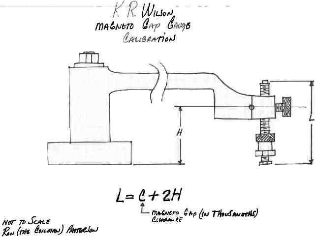

Found this from Ron Patterson.
Respectfully Submitted,
Be_Zero_Be
Be_Zero_Be

I got all the info: the service bulletin procedure & Ron's calibration info.
The caveat that the tool only works if the 3rd main is cut according to the KRW method. Mine was not
Good news/ bad news. Result was the calibrated tool got me .030 to far away, but the field coil was properly spaced all the way around.
Adding the extra .030" in shims got me there. Only 2 or 3 flywheel R&R's. Beats 12 or so.
My conclusion: The KRW tool was not more useful Than my home made gauge tool to justify the $2-300 the KRW tool is likely to cost me.

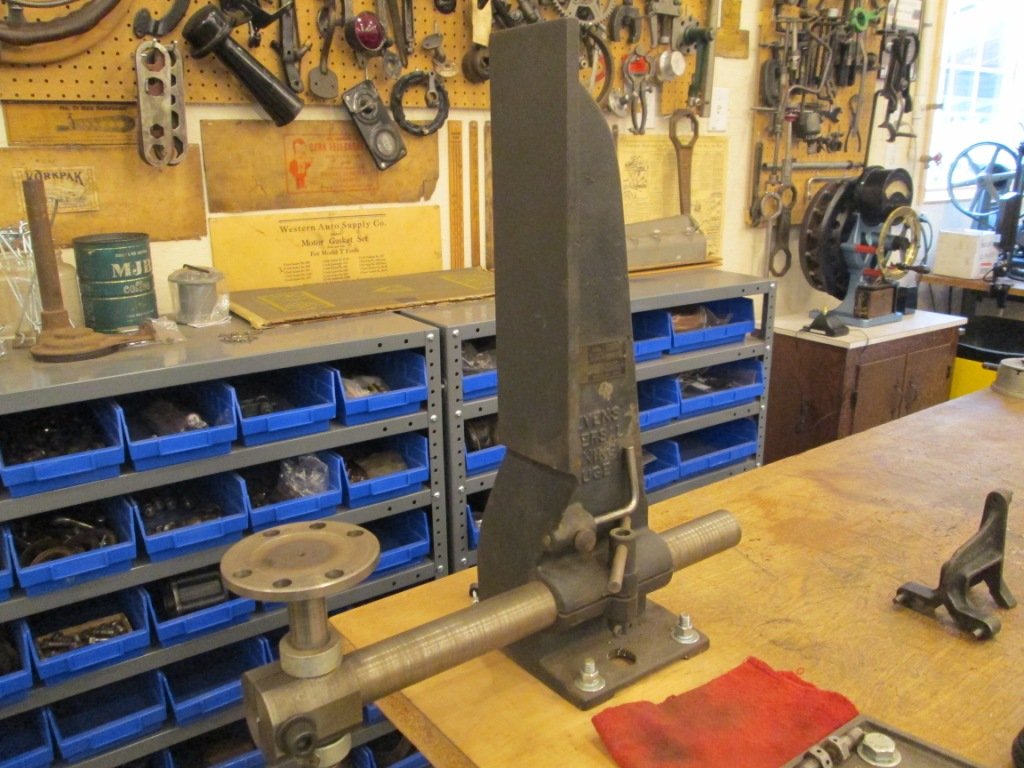

I had a machinist buddy make this shaft fixture for my Stevens rod alignment rig - works great for setting the magnet height.
