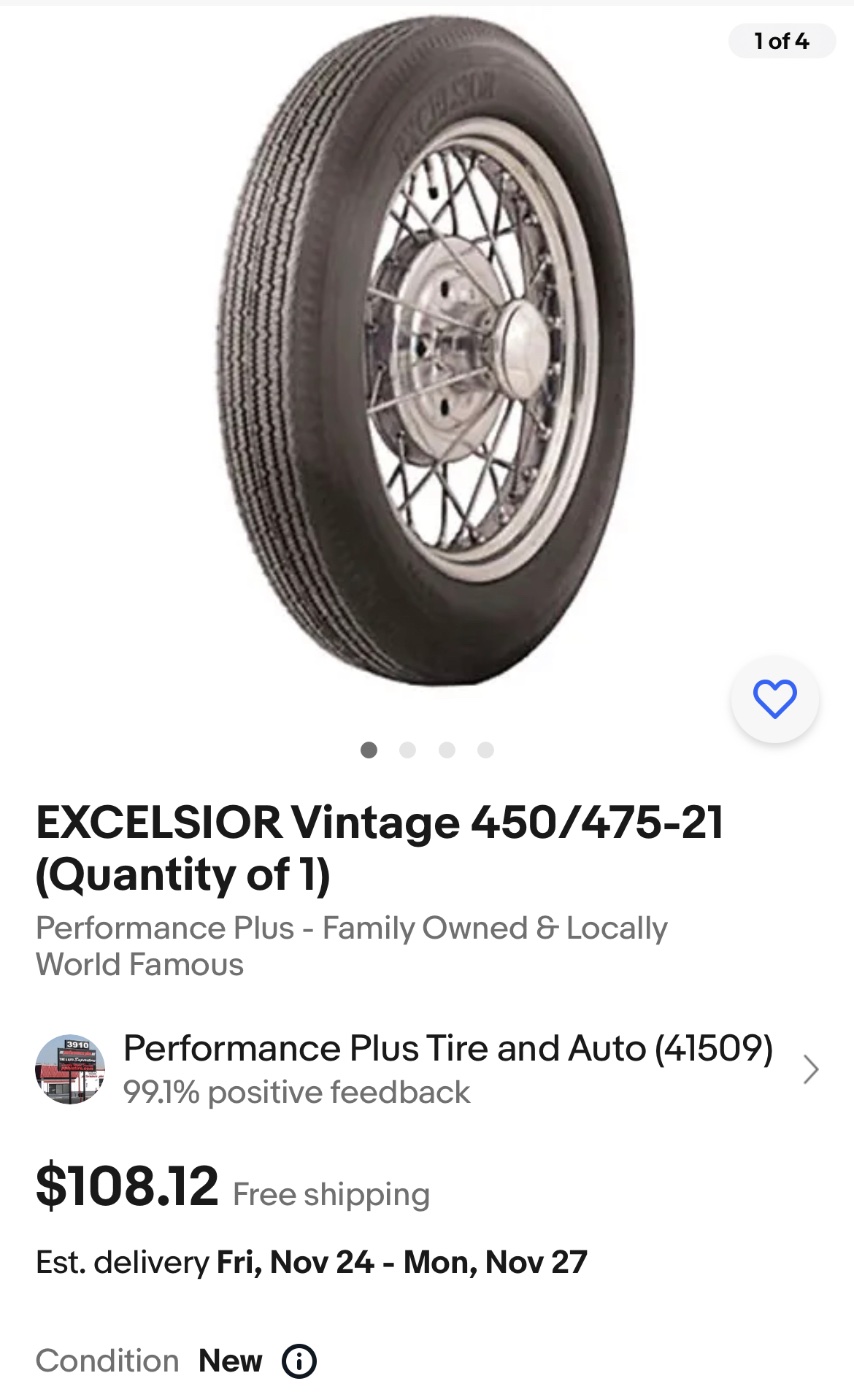

Tommy, as you can see per my previous questions & Wayne’s suggestion you do have options on tire/rim size. You could get four 21 inch tires shipped to you including your state sales tax around 7% for just under $465. Heck if you went the wire wheel route I’d even help out by gifting a pair of front OR rear wire hubs toward you keeping your T with conditions. You just pay the shipping if that will help you keep your T. You’d still need the wire wheels but I bet you could find some decent ones for around $100 each & maybe with a few kind hearts even less. Truthfully you’d still be at that $1200.00 or slightly above but you’d have your T an a bunch more memories to make. What’s that worth on a monthly basis? $100, $200? More? Best John
https://www.ebay.com/itm/404482296272?m ... media=COPY
https://www.ebay.com/itm/195601411130?m ... media=COPY

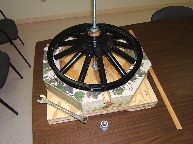

Have you considered doing your own spokes. The only cost is the cost of the spokes. I did my front right wheel 14 years ago and it was actually fun using the Regan Spoke jig. The first wheel will be the most difficult, but once you gain experience, it becomes much easier on the following wheels. Jim Patrick

Re: My last parade
I don't believe it works that way for non-demountables. I'm told they need to be built like buggy or wagon wheels, by a wheel right. If I had demountables I would definitely build them myself. Thanks.jiminbartow wrote: ↑Fri Dec 06, 2024 12:04 pmHave you considered doing your own spokes. The only cost is the cost of the spokes. I did my front right wheel 14 years ago and it was actually fun using the Regan Spoke jig. The first wheel will be the most difficult, but once you gain experience, it becomes much easier on the following wheels. Jim Patrick
