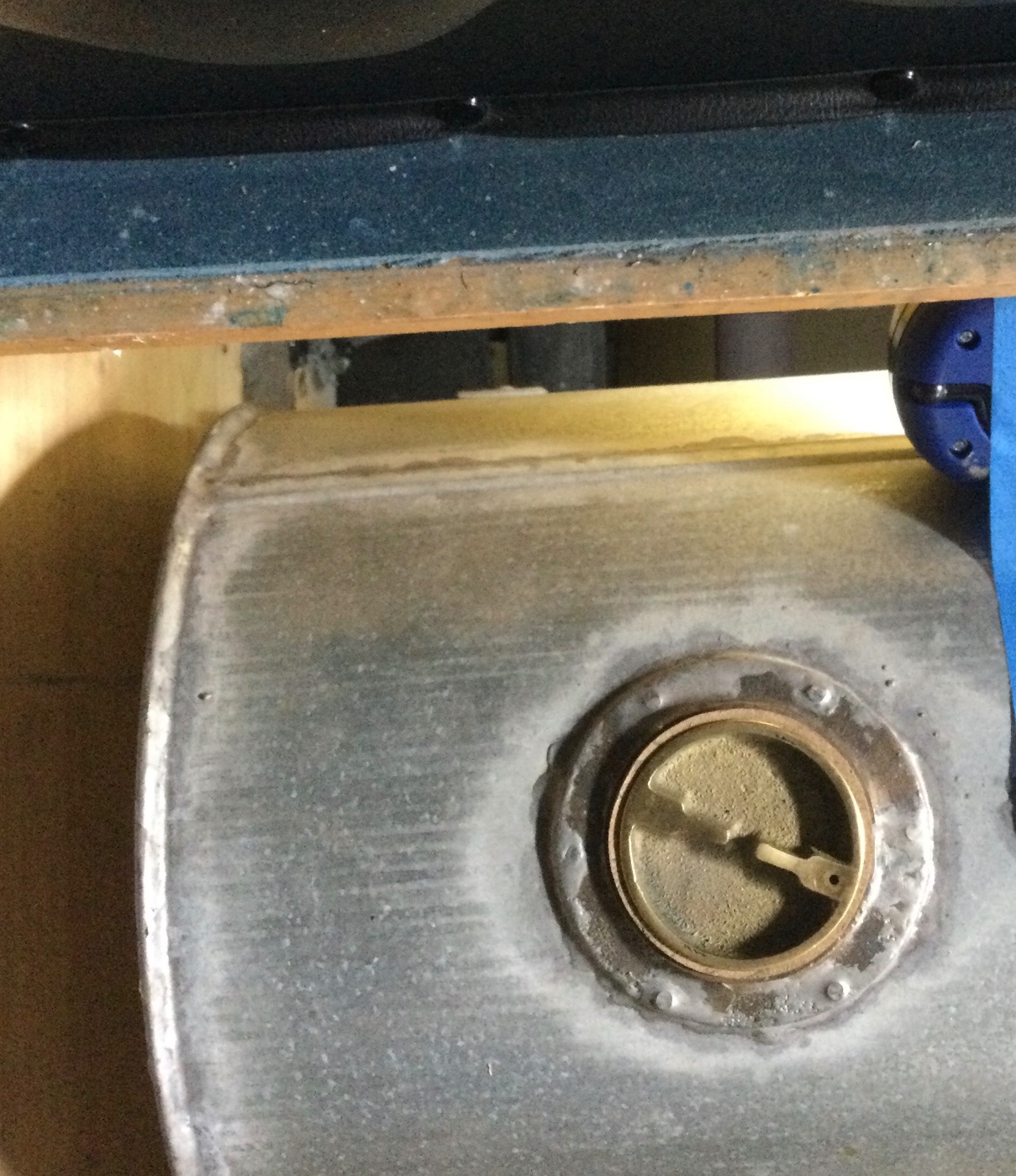

[attachment=0]669FFC8E-6297-4773-A6CC-43CD537DFB04.jpeg[/attachment]Taped a flashlight to the tank but it is still hard to see the frame.
