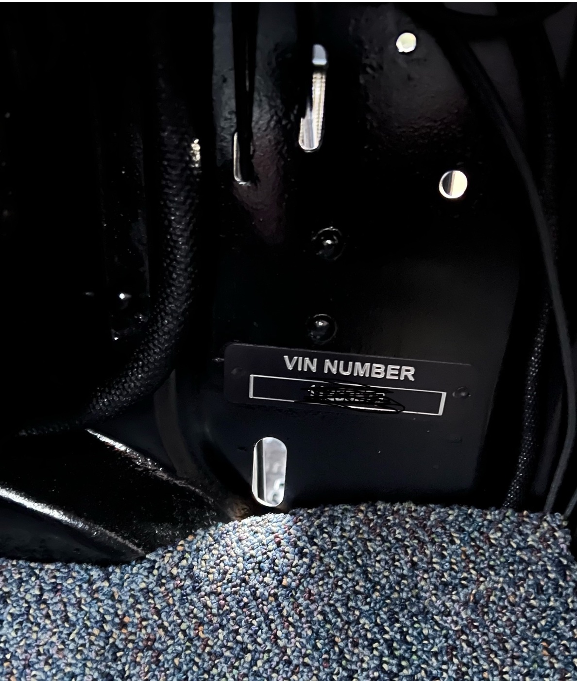

Firewall hole
Wondering about this rather large oval hole in my ‘25 Coupe firewall passenger side. Is it for a speedometer cable? Maybe it lets heat in? It’s not for carb adjusting rod, that fits elsewhere.

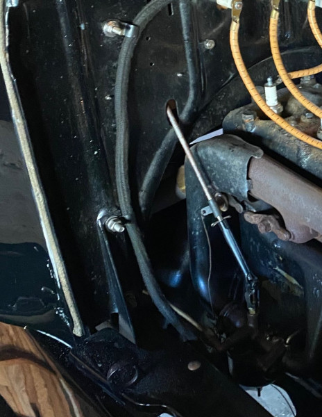

Re: Firewall hole
It is for the later version with the swivel top carburetor control rod. Here is a picture of my 25 roadster pick up.

Re: Firewall hole
Thanks!! I can sleep well now
