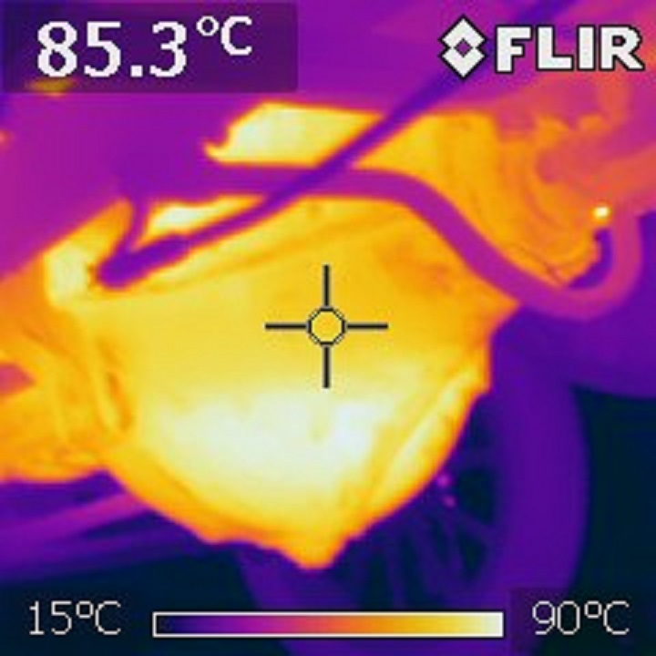

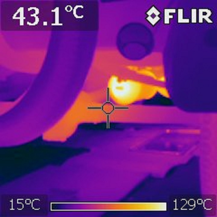

Objective measure is best way, just get an inexpensive laser heat temp gage and measure. Useful for lots of T parts, like the cooling system.'
These pics were on the forum years ago and useful too. You might get such a tool and measure the temp to see if it's in range.

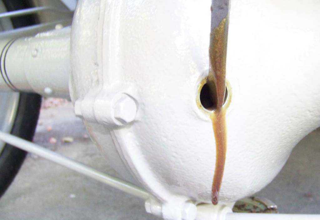

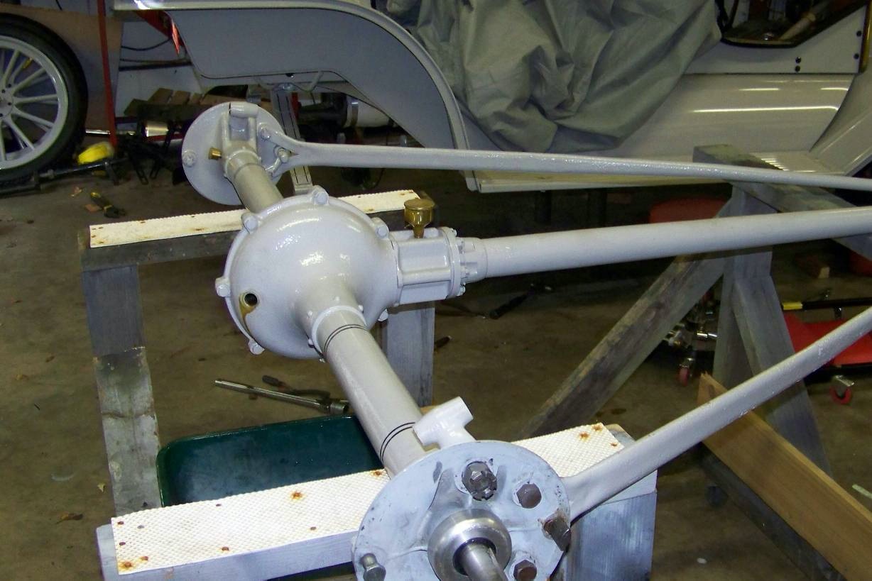

Once had a rear axle after just restoring with bronze thrusts. On that one did note that when turning the assembly with thumb and fingers thru the drive shaft opening, there was a tight drag at just one spot, but didn't give a concern. Should have.
The pumpkin got fairly hot to touch running on jack stand. Cooled down, drained some lube, and bronze flakes appeared in the lube. Had to redo, by adding more clearance to the thrusts by taking one down evenly.
Removed axle to redo....
Infrared Pic of T parts on warmed up T
Note the heat of the oil in the pan sump, when the engine is warmed up to operating temps, right around 185 degrees F. (85 C.)
And this one of the rear axle near the pumpkin, about 105 F, (43C). About normal IMO. Some heat there too, with the nearby muffler being much hotter.
