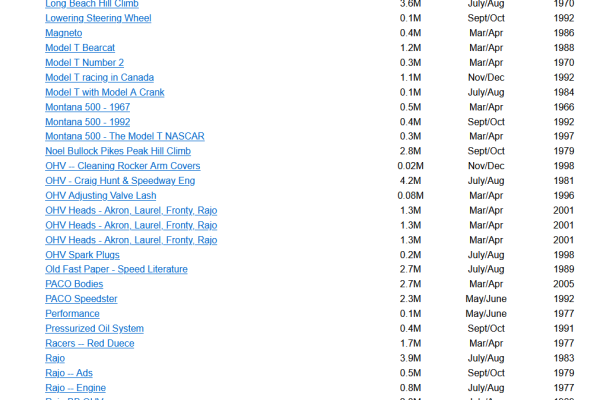

Take a look at these sites you'll need to browse around a lot.
North West Vintage Speedsters
https://www.nwvs.org/Technical/MTFCA/MT ... cles.shtml
just a sample of the index
These are different
https://www.nwvs.org/Technical/MTFCA/Ar ... edster.pdf

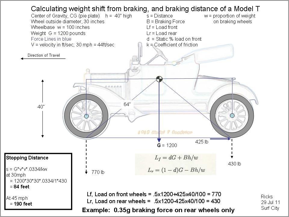

The real question for driving a Model T is how quickly do you want to stop. Once you have figured out how to achieve that stopping distance you can work on your engine performance, if necessary, to match it. :?
https://www.mtfca.com/discus/messages/3 ... 1368573238
