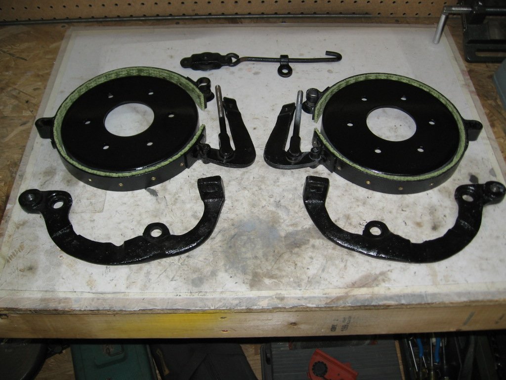

I was working with Larry Sidmore on getting some AC brakes from him. We had great conversations which were about 5 minutes of business and 30 minutes or more of car talk. He was a wealth of knowledge.
He passed before I could order his AC brakes. My condolences to his family. The few conversations I had with him were great. He was definitely passionate about T's.

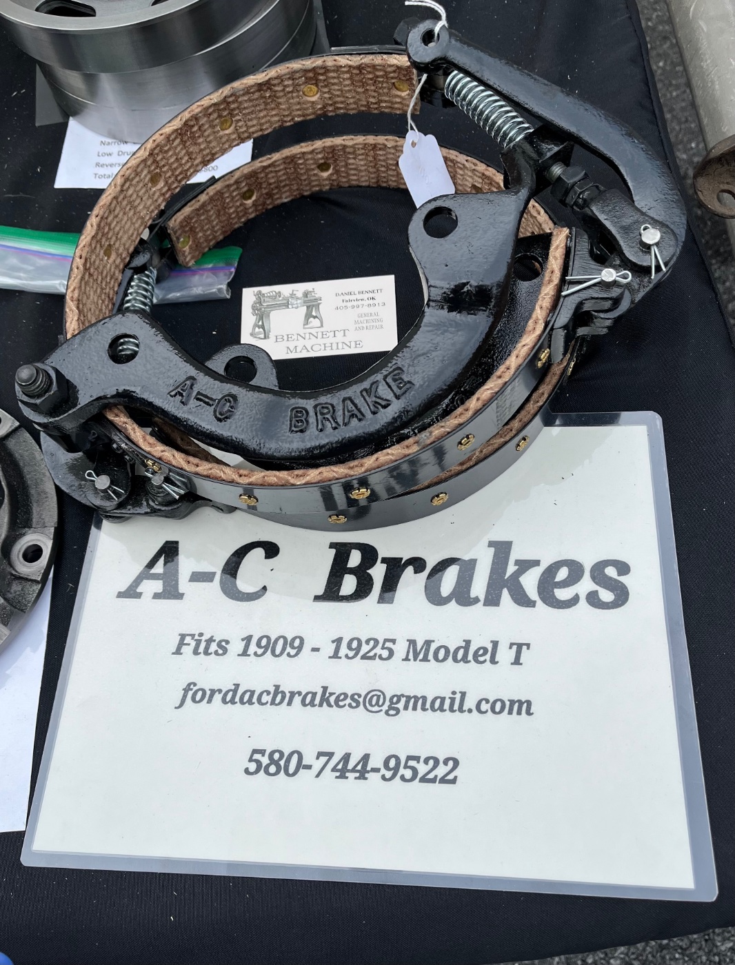

When I was at Hershey I learned that Daniel Bennett is picking up where Larry left off. I ordered a set of Daniel's and have it here. They look great.
I'm not planning on winterizing my car until salt hits the road. It could be today, or in 2 weeks. When it goes on jack stands, I'll be working on the rear bearings, seals and looking to install these.
They don't come with linkages or cables, so I need to figure that out. But here is what I received today.

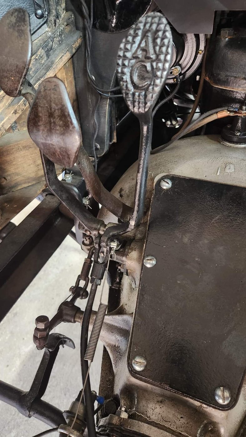

You have many options with that pedal. You can use the upper eyelet for a rod to a cable pulley or equalizer. Or the lever ( bottom ) can be
used with a RM or John Stultz equalizer using rods or cables. I used cables with Chevy park brake cables & cable equalizer on my A-C brakes
then switched to rods & seen no improvement. They worked good I thought rods would be better :(

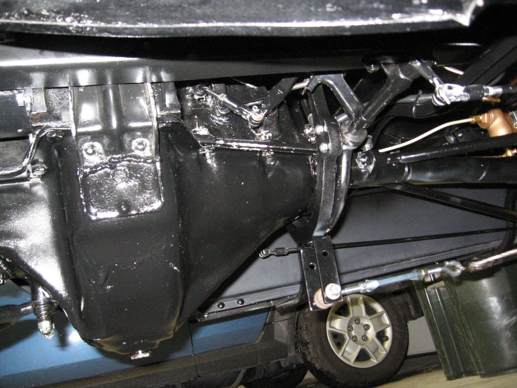

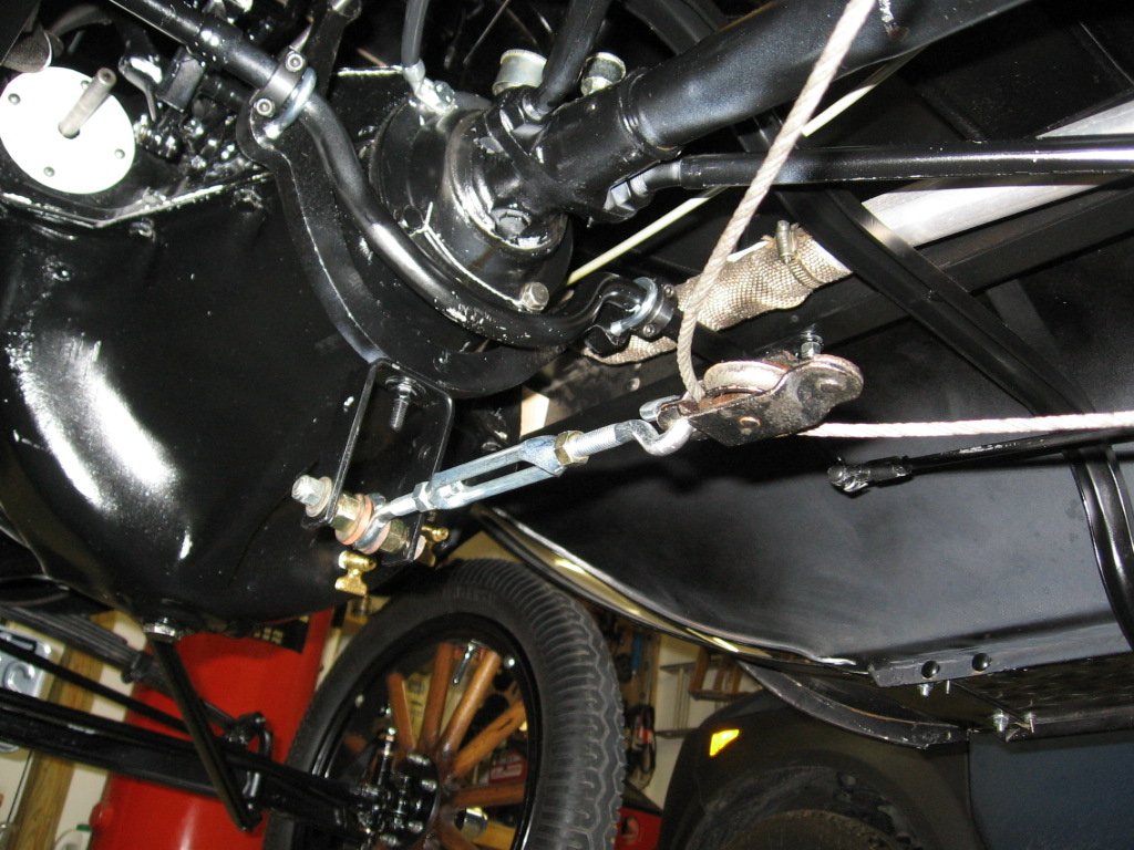

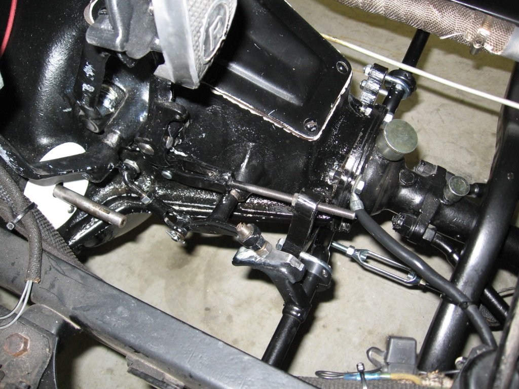

My 1924 has a set of original AC brakes that were set up to use a cable. I installed one of the pedals you show and made a link for it to push on the equalizer setup that is available from the vendors. Then I bolted a bracket to the bottom of the equalizer to pull on a turnbuckle and pulley that pulls on cables that go back to the brakes.

Post by Arbs » Thu Nov 23, 2023 11:41 am
Great photos Mark, thanks.

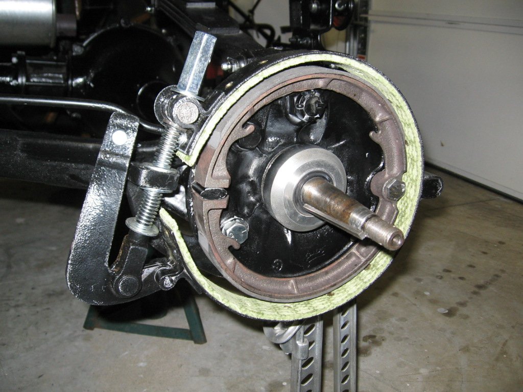

Post by Retro54 » Fri Nov 24, 2023 9:03 pm

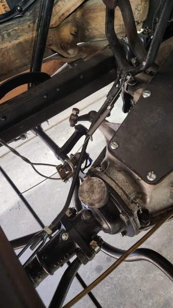

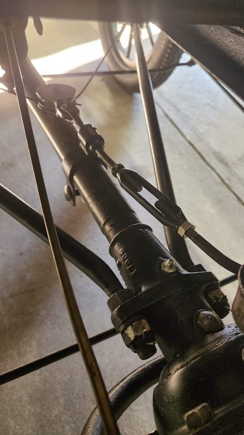

Was out at Dad's today and was checking out his adjusted linkage as he recently installed a fun projects stop light switch. Thought I'd share. He's still in the adjustment phase, so work in progress. He worked up his linkage based on old AC brake advertisement photos. Prior to the stop light switch it all worked wonderfully and held the adjustment just fine.
Just sharing for the good of the order.
