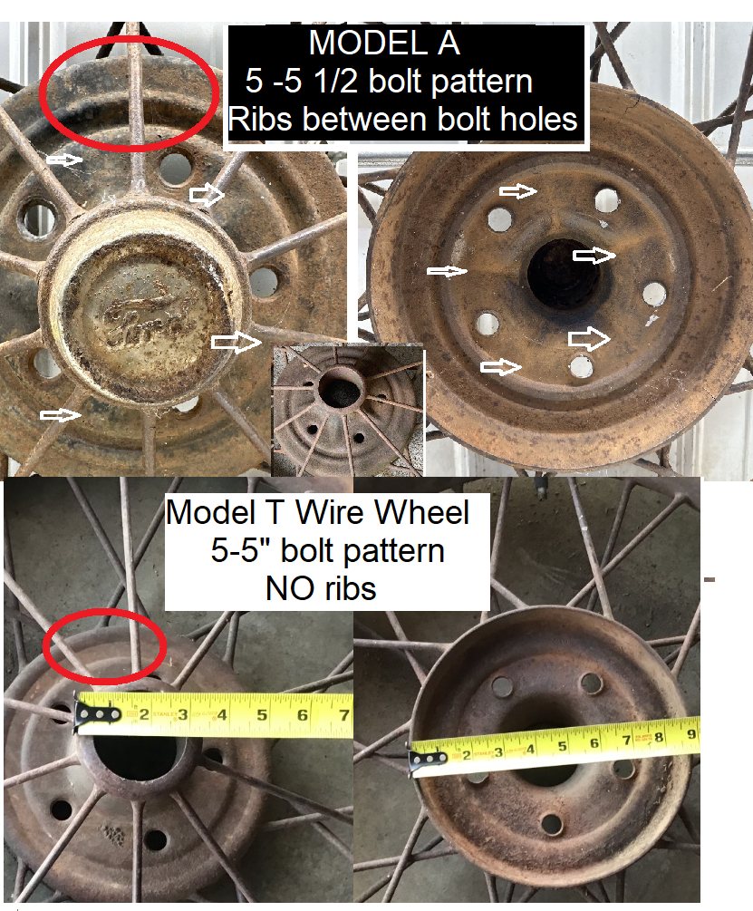

t wires have a smooth hub a wires have little raised things to make them stronger.
the bolt patterns are not the same

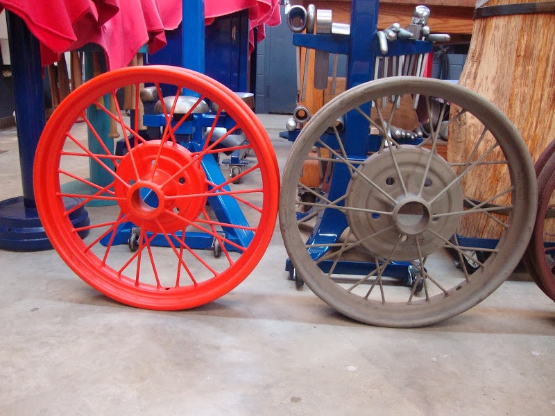

- Posts: 4089
Re: T wire wheels vs. A wire wheels
The centers are different, the A has concave look for the brake drums. The T on left, the A on right. The T has a tapered nose cone where the spokes meet. Many other obvious differences.

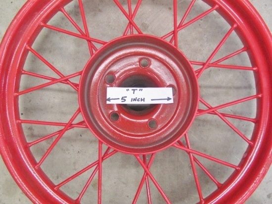

Or cut a narrow piece of cardboard 5" wide, for measuring the center lines of the bolt holes. The T is 5" the A is 5.5"

The most noticeable difference to remember are the ribs between a Model A wheel. The outer reinforcing ring is also positioned differently. Bothe have 5 bolt holes but their pattern is different

Frank has nailed the most obvious difference. All A model wheels have the ribs pressed outwards between the stud holes. These were added because of the propensity of T wire wheels cracking between the stud holes.

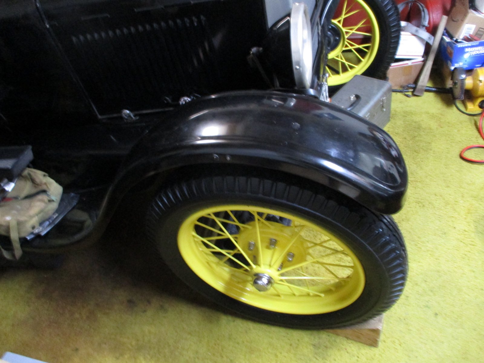

The 1928 AR Model T has the same bolt pattern as the 1927 T.
I found that out the hard way, after having two wheels bead blasted, repaired and painted.
Everything looked great until I added a new hubcap and it fell right through the hole.
That Model AR wheel is on my 1926 T Right Front now.
Sorry, left Front has the AR Model A wheel.
The one above is the correct 1926 wire wheel.

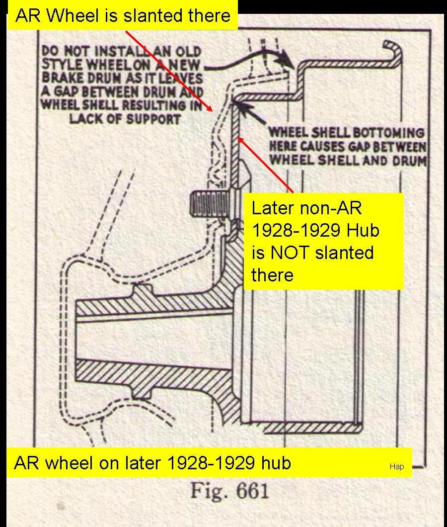

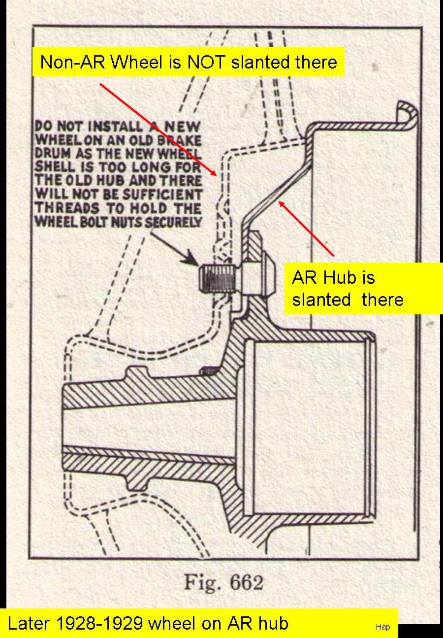

- Posts: 6587

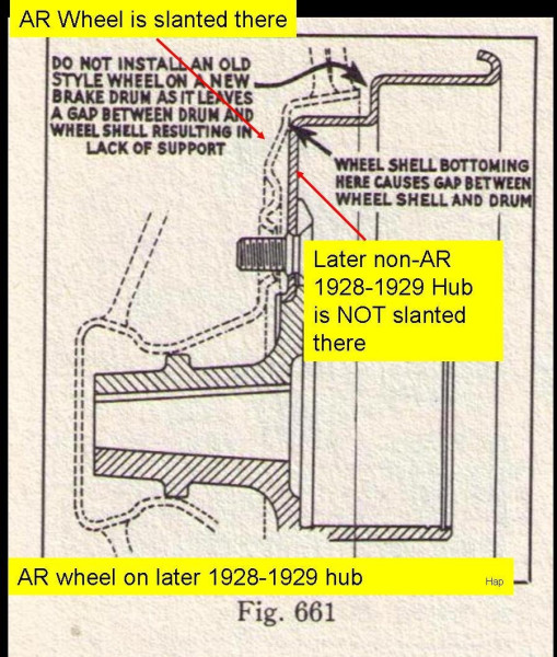

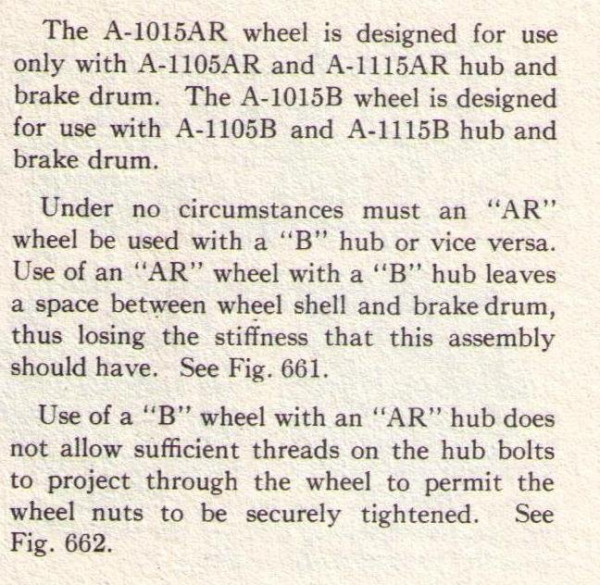

BIG Difference in AR wheels & hubsmodeltspaz wrote: ↑Tue Nov 28, 2023 2:19 pmHoly cow, Jim! From the looks of that photo you posted of that AR wheel, it appears that the only difference between a 26-27 wire wheel and an AR wheel is the hubcap opening.
But, like I said, I've heard those are scarse. I believe they were only produced for less than a year.
Thanks for the clarification. Always open for more learnin'.
Thanks for the clarification!
That wheel did not seem to want to go on all the way.
I do believe there is a difference!
I have not used the car since the wheel was changed, but I bought another correct wheel, went through the same procedure and the hubcap fit!
I will get that one on soon! It does have a new Firestone tire and is ready for a drive.

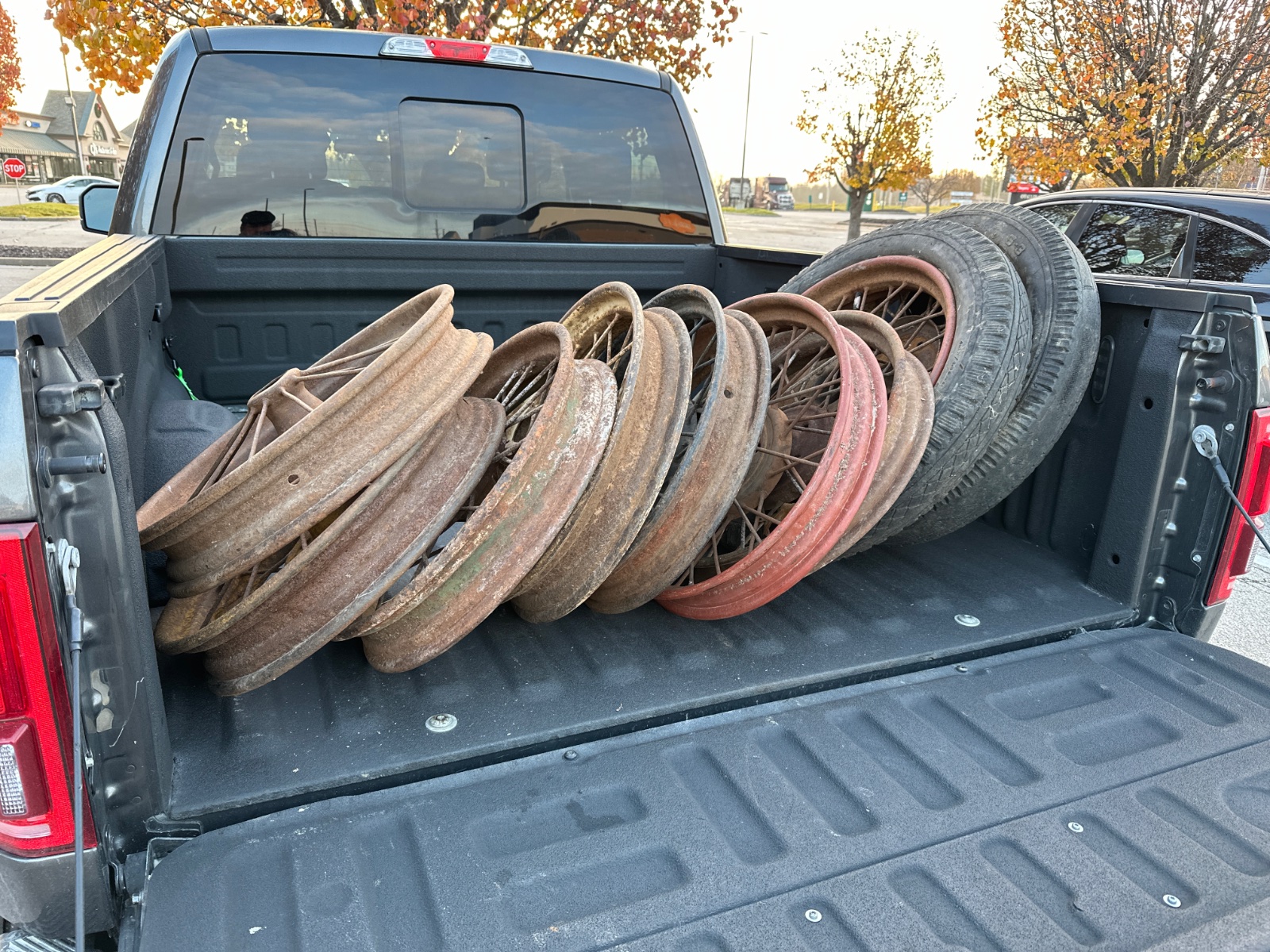

Thank everyone for the help,
I was able to get the wheels today.
The set morphed from a set of 4 into 9 wheels.
