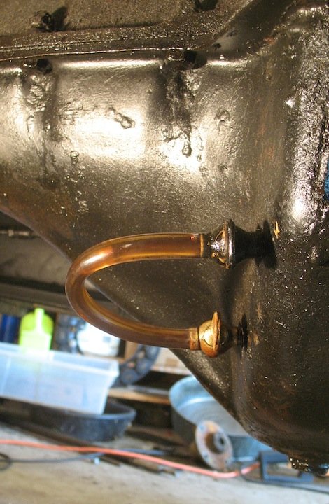

My car has a dipstick accessory that works well. To check the baseline oil level, I put the car on a level surface and took out the top cock on the pan and used a bent wire to check the oil level. I marked the dipstick when the level was halfway between. Model T oil pans don't all have exactly the same capacity. Unless you are in very hilly country, or driving in a race, it's best to run the level just above the lower cock. Don't use thick oil. Auxiliary oilers are a good thing to have, but some of them can over-oil the engine. In that case, the oiler can be adjusted to lower the rate. That can make the difference between an engine that oils the # 1 plug and smokes, and one that does not smoke at all and shows even color on all 4 plugs.

Tim, this is how Steve Jelf checks oil level. He only opens the petcocks to check the level then closes them.
