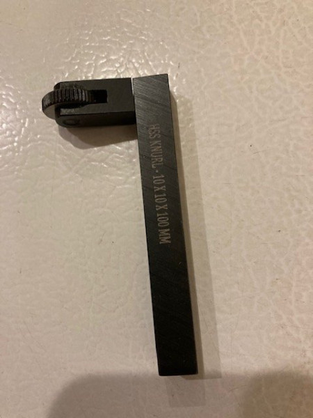

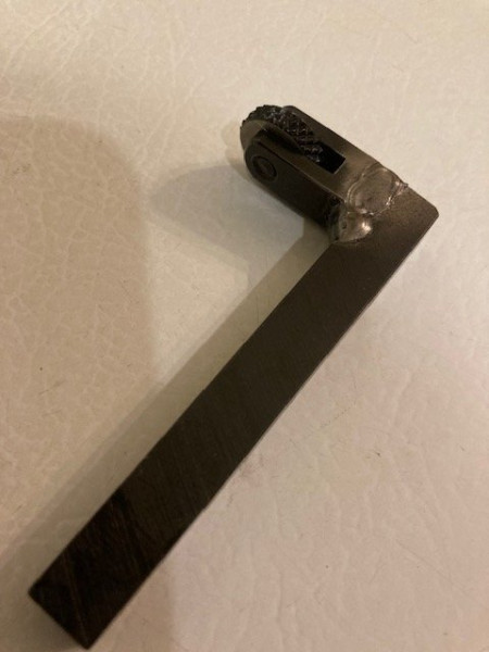

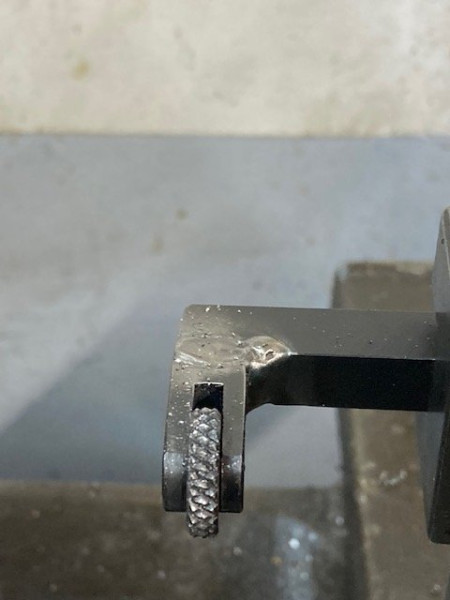

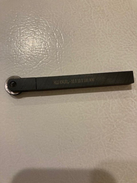

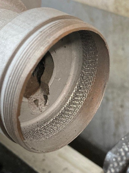

Hi Bill, This seems to be coming up a lot lately. This is what I did the last time. I picked up a cheap single knurling tool with 6 different wheels.
Cut it off & welded it @ a 90* on the end. Indicated the hub in the lathe & knurled the I D then smeared green Loctite on the hub & pressed it
in. Loctite 660 can also be used as was pointed out the last time this came up. If the hub is still in the wheel knurling like this is really not a
option. Craig.

The knurl job looks good. I would still use a little locktite product.
If the gap is on the large side, I have had excellent service with locktite 660.
Choose your locktite product it match the gap.
"Straw-berrying" the inside, from what I have seen, isnt a permanent fix alone.
There isnt enough raised metal to stay tight.
