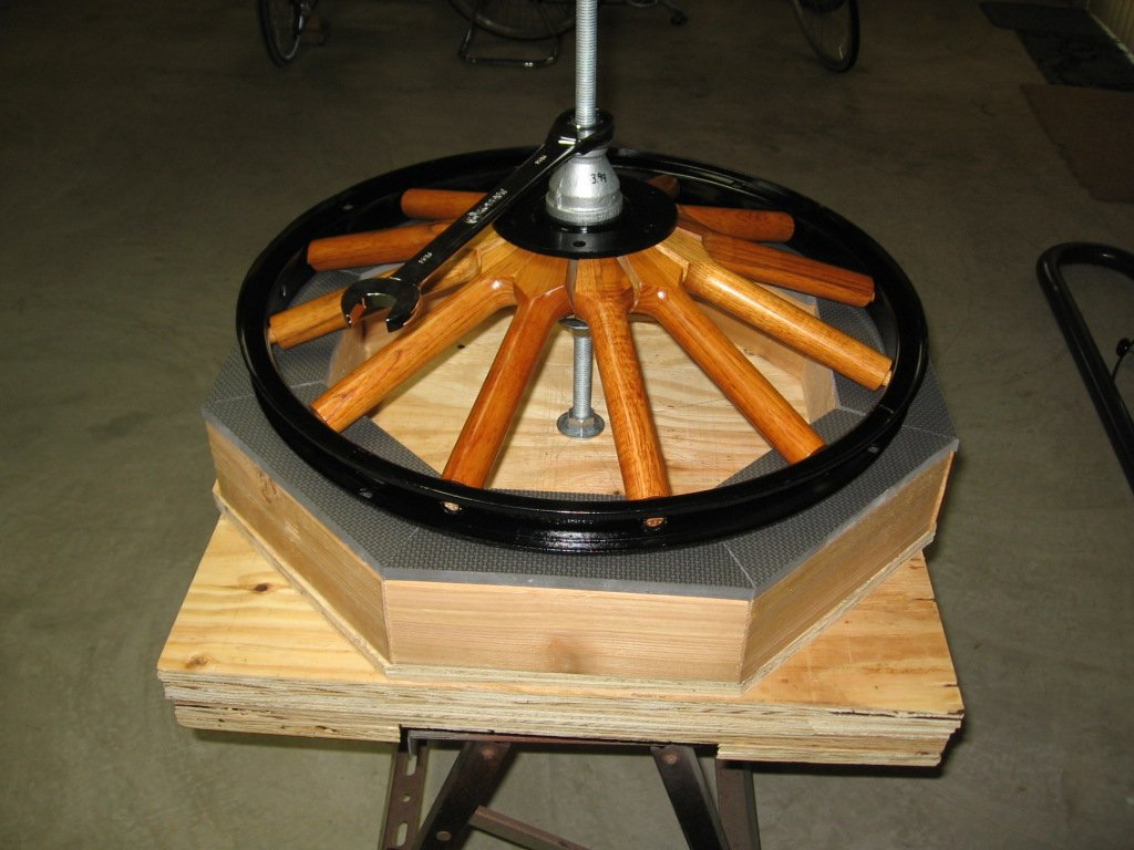

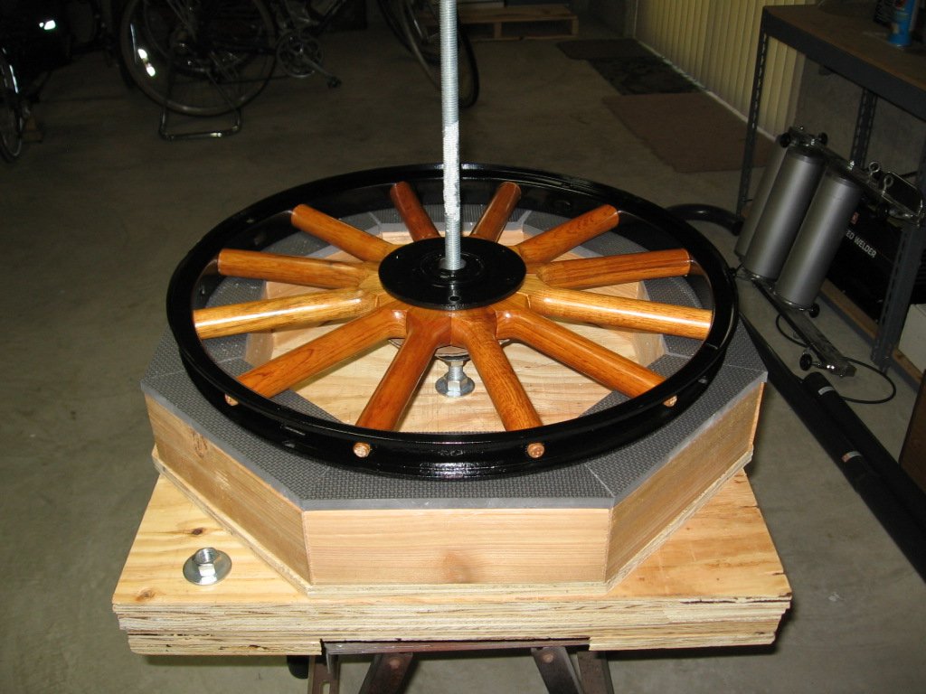

Here's what I used on my spokes. The issue I see with using a press is you need to make sure that you support the felloe around its whole circumference so that it doesn't end up warping like a potato chip while you're pressing.

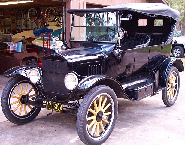

Have varnished both old spokes and new spokes. Using only a very high quality varnish. The better ones are used on wood boats, I used only Epifanes brand, has extra uv-filter to keep gloss. Made in Holland, not cheap, but will last for years. Below photo is more than 10 years after finishing.
Trick for best results is to thin the varnish 50% for the first coat. Use only bronze wool between fully dried coats to remove any specs or tiny runs. Take your time, each coat then is less reduced until to get to the 4th or final coat, then apply full strength. Allow plenty of drying time between coats.
New spokes varnished in 2012, still very nice ten years later.
These are old spokes, refinished with varnish in 1981, looked good in this photo of 2012.
