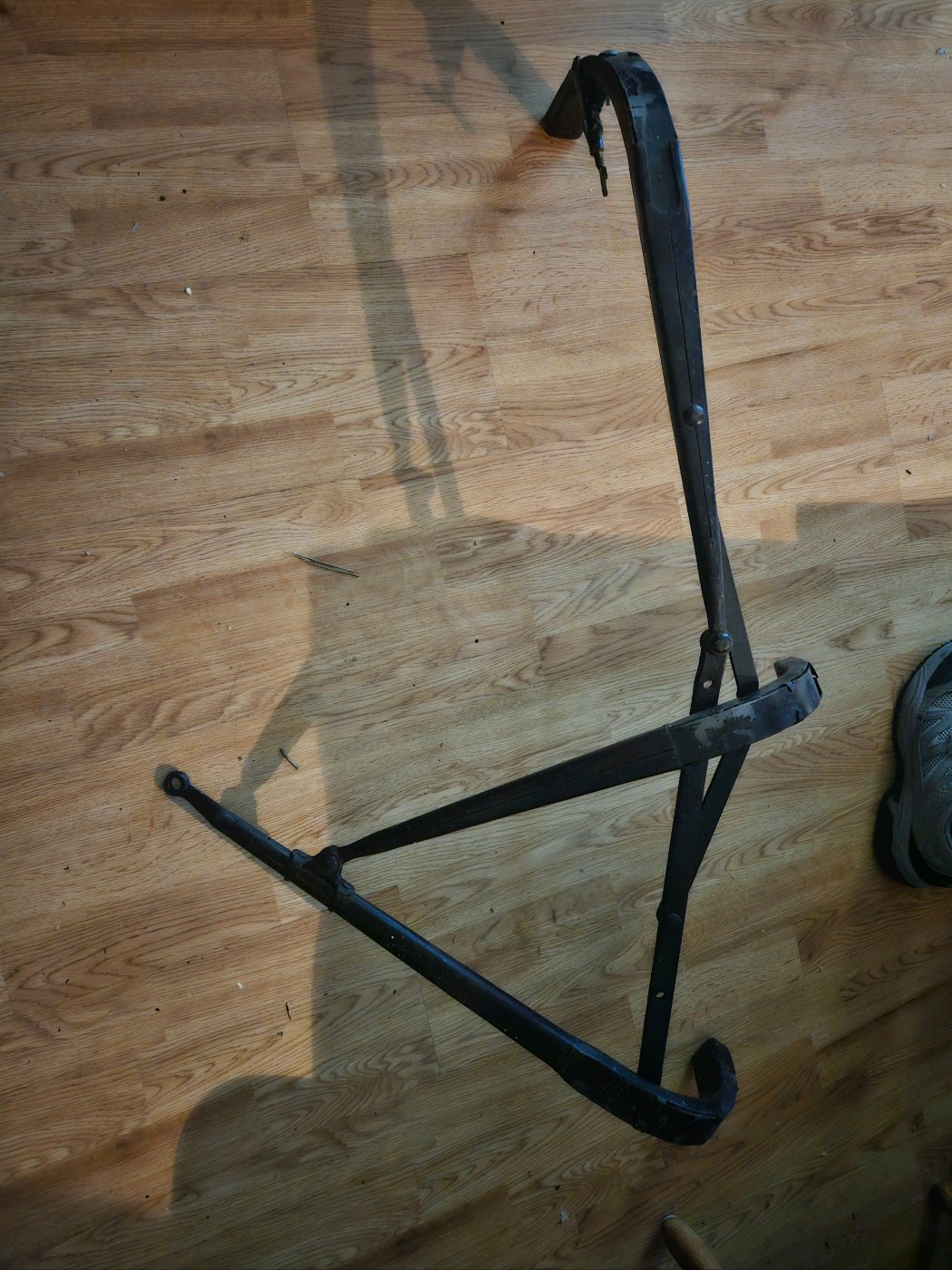

Post by Nv Bob » Mon Dec 04, 2023 3:18 pm
Have set of top irons forsale that they where late style but seems they are earlier had lots inquiries
If they would even ot correct ???

Re: 23-5 top bow work on 26-7 body???
Post by speedytinc » Mon Dec 04, 2023 3:44 pm
Your set seems really screwy.
Its too complicated for a roadster.
It most like a 27 touring, except its missing a bow? & the body attach point bow should be curved.
Posts: 4479
Post by Jerry VanOoteghem » Mon Dec 04, 2023 4:11 pm
They look fine to me for a 23-25 Roadster.

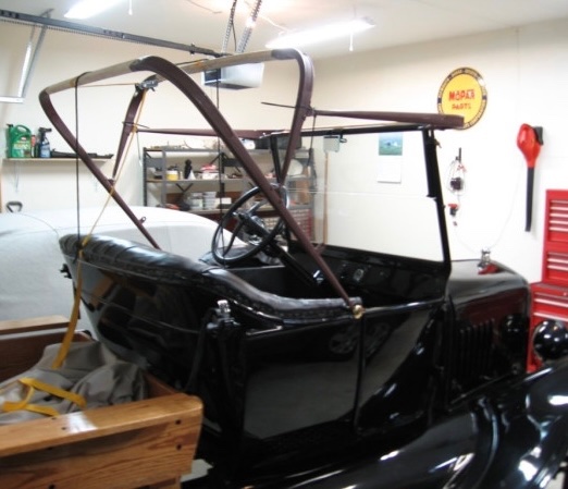

Post by Norman Kling » Mon Dec 04, 2023 4:24 pm
I have a 26 Roadster but it has earlier bows, most likely 25. They fit fine and the top works, however, it is more straight in back than it would be with the correct bows. See picture
e
Post by JTT3 » Tue Dec 05, 2023 7:41 am
Bob like I posted in the classifieds. If you look you’ll see the thin supports that strengthens the total assembly as in a set of sockets for a touring. Maybe someone made those or it’s for another style car. The 23-25 roadster sockets are a simple affair. 3 sockets on each side, no metal webbing between the sockets. Straight & clean. Below are pictures of the sockets mounted on the tub of a 1923-5 roadster or cut off roadster can’t tell for sure. I believe these are from the build Mark Strange was doing. Hope you don’t mind me using them Mark. Best John
