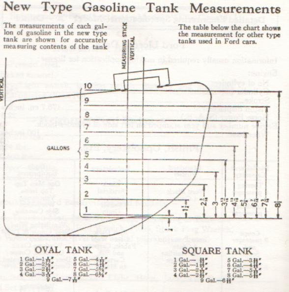

- Posts: 6558
Re: How Much Gas Should a 1927 Model T Use?
I was looking at your "My 1927 Model T Coupe Restoration" viewtopic.php?f=2&t=20699
and didn't see a speedometer/odometer just a hole cut in the dash. All the things you did look on the up-n-up, so I was wondering how you calculated the distance traveled & how you measured the fuel in the tank (before and after the trip). The stick on the hump indent at the bottom of the tank could cause an error in reading. Wouldn't take much with just 40 miles of driving

- Posts: 8501
The car must be standing on level ground for accurate measurements.
The farther the car is driven between measurements, the more accurate the measurements can be expected to be. It's normal for MPG to vary due to about 1,000 variables that affect it.
