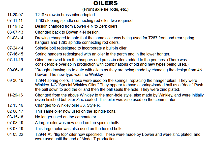

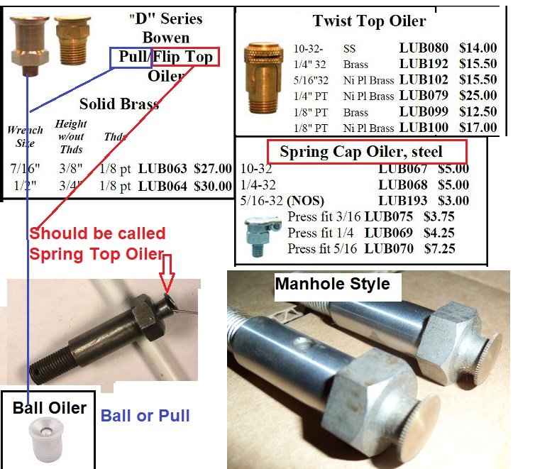

Got curious....
There is appears to be some terminology conflict when referencing oilers as either "Spring" vs "Flip-Type". The parts manuals for years 1910-1920 only reference part part 2715 as a "Spindle Oiler". When a parts list references 2718 a "Spindle Oiler with Cap is that a Manhole style?
The description for the Winkley 1-G says "when you push the ball down it acts like a door" so is a "Ball Type" oiler?
I believe that "Pull" & "Ball" are the same type oiler
From the Model T Encyclopedia
I couldn't find a picture identifying an oiler specifically as a Bowen 4-N or of a Winkley 1-G .
I tired to relate the oiler images to the descriptions from the Encyclopedia above to relate when used.
So "flip-top oilers" were specified in 1922
Does anyone have some period pictures to verify these differences?

This is a bit chicken/egg timeline stuff. The flip top oilers were not needed until the brass oiler type shackles were deleted. The adoption of cheaper L shaped shackles would have been associated with the adoption of flip type oilers. Perhaps the change of shackles will indicate when the oilers were changed.
As far as I know, the manhole type oilers were only ever used on the tie rod ends and king pins, although I have seen a few timers with them also.

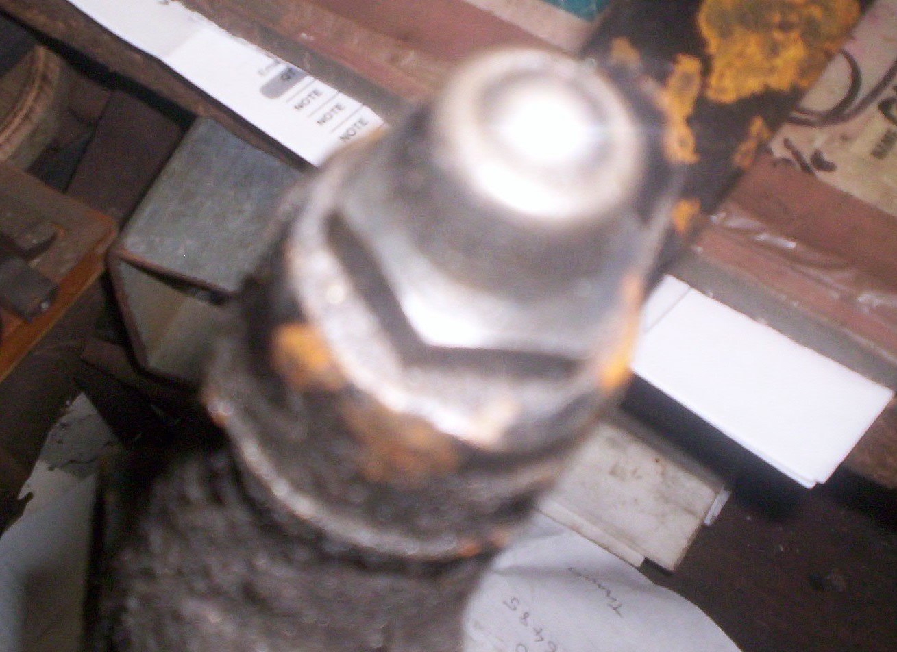

Post by Kerry » Fri Dec 08, 2023 12:05 am
Just to confuse some more, Frank's list of time frame changes, shows that in 7-24-1914 that the spindle bolt re-designed to incorporate a built-in oiler. This spindle was in my 16, the spring and ball is built in the spindle as a one-piece unit.
