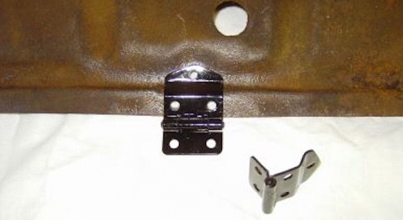

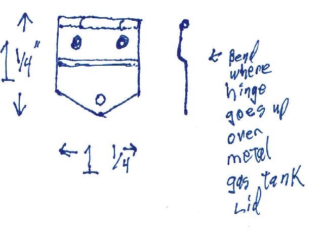

Posts: 4090
Re: Question on hinges
Post by DanTreace » Thu Dec 14, 2023 3:23 pm
These pics were on the forum on an earlier thread about gas lid hinges.
