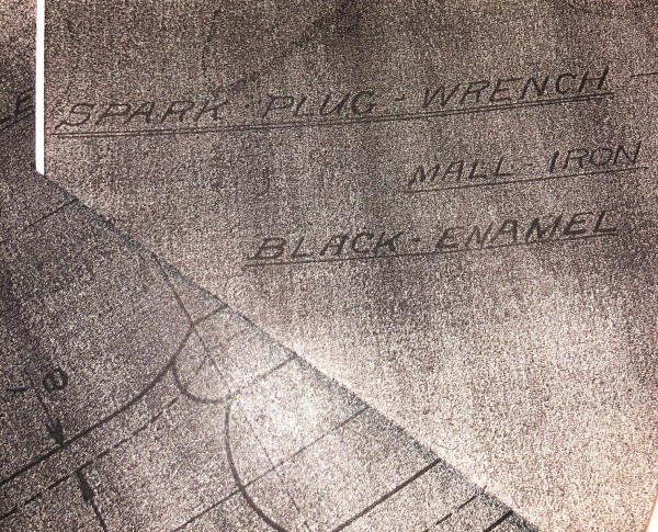

Some tools were specified with finish.
Socket plug tool.jpg (221.5 KiB) Viewed 1117 times

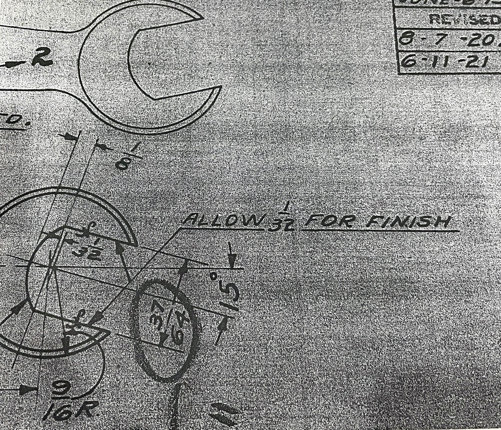

And the 1917 Band nut and Pack nut wrench. Note finish remark, the spec. also called for Cyanide Hardening. So a finish remained after that process, likely a black one, as carbon is absorbed during the hardening.
