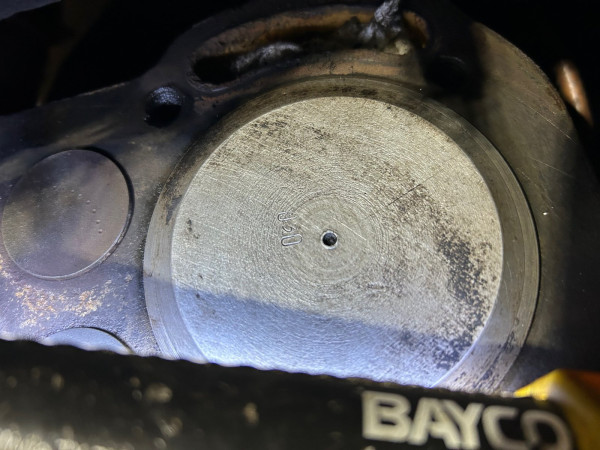

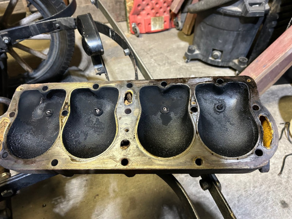

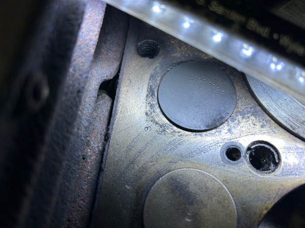

Last week I pulled the head off of my T to clean out the carbon deposits and take a look at the head gasket. It definitely needed cleaning! Once I cleaned the pistons I found .030" marks on the tops all 4. As I cleaned the top of the block I found a "3" stamped between the #3 and #4 cylinder valves. Could this be a corresponding mark on the block indicating that it had been bored .030" over?

Most likely an inspector or shift stamp.

Yes, your block has been bored .030 oversize. The marks on the valves were likely made to keep track of what valve went where. Not really good practice to be banging on valves, but that's what some people do/did.
Your carbon deposits might look messy, but they're no big deal. With modern oils and fuels, carbon deposits are nothing to worry about... and nothing to waste a head gasket over.

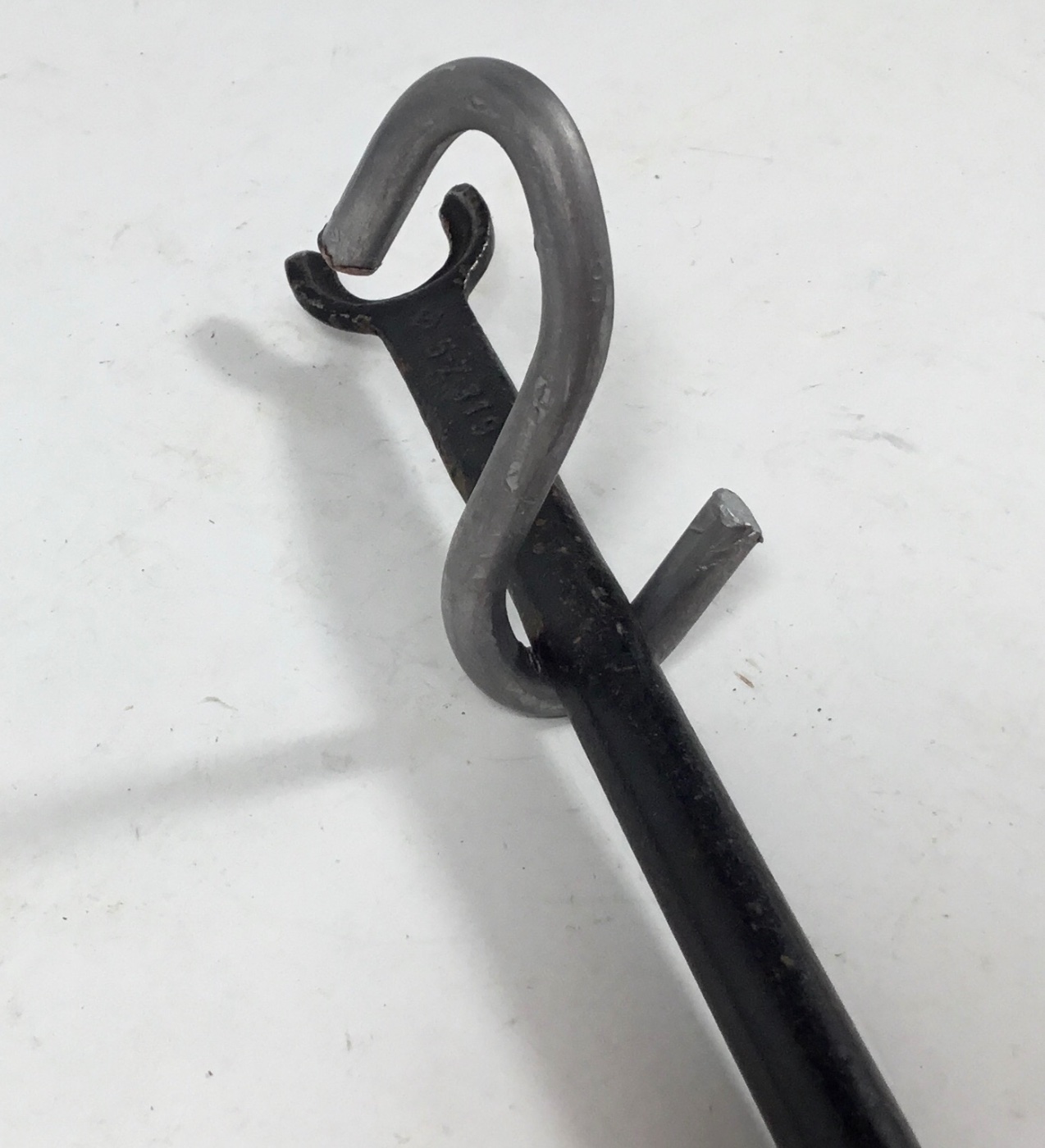

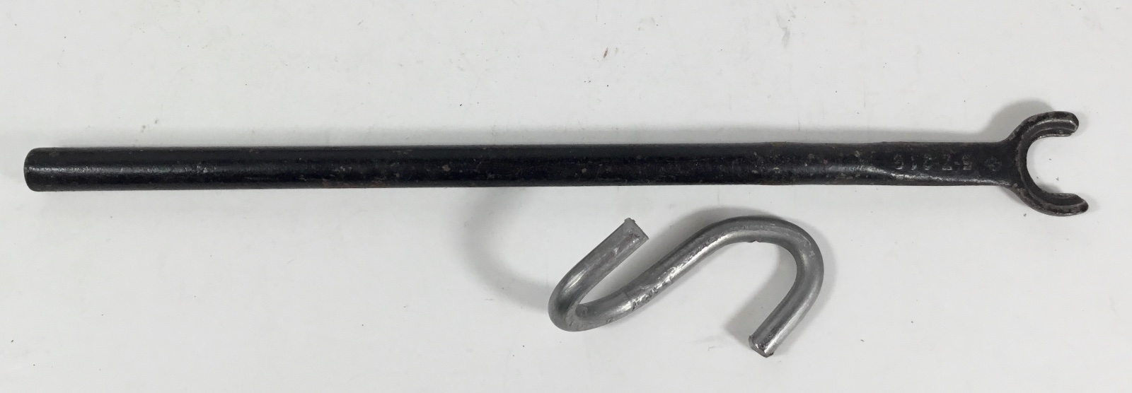

I use an original Ford script 2 part type lifter utilizing a lever action. A hook hangs from a manifold stud and a lever with a U on the end that fits under the spring. Jim Patrick

Thanks everyone for the responses. I don't think you can see it in the pictures I posted but the valves also have a number stamped on them that can be seen if I hold the light at the right angle. That must not have been good enough as they added the center punch numbering system as well. I have records from the engine being rebuilt in 1963. I do not have any receipts from anything after that.
