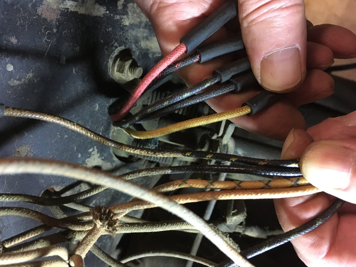

And color coding doesn't match... This is on the '26 ('27 engine). I've got a '26 version of Dyke's, which has a wiring schematic for T's. Five wires, not six. Looking for suggestions. Photo is of the old & new side by side.

Should have included: This is at the terminal block, installing from the bottom up. Thanks.

There is no red wire in the harness which goes down from the terminal block. A separate red wire goes to the magneto terminal. The red wire on the top harness goes through the firewall and is connected to the magneto terminal of the ignition switch.

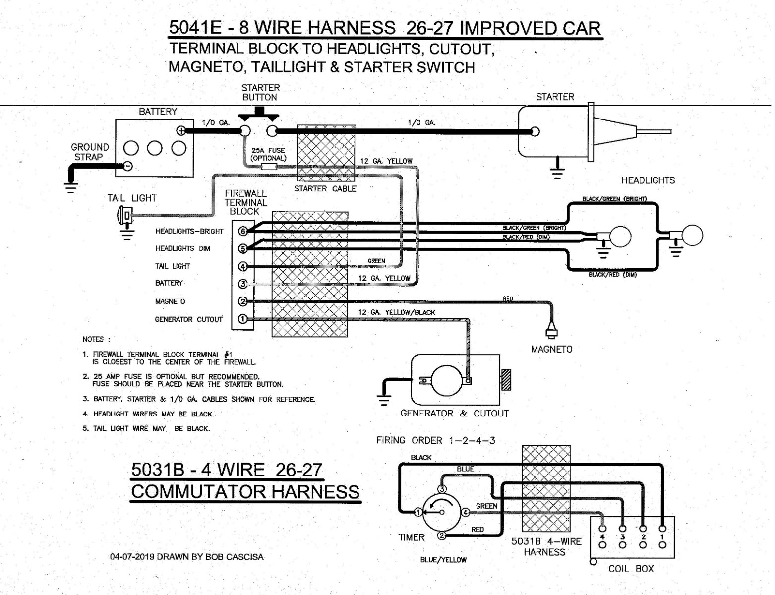

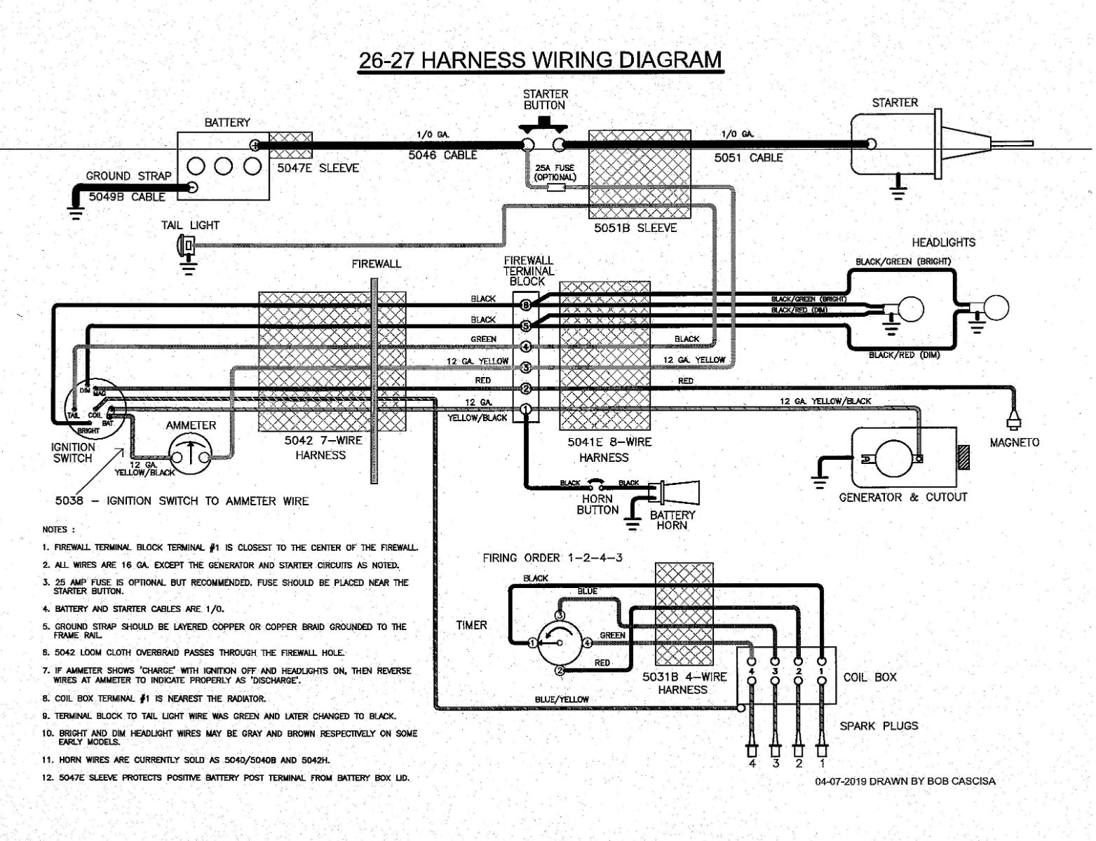

Re: Installing new wiring harness
Marv
Sorry these are not in color, but Bob C created these and they should
help you.
help you.
Marv
I would start at the ignition switch to see what wire is missing, and label the wires you do have coming from
the switch. Then you know where to attach them to the terminal block. Make sure you take the red wire from
the magneto and isolate it from the other wires. Attach that one last when you know everything else is correct.
You are missing the yellow/black stripe wire for the generator lead and the solid yellow looks too light for battery lead.
Marv, from your picture, you're installing the light harness (5041) I sent you.
Being a TT, I sent what I thought you needed. 26 TT is 25 for the most part. 5041 is what Lang's calls for for a TT, 5 wires, 19-27...26-27 car uses 5041E, 8 wires.
If you determine that you need the car harness, 5041E, let me know and I'll send you one for shipping.
Mark, the larger gauge yellow/black wire is in the commutator, 5031 harness...which Marv also has.
Hope this helps.
-Dave-
"8 wires"????? Not necessary. Still only have five connections! We're going to get a meter to read and try to follow. Besides that, it's Saturday night - MILLER TIME!!

Marv, there's no guarantee that your old wiring is original. Some of the reproduction harnesses made in the last fifty years or so used wrong colors, gauges, number of wires, etc. Royce has Bob's wiring diagram in color here: https://modeltfordfix.com/troubleshooti ... patterson/
The link you posted has better copies of all Bob's drawings. My link has text by Ron Patterson.
