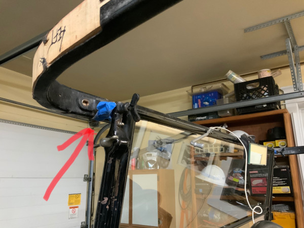

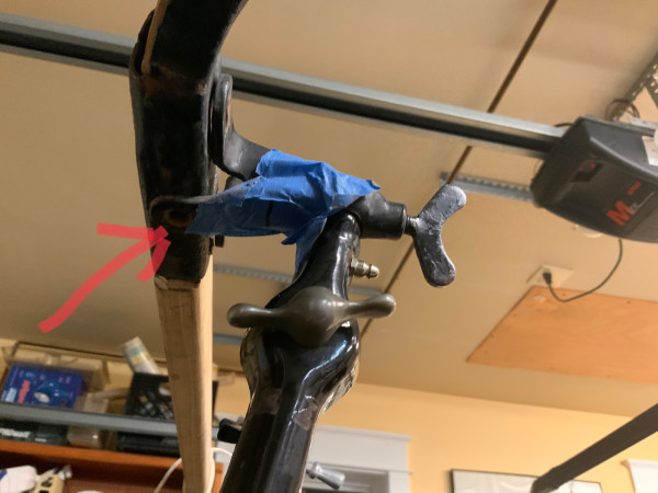

What have you guys used to attach the windshield bracket to the top iron at the bottom ledge? What I removed was a steel rivet that looked to be original. I’ve replaced all of the wood and can’t seem to find any info about this point. The horizontal attachments are carriage bolts. Peening a steel rivet is going to take heat. Not loving the idea of putting a torch right there. Hope the picture makes it…[imageImage][/image]

When I did the top on mine I removed a wood screw from there and replaced it with a new wood screw. :D

My 1924 has a slotted wood screw there. :)

An oval head wood screw**. Don't put it in until you have adjusted and are satisfied with the position of the clamps. The carriage bolt holes are slotted and adjustable, the wood screw is not. I put mine in pretty much as the very last thing I did.
**Appears that maybe the person who previously riveted, may have drilled out the hole a bit and removed the countersink for the oval head screw. You may be forced to use a round head screw.
(BTW, you would not need any heat to peen such a small rivet, if a rivet were to be used.)

Thanks guys. I screw had crossed my mind. It will get a good bite in that oak. It does still have a good countersink shape to it and, 10-4 on doing it later in the game.

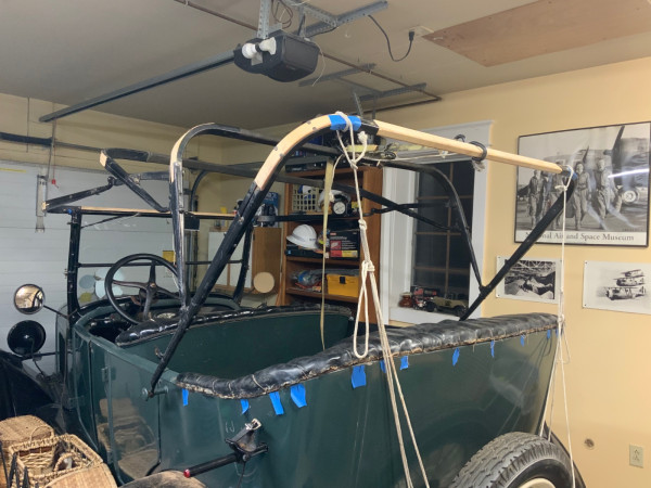

Here’s how she looked:
