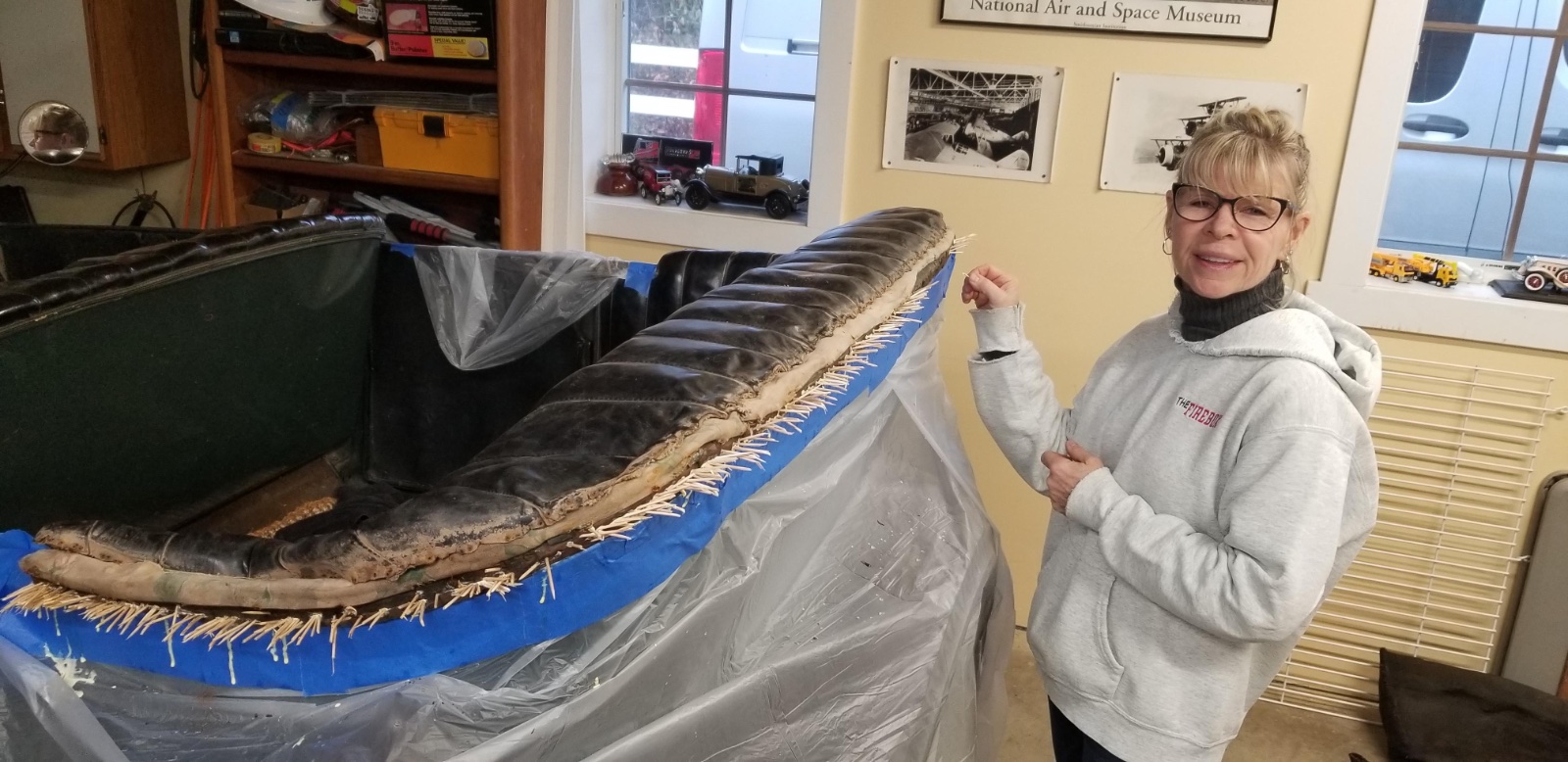

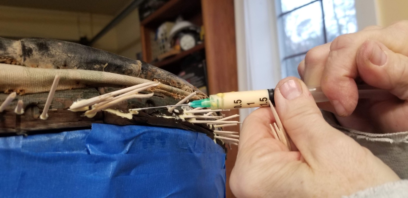

It goes pretty quick. We used a syringe filled with glue in some of the spots to get it back into the voids. Also used a spray bottle of water to dampen the wood as we went. Tape a sheet of plastic onto the body to catch any drips of glue. We broke each toothpick in half.[image]
