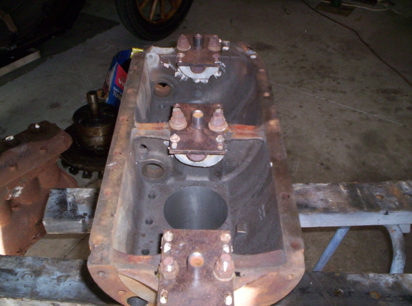

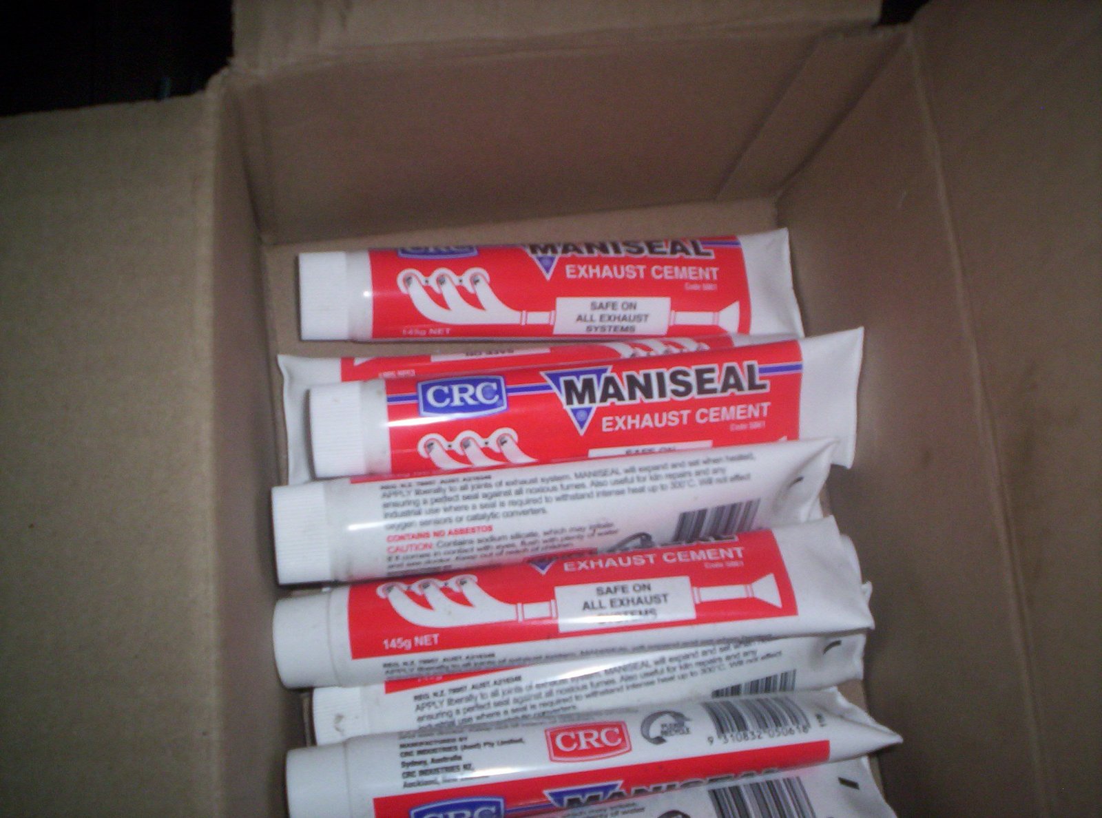

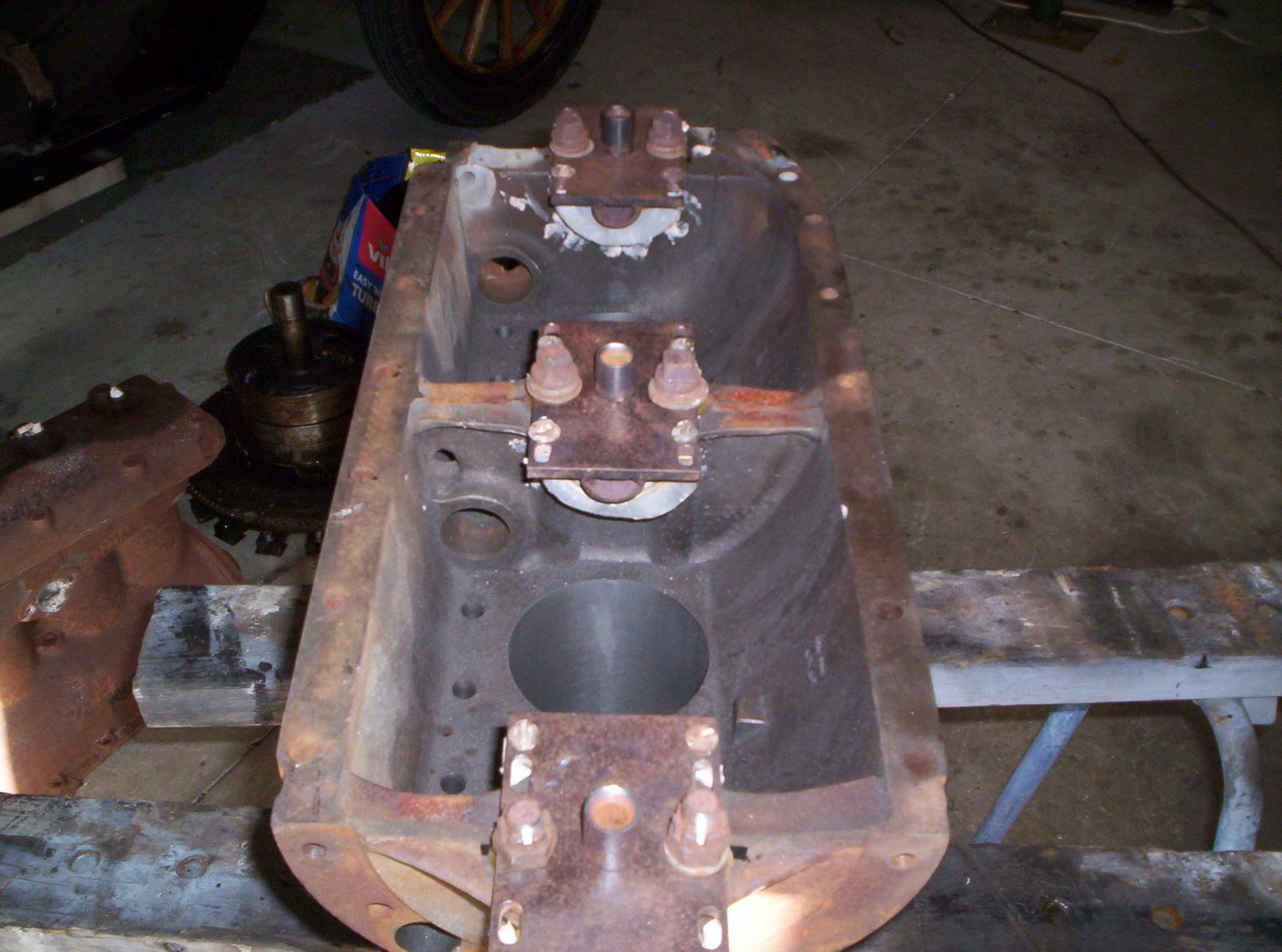

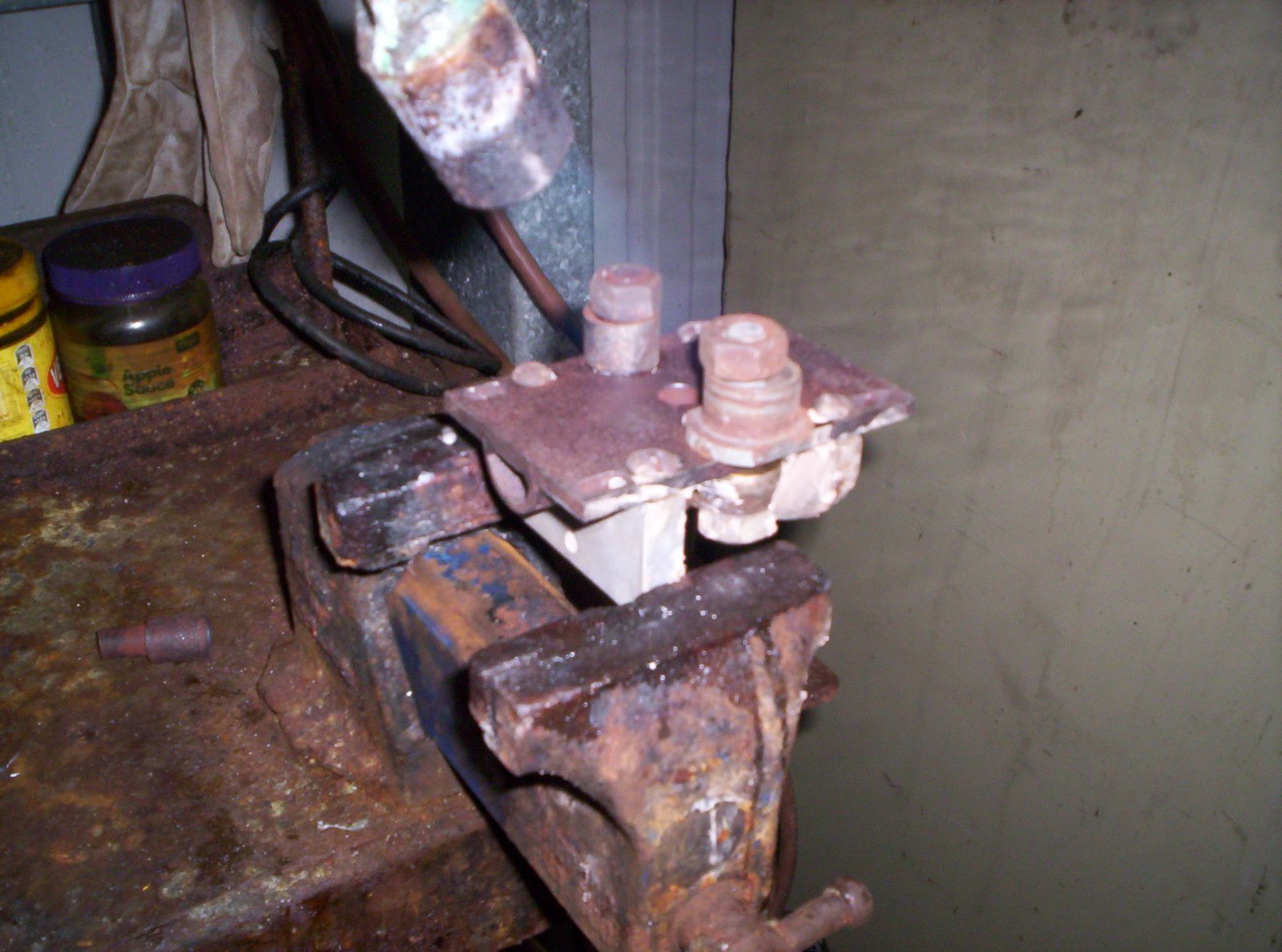

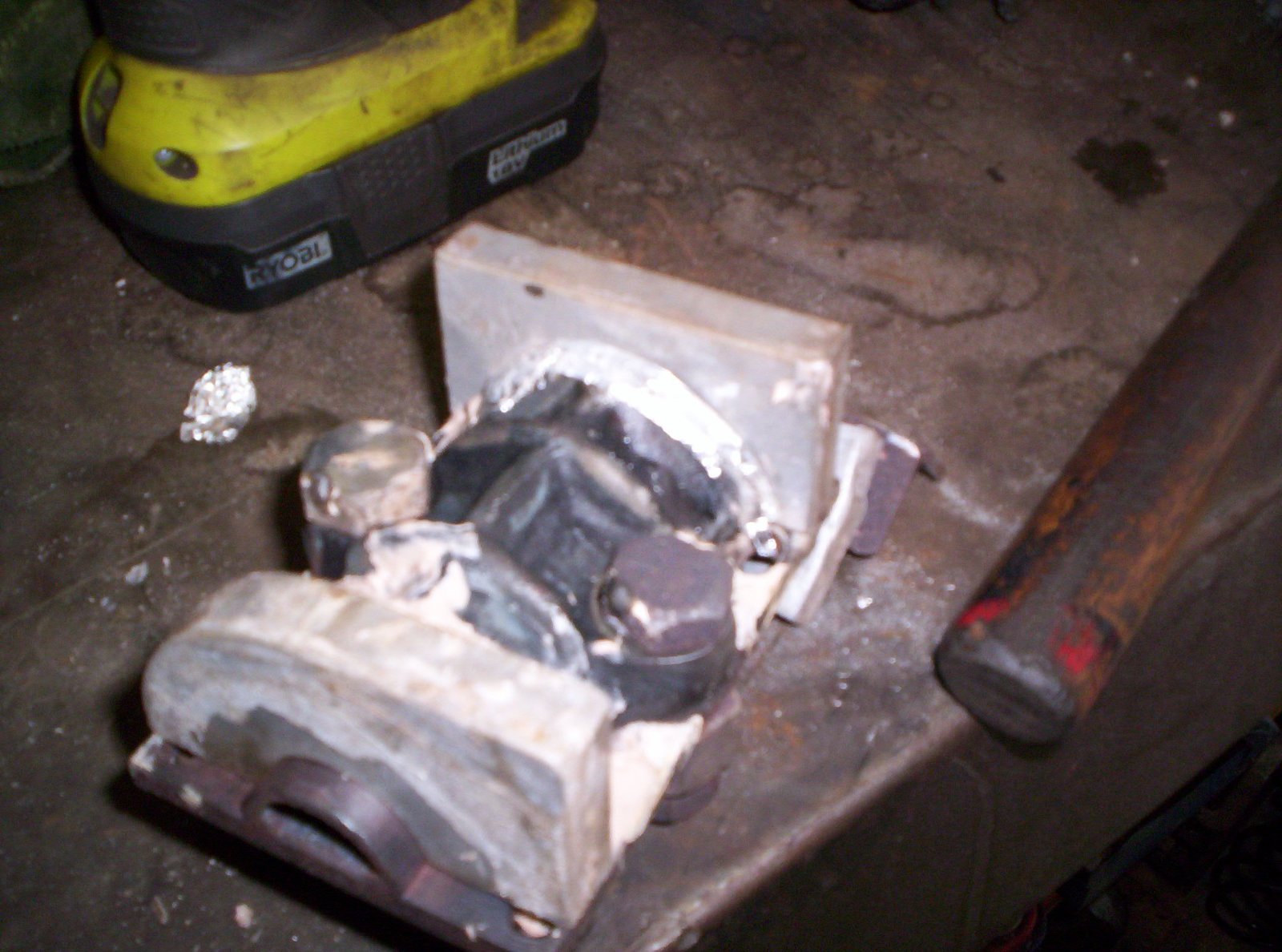

Dav
I use a high temp paste made in Newzealand by CRC, it seals hard as soon as I heat the block saddles, caps or rods with a 1" propane torch before poring babbitt.
