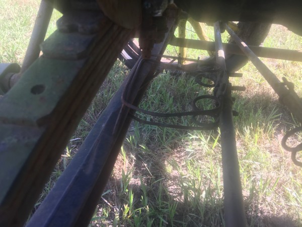

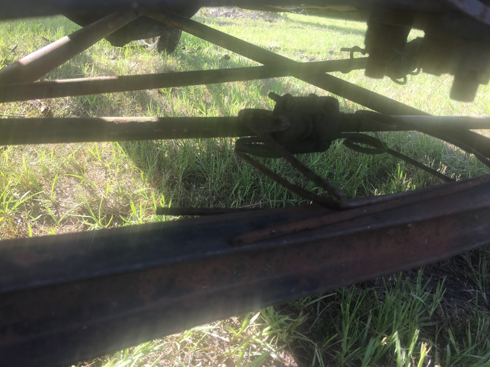

I’m getting closer to bringing home my ‘21 T project. I got a wheel on it and drug it out of the hole and tall grass it has been sitting in. I noticed a strange little contraption bolted to the tie rod. What the heck is it? Some sort of anti chatter or vibration device?

A super duper anti/rattle knock the ears off of a bunny rabbit device!
Hank in Tin-A-See
Hank in Tin-A-See
- Posts: 2051
- First Name: Jeff
- Last Name: Humble
- Location: Charlevoix, Mi
- Board Member Since: 2006
Re: What is bolted to my tie rod?

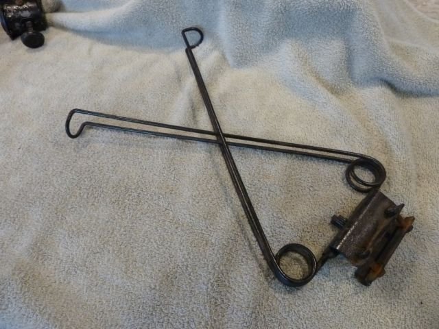

Steering stabilizer.
- Posts: 7384
An accessory Band-aid for steering problems that should be fixed.
- Posts: 6487
There were several variations of this device. Differences mostly on the ends that rubbed against the front axle
- Posts: 4693
Wheel shimmy is caused by loose parts in the steering mechanism. A quick fix is to place that device to keep it from shaking. It does not fix the underlying problem. The shimmy occurs when you go over a bump and it starts to shake. If that happens at certain speeds it causes harmonious vibrations and continues to shake. Usually it will shake until you stop the car completely. That device will not fix any worn parts, but it will stop the vibrations. It could also prevent the wheels from moving back to straight after a turn, so that you need to turn it back to center.
