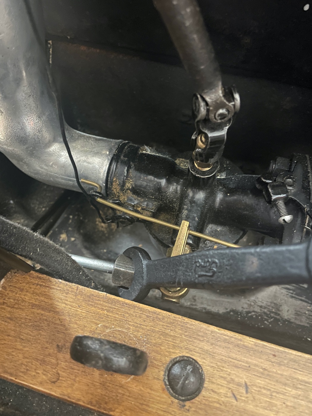

Post by Ron Patterson » Mon Dec 25, 2023 4:34 pm

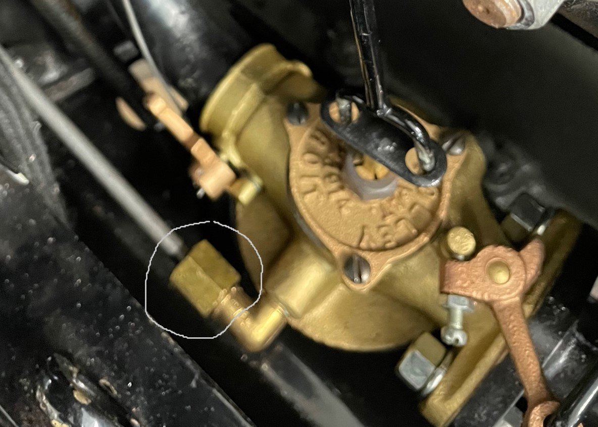

Anyone have ideas how to tighten the encircled nut.
It is 5/8 across the flats and a normal
5/8 end wrench is very ackward.

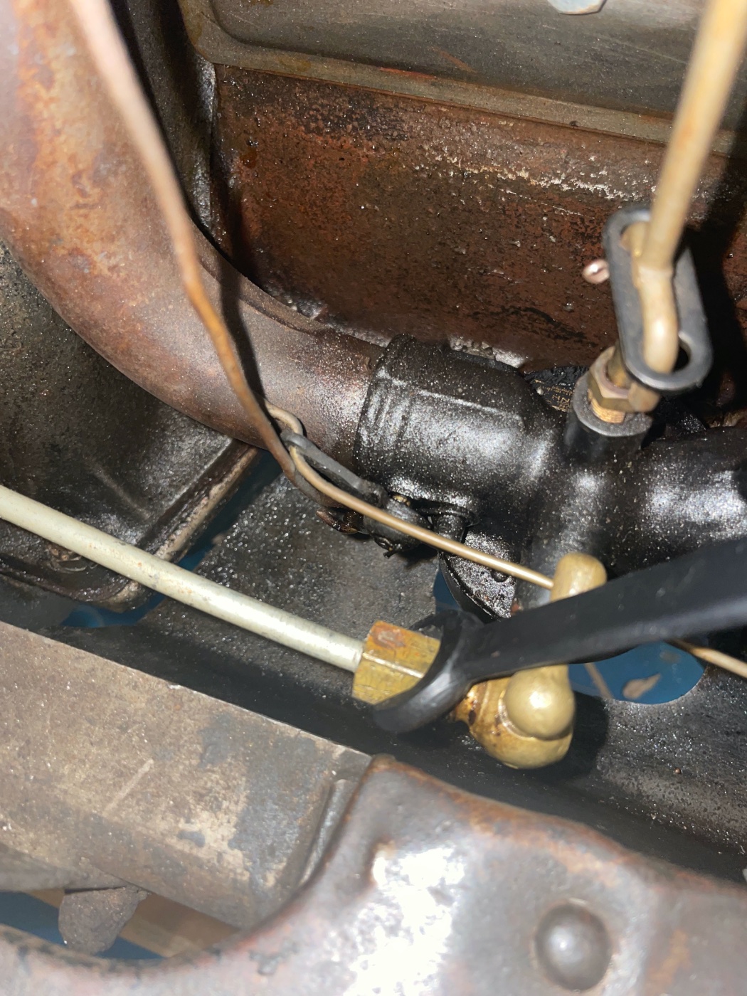

Very awkward..no room. I put a new shut off valve to the carb and used an open end wrench and had to attack it on an angle with the top of the wrench angled toward firewall. It's a slow process but worked for me.

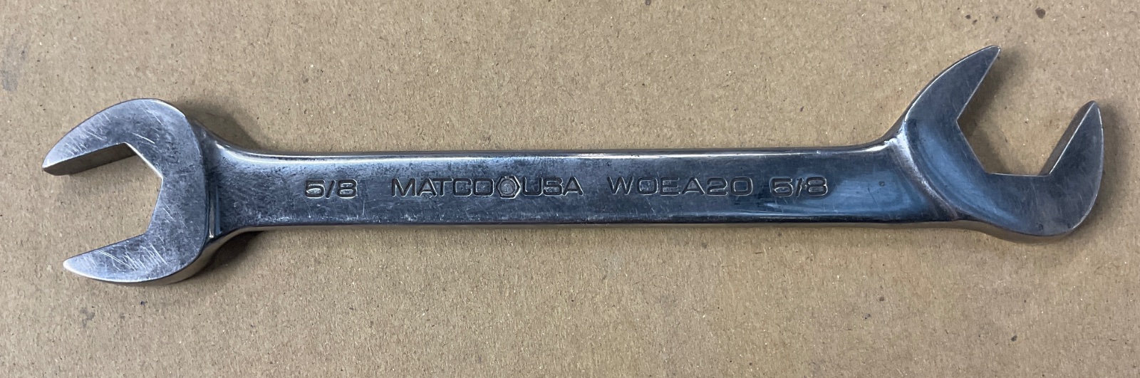

Sacrifice a 5/8” open end wrench to the bench grinder god… thats 3/4” to the left and 5/8” on the right. It’ll quickly do the job.

I have had a set of these wrenches for years.
A google search of “offset head open end wrench” will get you to several sellers

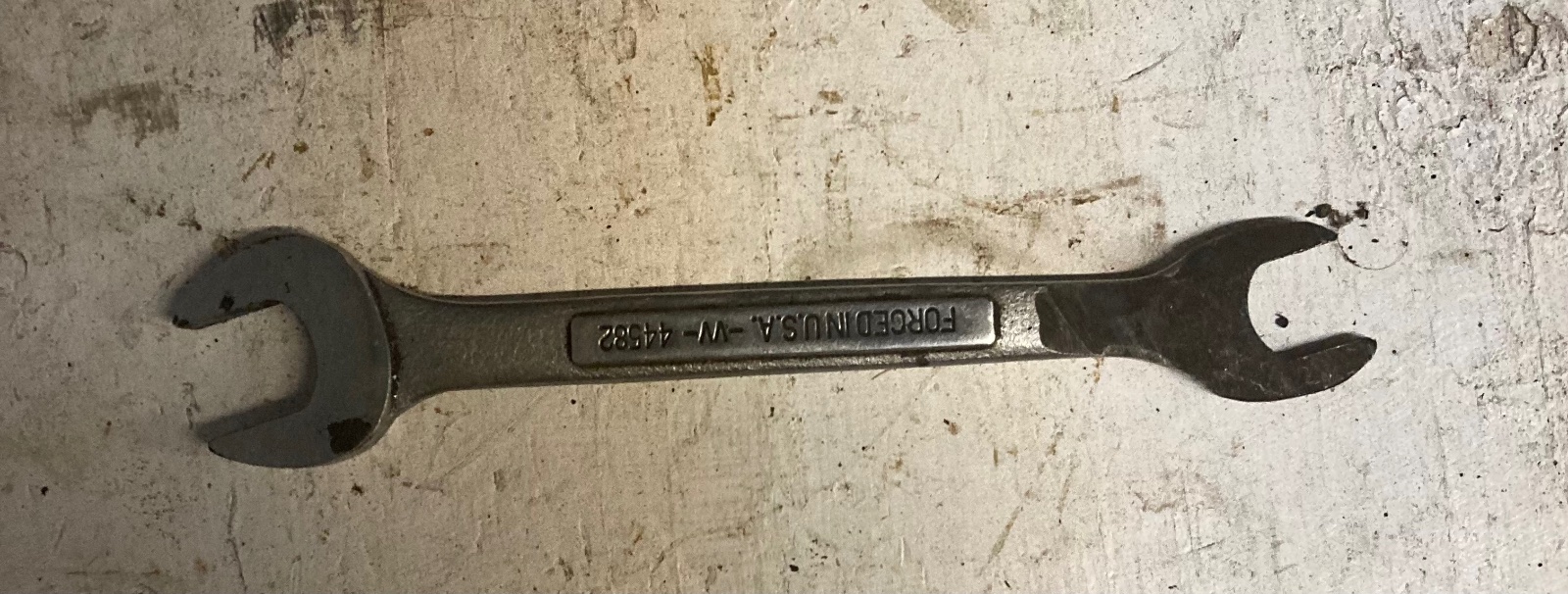

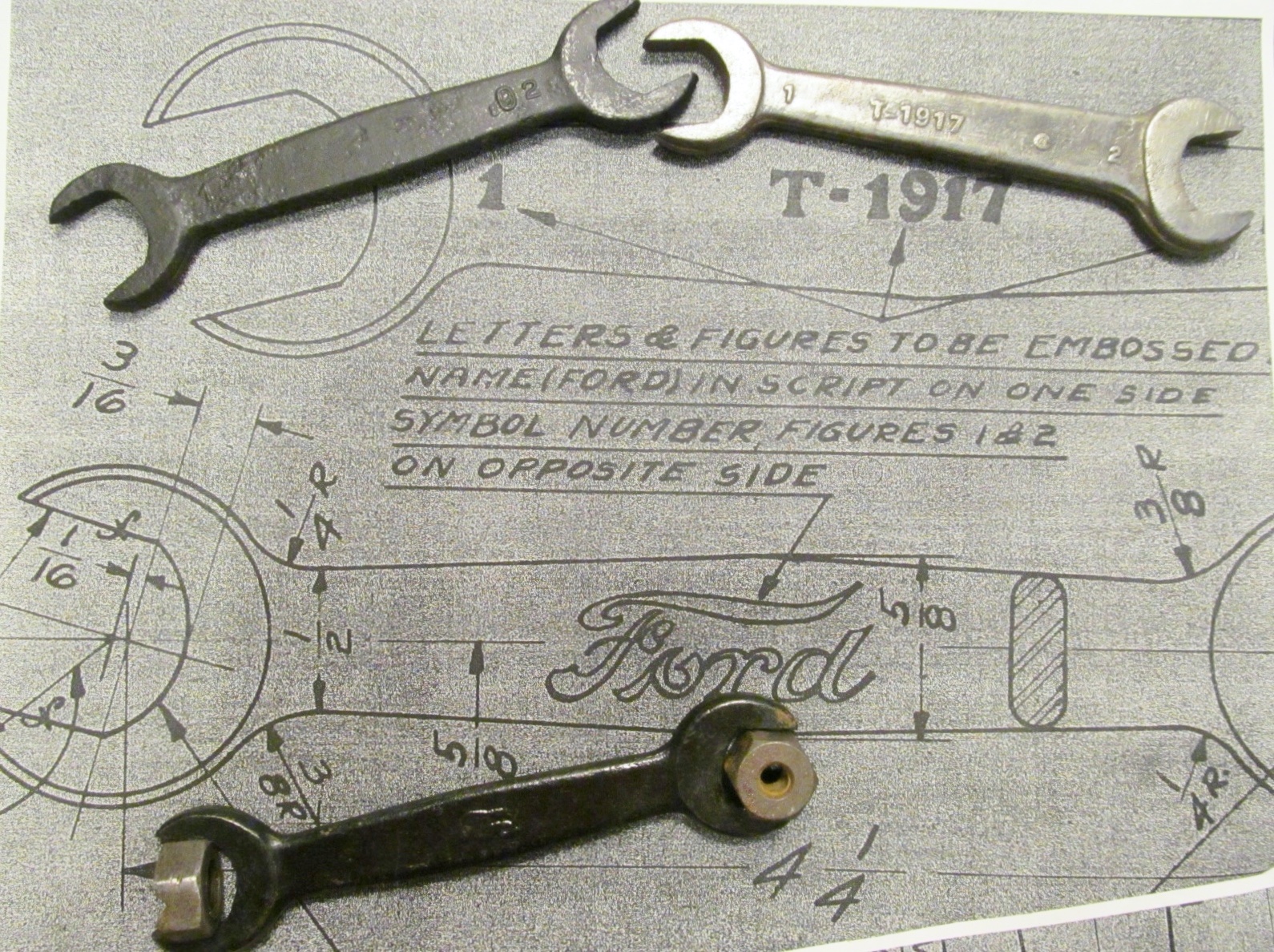

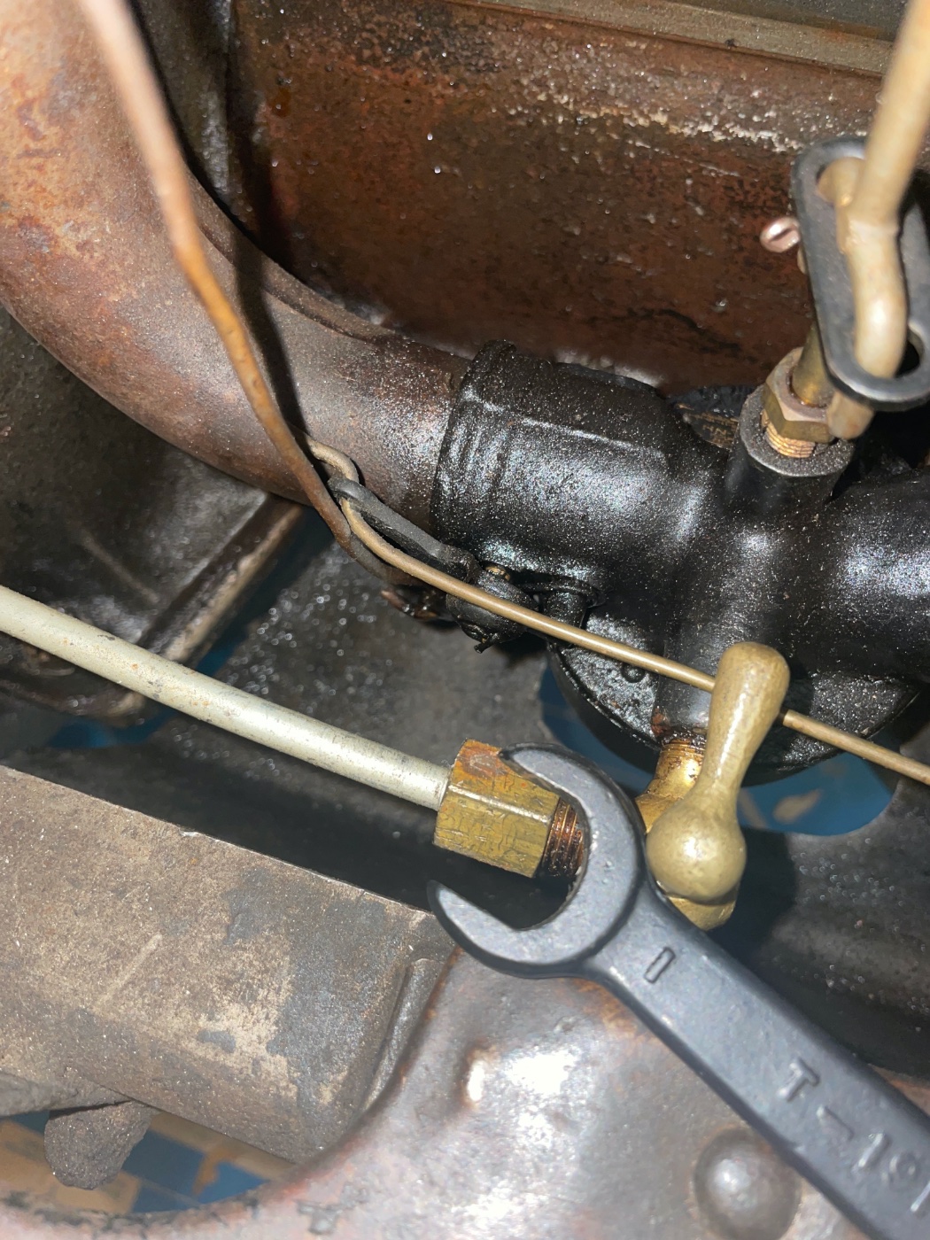

Why buy a modern wrench?
Your Ford tool kit came with the proper tool, works fine.
The 1917 Band Nut and Pack Nut Wrench. The ends of the jaws of this wrench are factory formed splayed or slightly apart, so applying the wrench also at an angle will allow the wrench jaws to easily pull up that pack nut! ;). That is also why the trans band end works too, as you approach the band nut also at an angle.

See Kerry's first response. Subsequent posts suggest the same thing, but I suspect they didn't recognise what a ring spanner is. How you guys get a box wrench out of a circle is beyond comprehension. Does it hark back to the horse and cart days when axle nous were square, like a box? ;)
Dan, I must check out using T1917. Makes perfect sense.

Was dealing with this today. Don't seem to have that wrench in my collection, so a small metric adjustable and little turns did the trick.
