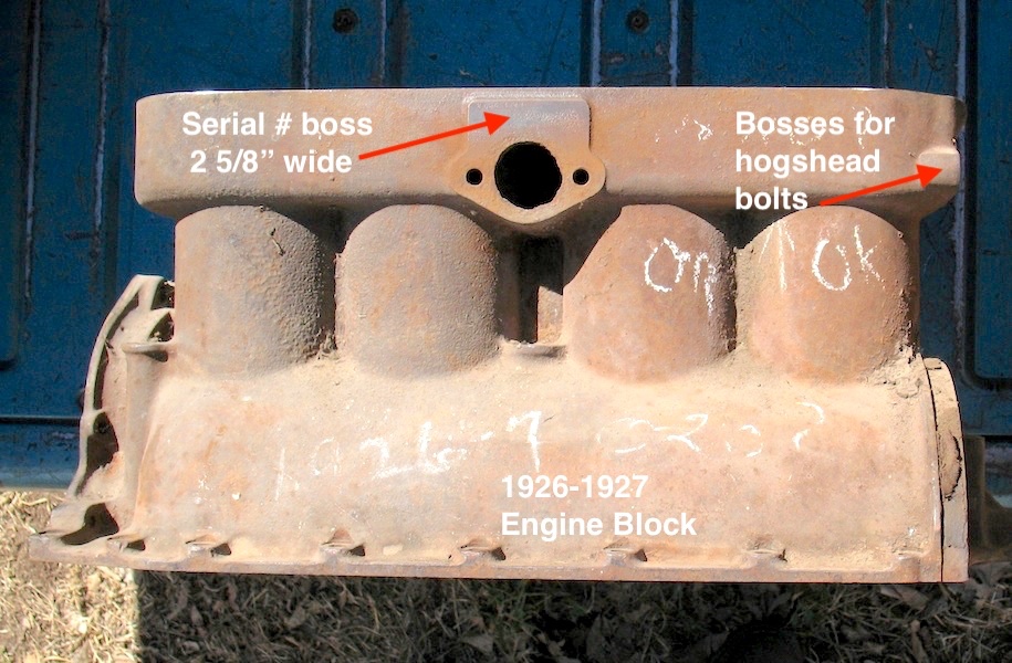

- Posts: 4042
Re: Engine Casting Mark VS Engine Serial Number
Jim
Details of the Improved Car '26-'27 block to compare to earlier blocks.
J1MGOLDEN
Topic author - Posts: 1314
- Last Name: Golden
- Location: Bowie, MD
Thanks Dan!

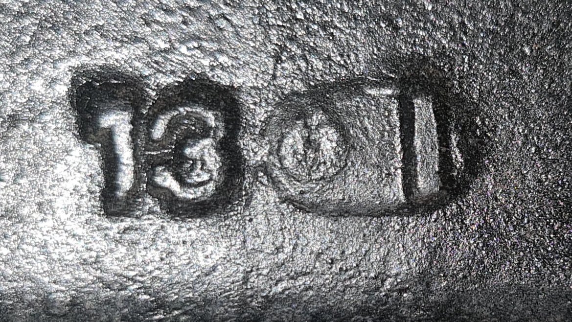

If I may join this thread with my own serial number / casting number conundrum, I'm trying to figure out the exact build date of my Model T, or at least the Engine...
My serial number is: 10114515
I've worked this out down to around 26th or 27th June 1924, using a formula I came up with.
The following is cast into the block, to the left of the serial number (there's no casting mark anywhere to the right, as seems to be common).
I'm unsure how to read / decode this one... Any ides or suggestions would be greatly appreciated.

- Posts: 4383
Repeat, repeat, repeat. Canadian cast engine blocks continued to use casting dates (in the circle) several years after USA production stopped putting casting dates on the blocks. USA production stopped putting the casting date on blocks in late 1921 or early 1922.
Mold and pattern markings continued to be put onto block castings as part of the quality control system.
Molds were used to cast the molten iron in order to manufacture blocks. Molds wore out after some number of blocks had been done. As they wore out, repairs could be made until the mold became too worn or damaged. Patterns were used to make the molds. Patterns also wore out, and were repaired numerous times until they became too worn out, at which time a "pattern maker" (high up in the hierarchy of casting professionals!)would have to make a new pattern.
After a block was cast, it was inspected. Then beginning machining was done, and then inspected again. Each and every engine block was inspected numerous times as it went through the machining and assembly process. If any flaws or mistakes were found? Action was needed to make repairs and avoid additional failures.
That is what those numbers or letters are for. To identify which mold and which pattern were used, so that the cause of the failure could be quickly found and repaired or the offending piece replaced. Those markings only had meaning for the short time between the cast and the manufacture of the completed engine. Once the engine was completed, out the door or in a car, there was seldom any need to reference the specific mold or pattern. Day to day records may not have even been kept, and none are known to exist.
Given that the identification numbers are small (a few digits at most, for identifying two different items), it is likely that identification numbers cycled around over and over again. Blocks were handled in large batches, and probably known about when casting was done, so the numbers could be used over again a month later without causing any confusion.
Minor detail changes in engine blocks required changes in the patterns as well as the molds. Existing useful patterns and molds continued to be used until they wore out (they were expensive!). Hence the crossover time when both earlier and later versions of minor changes were being used. Casting dates continued to show up on some USA engine blocks well into 1922, well after other blocks no longer had the casting dates.
Craig E. Luton
- Posts: 191
- Joined: Sun Jan 20, 2019 1:40 pm
- First Name: Craig
- Last Name: Luton
- * REQUIRED* Type and Year of Model Ts owned: 1914 Ford Runabout; 1915 Ford Touring; 1936 Ford Pick-up
- Location: Clancy Montana
That "71" was scratched into the sand mold by hand after the pattern was drawn out. I retired as a molder/core maker from a foundry after almost 30 working. We used to scratch dates into pump molds before closing the mold up for pouring.
