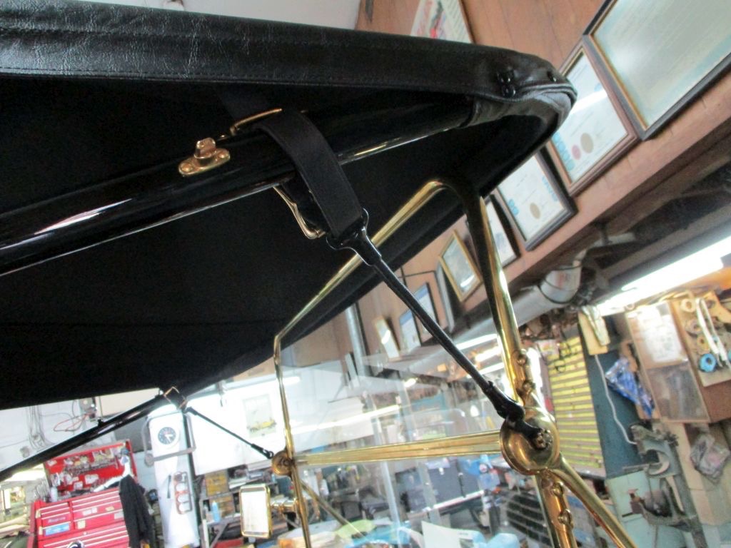

P.S. - your front retaining strap attaching points are incorrect - they should come off the front bow a bit farther up.

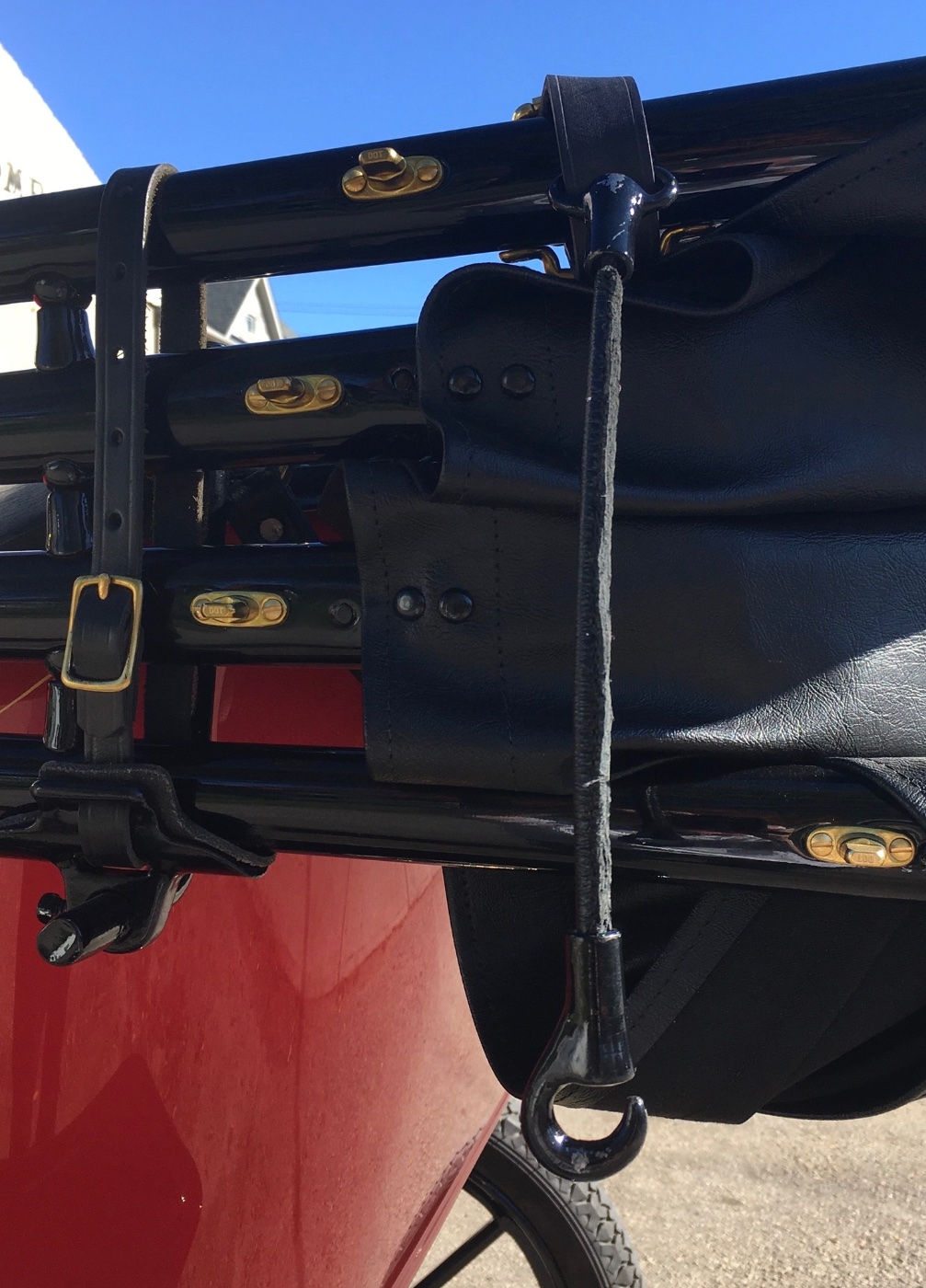

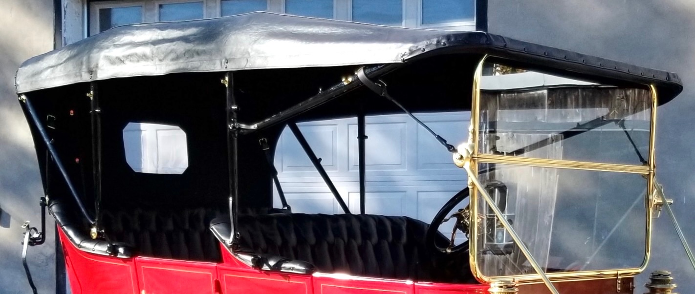

My top straps are correctly placed, unique and of a style not known by many. A footman loop holds the strap in place. They are a leather wrapped cable rather than the normal leather strap. Please see pictures below. Thank you for the method you use for lowering the top.
I’m reading a book about anti-gravity. I just can’t put it down.
- Posts: 5481
Re: Two Man Top Operating Instructions
My apologies for "assuming" ! That is an interesting arrangement - what year is your Touring ?
1912, same as the two in the pictures.
