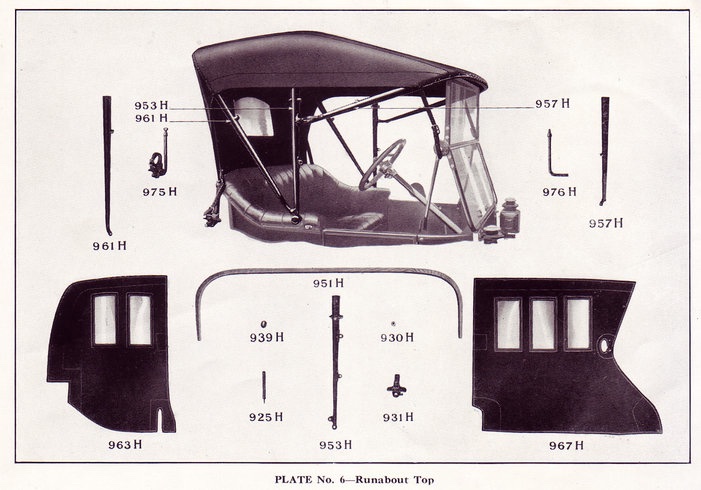

Looking for information about 1913-14 roadster tops
I am looking for dimensions for a 1913-14 ford roadster top showing how far the top bows extend above the top irons for all 3 bows and the total length, etc. I looked on the Ford website and couldn’t find anything about roadster tops. I did find the information about 1911 and 1915-17 tops. I am hoping that some of you have the information I am looking for.

- Posts: 4047
Re: Looking for information about 1913-14 roadster tops
Likely some difference in the years.Craig E. Luton wrote: ↑Thu Dec 28, 2023 9:16 pmOne more thing, are the 13/14 roadster top irons and bows the same as the 1915-22 roadsters
Here is info on the 1914 runabout top.
1914 Runabout
Top socket lengths: Front #1 22”, #2 24 ½”, Rear #3 26 ¼”
Wood bows are 47 ½” wide. Front #1 bow protrudes from socket about 7”, #2 about 8” , Rear #3 about 8”
Thank you for the information, that is what I was looking for. One more question; are the measurements you gave me for the distance above the sockets that the wood bow protrudes from socket measured from the inside (underside) or from the top of the wood bow? For an example: Front #1 bow protrudes from socket about 7”, #2 about 8” , Rear #3 about 8”, is this measurement for the top or bottom of the bow?

- Posts: 4047
Craig E. Luton wrote: ↑Fri Dec 29, 2023 2:34 pmFront #1 bow protrudes from socket about 7”, #2 about 8” , Rear #3 about 8”, is this measurement for the top or bottom of the bow?
Craig
Craig. Measures are to the TOP of the wood bows.
