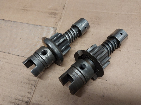

I'm also overtaking my two Bendix. I see that the gear is mounted in a different position on both. There are three options. Should the counterbalance be opposite the screws or does it not matter? What do I need to know?
Thanks for the help

Vonau wrote:
Sun Dec 31, 2023 1:15 pm
Thanks for the help
Interesting question! All but 1 of my spares have the weight away from the bolt holes when the gear is fully retracted. Of the 3 positioning options, 2 of them keep the weight away from the bolts. In my spares, either of the 2 "away" positions are what I find, (with the exception of the 1 that is aligned with the bolts). Some of my spares have been previously disassembled/reassembled, and some have not been touched.

Doesnt matter. The only important consideration is the counterweight position on the gear if moved/removed.
The spring loaded pin must ride on the top of one of the threads.
