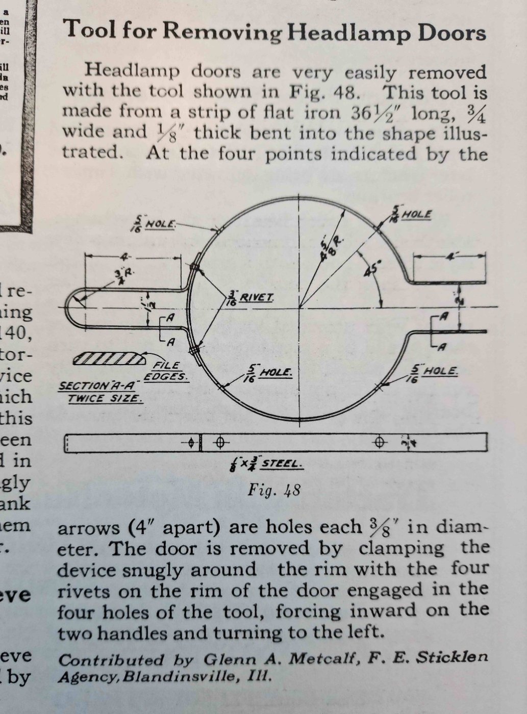

A while back I saw a post where someone had a link to the home made headlight rim removing tool (the good one), but I cannot find it now that I want to make this tool.
Could someone please guide me on this issue?

This is from the Ford Service Bulletins. Volume 2, No. 4, page 27

Link to my earlier post. It works for me.
