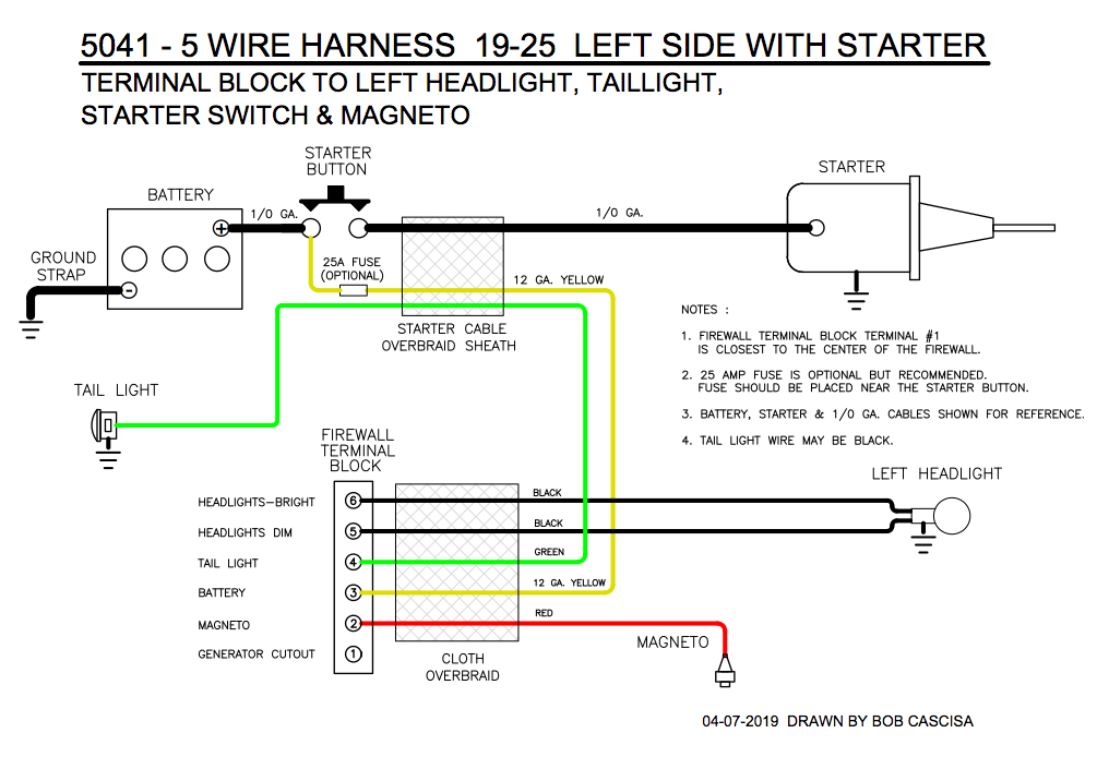

I've had this 1923 touring for eleven years and was aware that it has some of those old reproduction wiring harnesses with mostly wrong colors. But today when I started to install a fuse it dawned on me that all the wires that are supposed to be 12 gauge are actually 16 gauge. Obviously Ford used 12 gauge for a reason, but I'm enough of an electronic dummy to wonder: What is the effect of the undersized wires?

Hap, I'm going by the wiring diagrams from Ron Patterson and Bob Cascisa. They show 12 gauge for the generator, ammeter, and battery wires. That information may not be documented in Ford literature, but I expect it's based on the actual original wiring in a good many cars.
