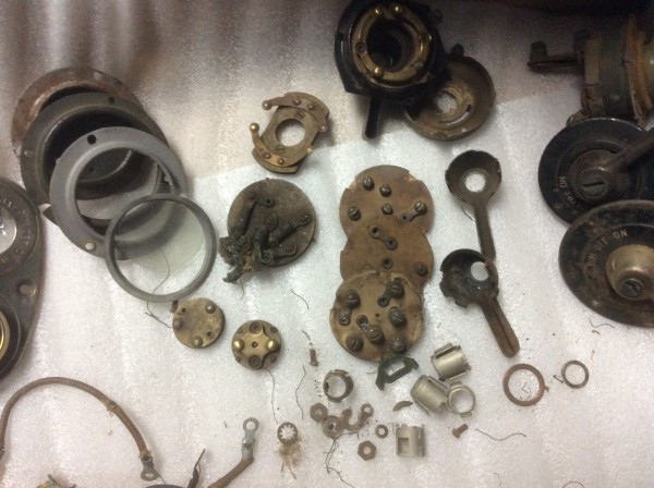

Post a photo of what you are working with maybe we can offer up some suggestions. I am trying to picture what parts you have on hand and what has come loose. Last time I checked a few months back, Langs had some of the parts. You could also check with Chaffins or Macs.

Yes, let's see what you have. Chances are it's an easy fix if all the parts are there. Many years ago I bought a new backing plate because the original one was warped. That reproduction happened to be excellent, but I won't be buying another since I found out how easy it is to fix the old ones. In the unlikely event that your switch really is too far gone, eBay may be the best remedy.

I agree with Steve. They re easy to fix. Usually one of the brass curved plates needs bent "back up" is all to engage the switch arm contact points. Takes longer to unhook all the wires than to make the repair. Only exception may be a case of extreme corrosion

Covet your original lock cylinders if they are in good shape. The reproductions are really crappy and need a lot of rework to become usable. It would help if the maker did not put the heavy crappy plating job on the tumbler as most of that needs to be machined or ground off to have any chance of working...............I’ll post a picture, as I have a pile of parts, and if something looks like it would help, I’ll send it off to you. I know the removable fiber disc with contacts come in two styles, one with brass pins around the edge, and the other with notches. Lots of different makers of these originally and not all parts interchange. In fact, most do not. Cute little truck, enjoy!

Sure but at a point the paper used to make the parts get just too warped and separated to fix. I like the pin type, but think they have the most issues. The pressure pushing up from the contacts on those 3 pins causing separation of the laminated paper substrate seems to be the biggest issue. If not too bad they can be fixed. I would suggest if doing a repair, the detentes where the contacts sit closing the circuit be deepened a little. If repairing the pin type, the pins are not evenly spaced. They are made this way so the back is properly clocked to the switch. google "mtfca; switch repair"
