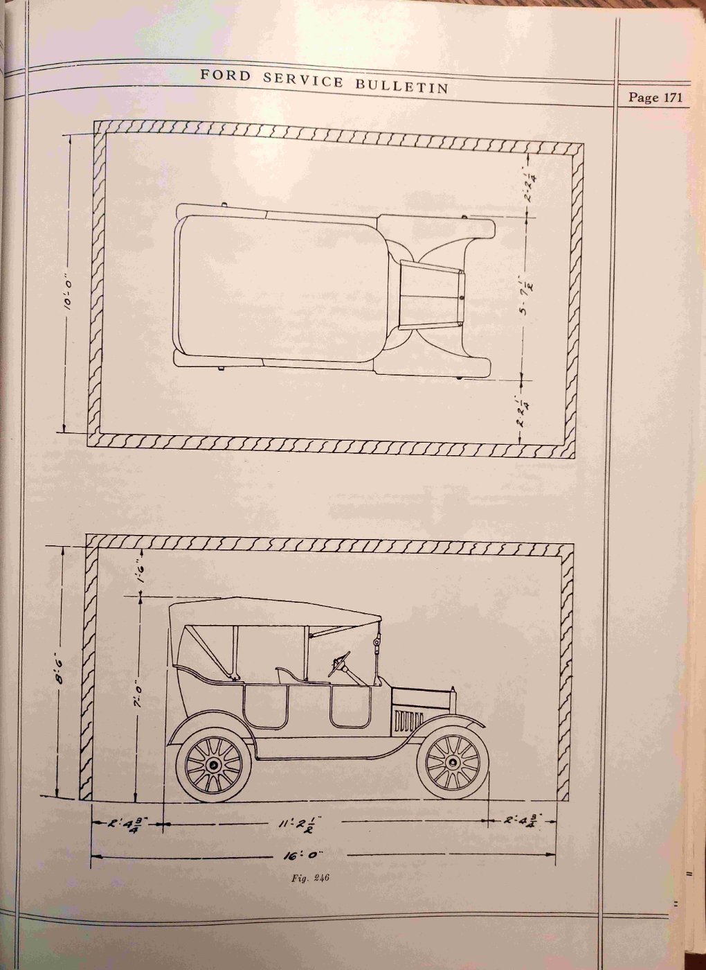

This should give you an idea of a minimum size. From the Ford Service Bulletins, Feb 1920.

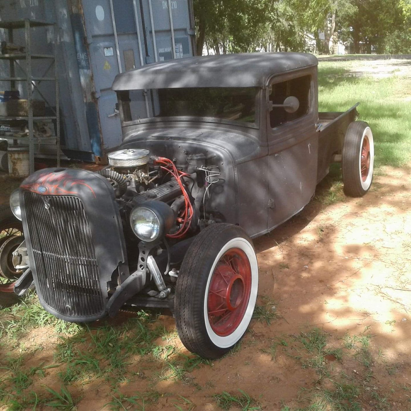

My brother had a shipping container to park his rat rod and motorcycle.
Menards sells VersaTube kits in almost any size you need. They assemble quickly and easily at a reasonable price. My dad has one that is just big enough to park his F350 flatbed. He has a crushed rock floor. I assembled one a year ago that is 40' by 14' to hold my camper. The whole building with concrete pad cost less than $16k. I assembled the frame by myself and had family members help install the tin.

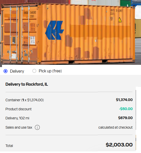

Your solution may depend on local zoning regulations. A garage/shed may require a concrete floor - also a good Idea to protect from rodents
Containers are cheap buy delivery can cost https://www.google.com/search?client=fi ... containers+
