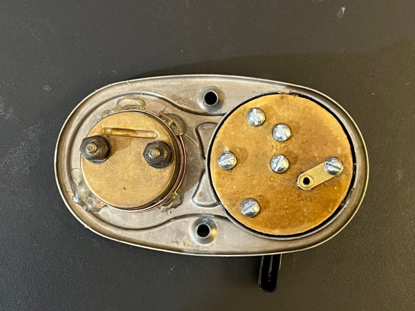

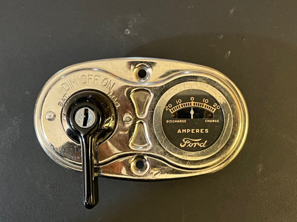

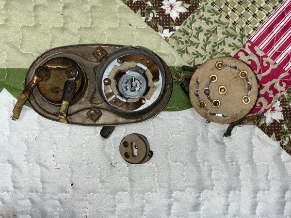

Here are photos of the restored switch.

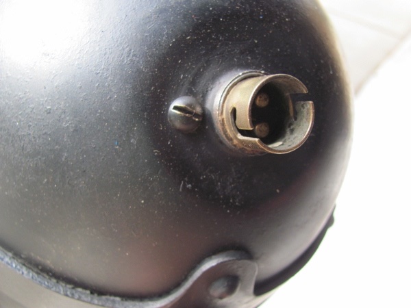

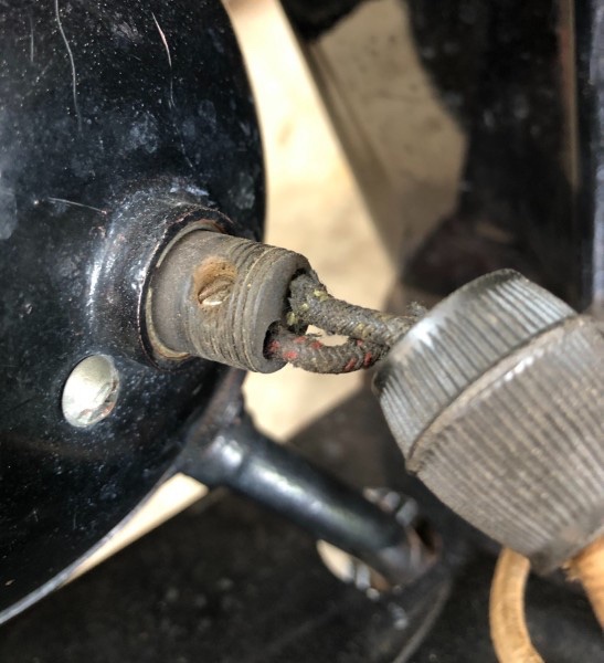

Frank's reply is the first thing to check. The bulb must have ground path from the socket cylinder that holds the bulb, that socket should be a firm fit but allow the adjusting screw on the back of the headlamp bucket to pull or push it to focus the bulb beam.

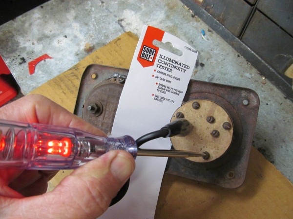

An illuminated Check lamp is handy and it has a battery powered lamp that will light up to confirm continuity. Clip on the metal socket, and then on a clean ground, like a shiny nut or bolt somewhere. That will check the socket can be grounded. If the lamp won't burn, then the socket is riding on painted surface, the headlamp bucket pad and bolts to the fender and fender bracket to frame are on painted surface. Confirm you have good ground from the socket to the frame, where the neg. (-) 6v battery is connected.
Be sure the wiring connections with the plug are engaged, and the posts on the socket are engaged with the plug contacts.

You can also check the switch to confirm it is working to switch on the lamps with that test lamp.

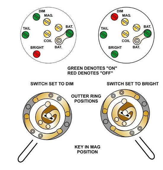

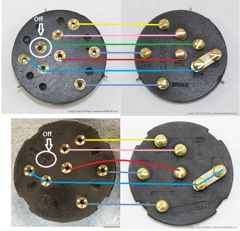

[Bruce I'll give you a call. As others my first indication for head lights not working was a grounding problem. But when you added that your tail light didn't work too I wondered about your ignition switch. I did a search on you previous postings and found this picture, I assume that you restored the switch your self.
blb t.jpg (93.71 KiB) Viewed 2055 times
So the first thing to do is to test it for continuity to rule it out as a possible cause. If it checks out then the easiest next step is checking the taillight for any grounding issues.
The tracking marks on the backing plate would indicate that the outer ring contacts heights are correct but just the same... when turning the handle to ON and DIM you should feel the contacts settling into the indent, dimple, positions (not the brass contact points). If you don't fell that then it is likely that the outer ring contacts are not making good contact with the brass positions. In this case it may be necessary (not always advised) to bend them up slightly.
A usually cause for bad contacts is a warped backing plate. The bottom surface of the backing plate needs to be relatively flat (light sand should take care of that).
The ignition switch is two switches in one. The key selects the power source for the coils/engine, while the handle selects the the lighting.
So in testing the switch when the handle is turned to one of the positions shown, there should only be continuity across any of the corresponding green locations.
Outer ring.jpg (57.53 KiB) Viewed 2075 times
