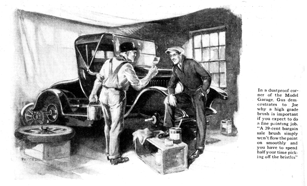

Popular Mechanics I believe it was used to run a series called Gus Wilson’s Model Garage. It started out way back in the late 1920’s as a do it yourself shade tree mechanic information series. Google Gus Wilson and it’ll pop right up check the list for some thing like Gus paints his sedan. Great tips to hand paint your car using a brush and how t was done way back when.
- Posts: 6581
Re: Any advice on brush painting a T?
And here is his story on Brush Painting https://gus-stories.org/january_1926.htmCharlie B in N.J. wrote: ↑Thu Jan 04, 2024 10:17 pmPopular Mechanics I believe it was used to run a series called Gus Wilson’s Model Garage. It started out way back in the late 1920’s as a do it yourself shade tree mechanic information series. Google Gus Wilson and it’ll pop right up check the list for some thing like Gus paints his sedan. Great tips to hand paint your car using a brush and how t was done way back when.
.... "Sure it's good paint! Didn't I mix it myself? But if you'll take a good look at this paint brush you'll see why the paint flows so smoothly. That's no 39-cent bargain sale brush made out of pig's whiskers stuck in the handle with glue. No, sir! It's pure badger hair set in rubber, and I'd hate to tell you how much money I parted with to acquire it," Gus stated with the enthusiastic pride of a good workman in a fine tool.
"So the brush makes a lot of difference, does it?" Joe asked with interest. "Why, I thought that anything with bristles in it would do. I'd have used a cheap brush that I could afford to throw away after I'd finished and save myself the trouble of cleaning it."

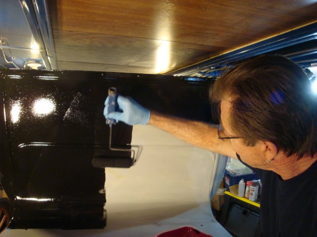

Google $50 Rustoleum Paint Job. You will find directions and examples of paint jobs made with thinned down Rustoleum paint applied with a high density foam roller, with a foam brush used to flatten out any drips and runs while the paint is still wet. (It helps if one person is using the roller and a second person is following up with the foam brush to immediately address any runs). I used this method to paint the body of my Model T, eight years ago, and I am satisfied with the results. With inflation, you will spend more than $50, but you can still get a paint job without expensive equipment.

I've done the foam roller method as shown here by Wayne Jorgenson. It works great, looks good. I've also rattle-canned multiple coats of Rustoleum Appliance Epoxy. Again, works great, looks good. It looks much more, what I would consider, original.

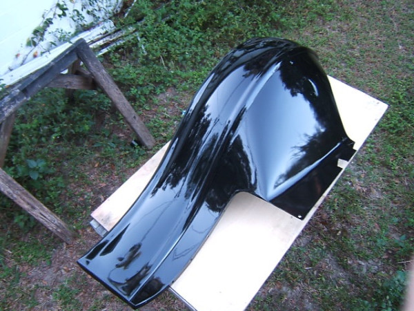

A great idea was brought up earlier to use Rustoleum Gloss Black Appliance Epoxy. It is the best rattle can spray paint on the market and, unlike a lot of black spray paint, dries to a true jet black color. Also, it can be sanded with very fine wet dry sandpaper and compounded to a mirror finish. If you do that, you will need mask off the entire car and paint small enough sections at a time to prevent overspray and drying too soon.
1. Left front fender.
2. Left front door
3. Left rear door
4. Left Running board/splash shield.
5. Left rear fender
6. Rear end
7. Right front fender
8. Right front door
9. Right rear door
10. Right running board/splash shield
11. Right rear fender
When you do each section, the rest of the car should be masked off. This paint goes on better than most and builds up nicely and bonds with itself but like any paint be careful when doing vertical surfaces to avoid runs.
Here is a fender I did using 2 cans of Rustoleum rattle can gloss black appliance epoxy. It was done in a single application. It’s sort of a sixth sense to know how much to spray on without it running. This picture was taken shortly after painting, before any followup was done. As a matter of fact, I was so happy with the way it turned out, I decided I did not need to do anymore followup work like sanding and compounding, as there were no flaws whatsoever.
The trick is to take your time in a hurry. Have enough paint on hand to do the part and shake all the cans thoroughly (at least a couple of minutes) so the next can is ready to use as soon as the first can is empty. Spray it on and keep the can moving all over the part, covering the thin overspray that will be absorbed into the paint being sprayed over it. When the part is completely covered and the final coat is smooth and free of overspray and you can see your reflection (like my fender), it is time to start thinking about stopping and letting it dry. Just one coat too many and it might start to run. If it does happen to run, it can be repaired by letting it dry thoroughly and the run sanded off and compounded, but if you can avoid the runs it will make life alot easier. If you can remove the vertical parts like the doors and lay them flat, that will decrease the possibility of runs. Be sure to mask the windows and protect the upholstery from overspray. Don’t be in a hurry. It will take a lot of time but will be well worth it.

To answer the question as to weather to use a primer if using a brush or roller for the finish coat, the answer would be to follow the recommendations of the top coat. Generally bare metal needs a primer.

If no primer, would you scuff up the base coat? I'm picturing thinned down enamel just sliding around a previously painted surface unless it's got something to bite into.
