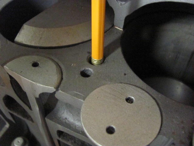

And the bolt holes in the block can vary in depth and be sure to clean to the bottom of the hole, compressed air and a pick tool helps.
The new steel head high bolts will work, the short ones are the dome head late '26-27 reproductions, one or two of the block threads may be compromised and the shorter may spin out.
The Ford head bolts only reach a short way, never to the bottom of the hole, therefore only a small amount of threads on the bolt are secured. For that reason, with old bolt threads, don't apply too much torque. Only 35-40 to 45 ft/lbs can do the job of squishing the new gasket and providing the strength to keep the head tight to prevent gasket leaks. The sequence for tightening from the center line of bolts then random out is more important.

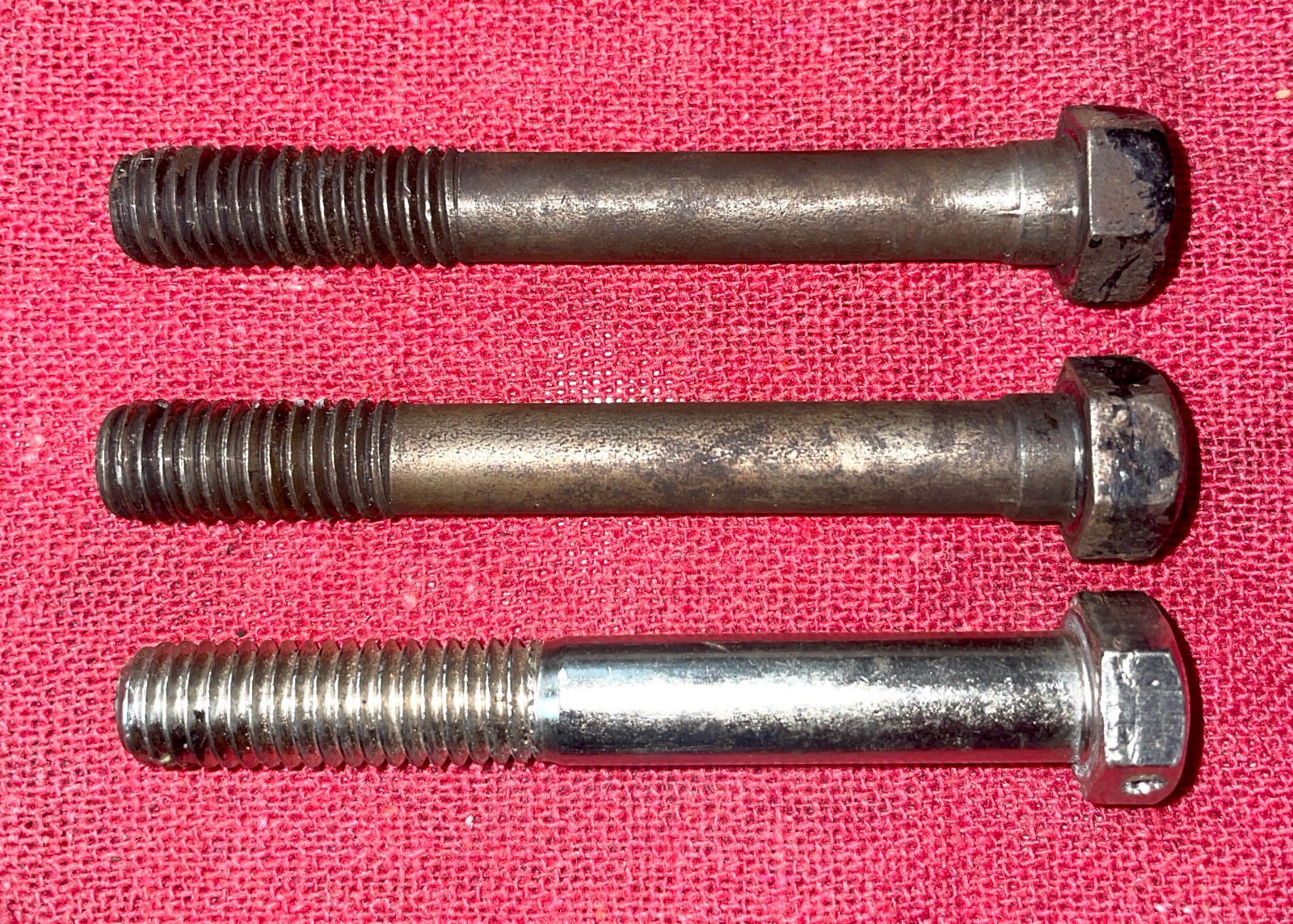

From top, early '24 to '19; center 1926-27 crown head, note thread length; bottom repro nickel (s.s) crown (dome) bolt.

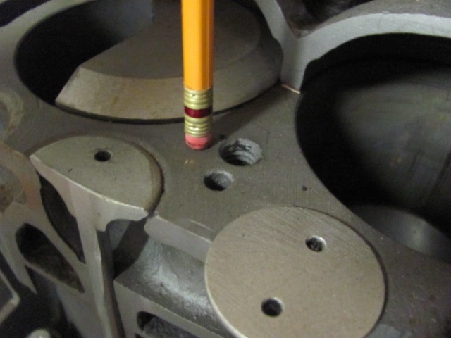

Yes, have used grade 5, plenty good. The T is rather low compression and high strength bolts and high torque is overkill. The goal is to prevent gasket blowout or leaks. Straight fresh block and head surfaces help the most. And a light smear of anti-seize on the bolt threads is good practice to keep from busting off a head bolt that has been there for a while ;) Surprising how much crud slips around and down the bolt, and gets to the threads. Have noticed plenty when removing a head after a few years for carbon scraping the piston tops :D
Repaired the spinning reproduction dome head bolt with a hardware version, on the hole by the plug. That hole had a few bad threads right where the short reproduction threads were. Sure the proper repair would be Heli-Coil. But why pull the head to just fix one hole, when a tad longer bolt would work too ;). So made a long shaft bottom tap brazed to an extension, for reaching down thru the cylinder head and deep into the block hole for cleaning the threads for the new tad longer bolt.

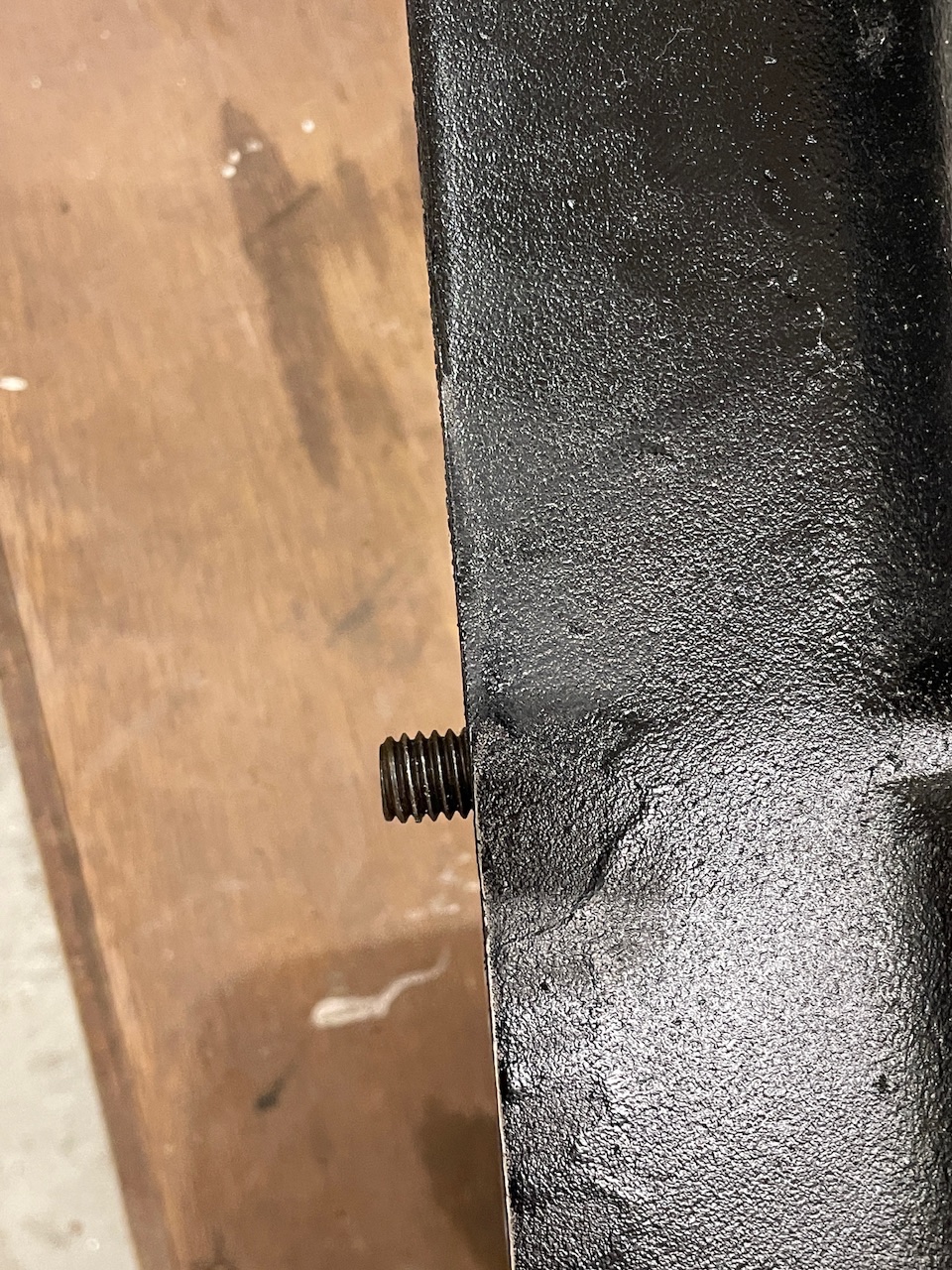

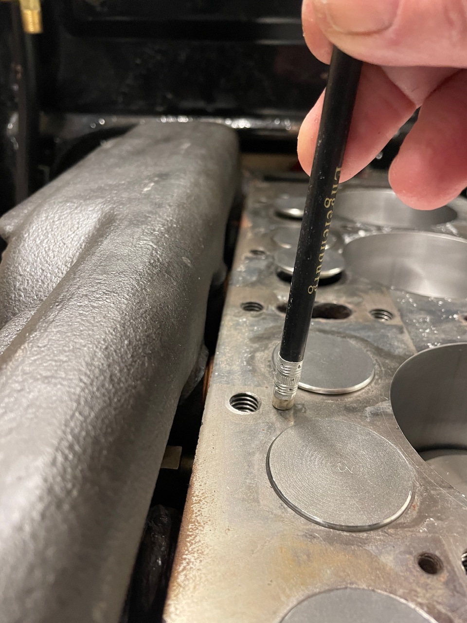

Post by Lexveen » Fri Dec 29, 2023 2:46 am

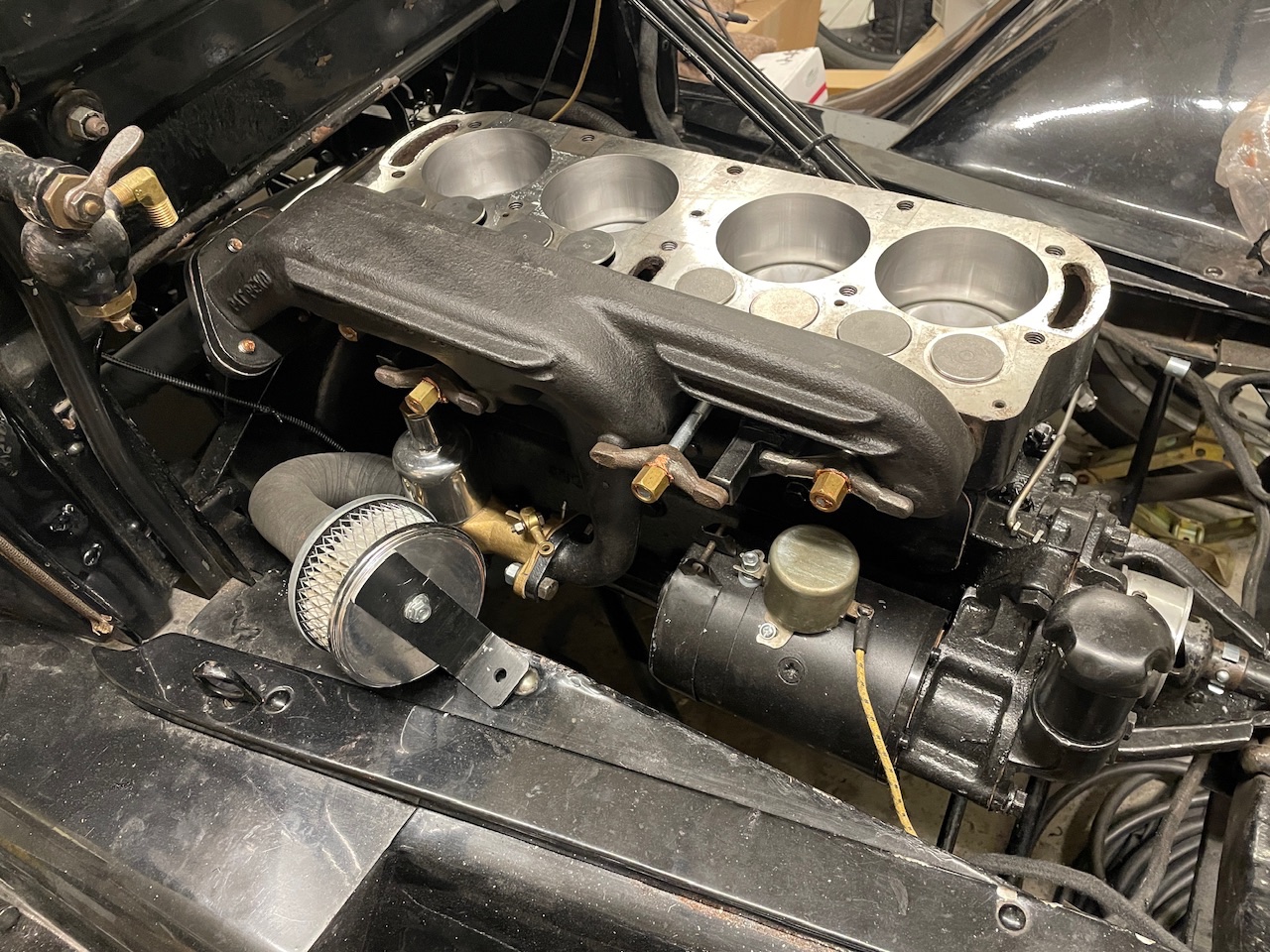

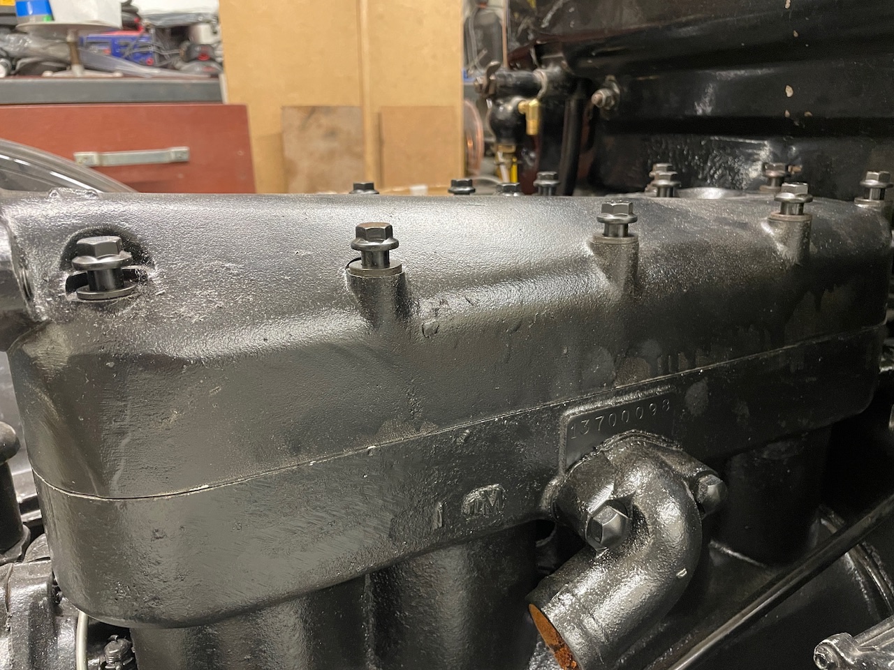

Some pictures.
The one with the protruding thread is without washer, head gasket and coilbox. It will never be more then that.

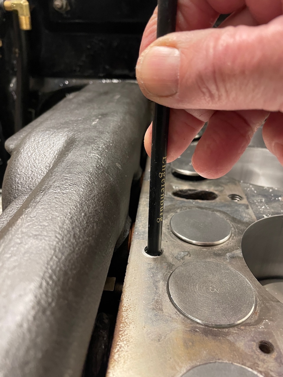

Post by Lexveen » Sat Jan 06, 2024 9:51 am
Just what I did. They all go in 5/8 by hand till they bottom out. I shorten the bolts so they just don’t bottom out without the head gasket.
