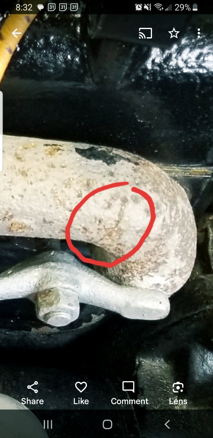

Are the new manifolds in the Langs catalog any good? I noticed that mine has a vertical crack. I haven't started it yet to know if it leaks or not. Just trying I figure my next steps and if I buy new or source a used one here on the forum.

Vincent, your crack comes under the "If it don't leak, don't fix it" category. I'd leave it alone as long as it stays OK. There does not seem to be leakage so far.

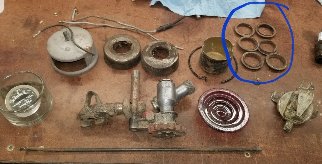

Depends a lot on how warped it is. If the glands are not in place, it will warp. Especially if run too lean or too retarded so that the manifold gets red hot. It will sag most often between 3 and 4 because all the exhaust from all cylinders goes through that area and the weight of the exhaust pipe is also on it. They will stay straight if all 4 glands are in place, but at least the 4th one and the first on should be in place. I have had very good results with the replacements from the vendors.

Was running when parked so I'm hoping all is well.
Guessing that the picture below are the glands you speak of so they were possibly replaced at some point.
I picked up a new battery yesterday so my hopes are that I'll get it started tomorrow.
