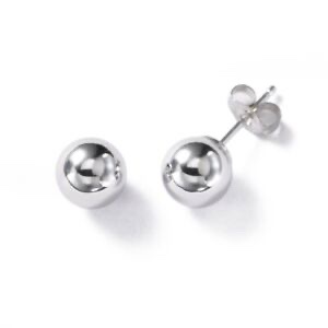

Is 1/4” O.D or I.D. In the jewelry department, they have cheap ladies earrings with a stud attached to a small hollow metal ball. It could be brass, copper or plated steel. Find an earring with a diameter matching the ID of your tube, cut off the stud and you have a nice hollow metal ball to use as a float. Jim Patrick

Jim nice tip!

Jim,
Thanks for the suggestion. i will look for a brass or other hollow ball. It has worked for years and now decided to leak. This ball will make it easier to read.
Nick
