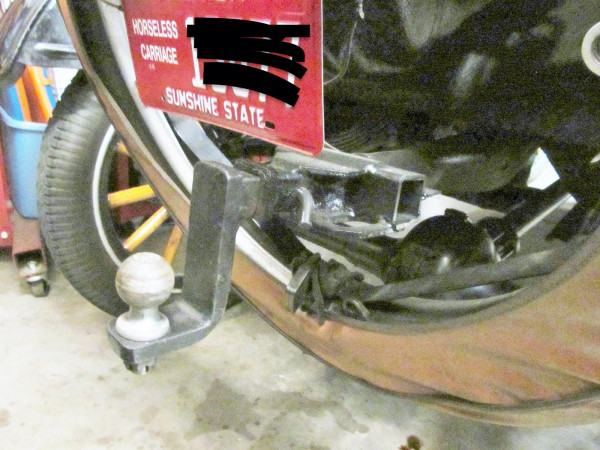

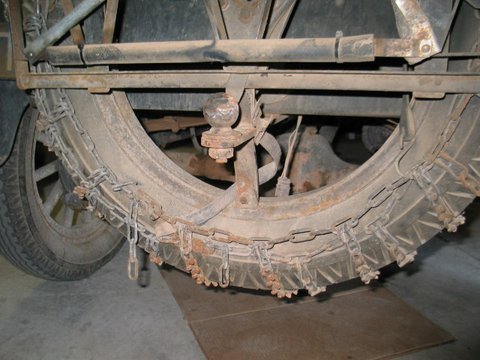

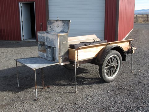

Donnie, I have two 26's with trailer hitches, a touring and roadster (both with wood wheels). The touring has a receiver tube welded into the spare tire goose and reinforced mounting at the upper spring mount. I have a ball receiver and a cargo carrier that mounts there as well. I have only towed a trail with it a couple of time and haven't weighed it but it worked good. I will try and attach pictures of the hitches and the trailer.

Dennis. Thanks for the input and photos. I like how simple it works with wood wheels. With wire wheels I can not go thru the spare. I also like your trailer. We are going to pull a tent camping trailer with ours.

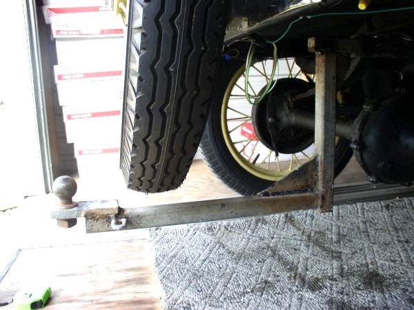

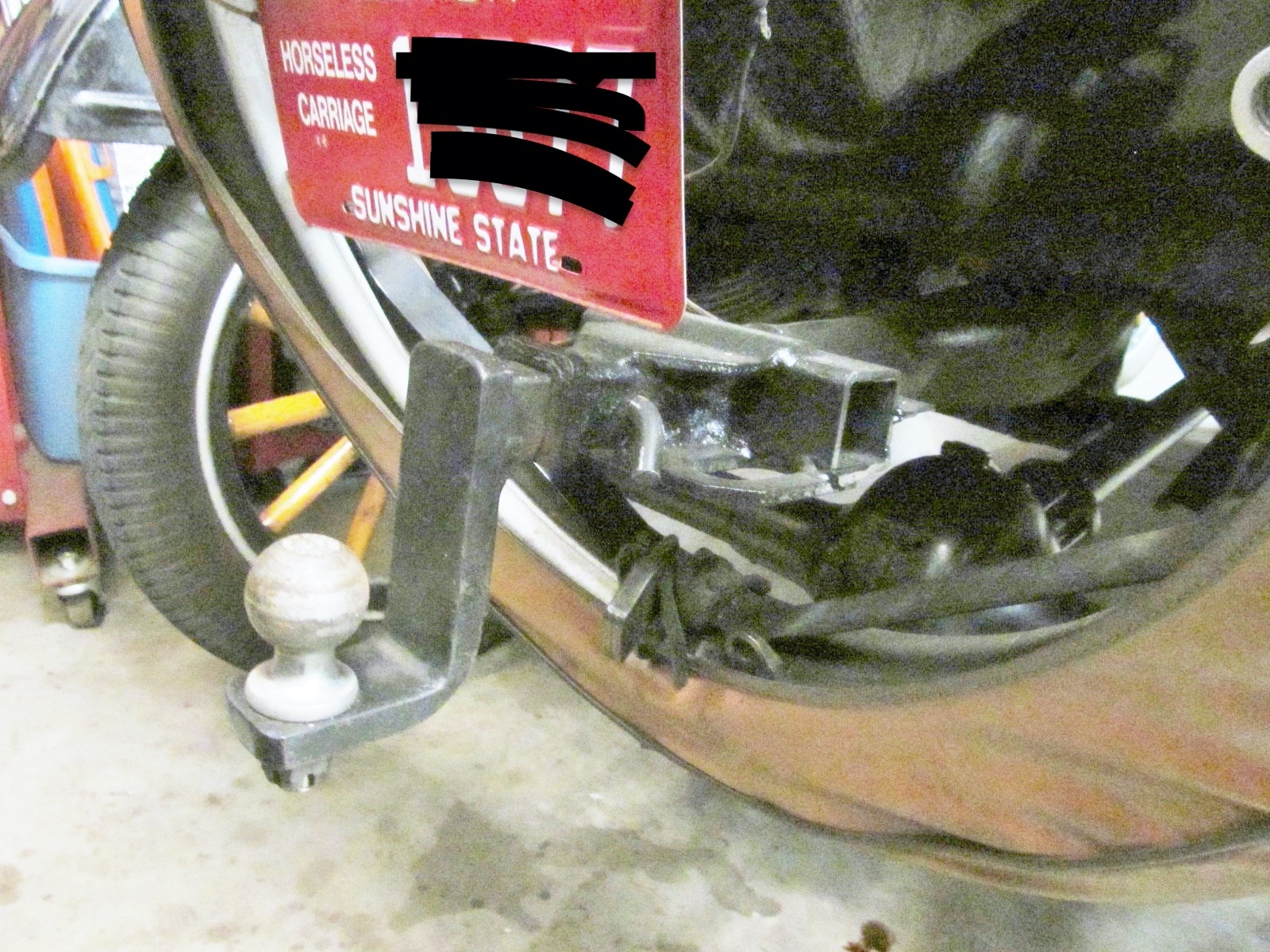

Donnie

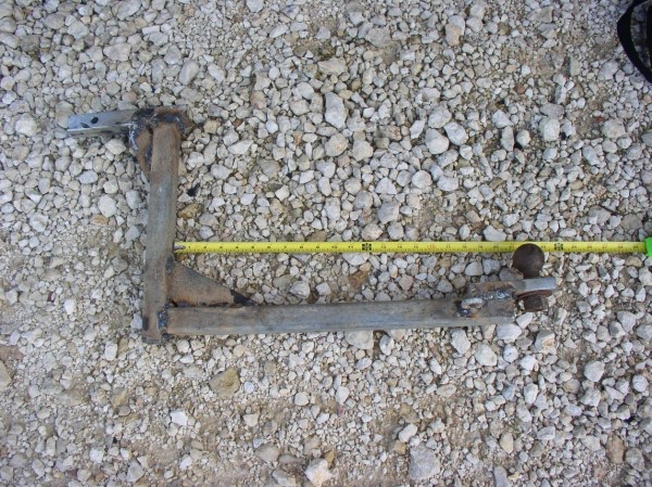

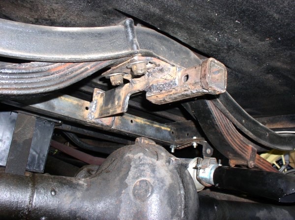

Someone posted these pics on the forum a while back. Chassis shows T wire wheels, and the part frame and part spring hanger mount uses a long bar to go under the wire wheel spare.
Seems like one way to do it. The trailer gross weight will have to be calculated to do engineering of the mount, long bar, gussets, and the wall thickness and size of sq.tubing.
Short receiver to spring hanger and added frame tubing fastened across the frame behind the crossmenber.
Long drop bar from receiver to clear the mounted rear wheel.
Detail of drop bar with hitch ball.

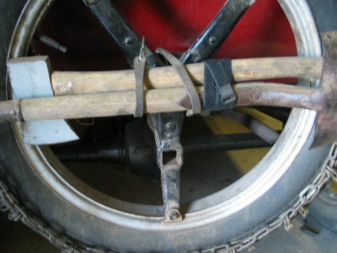

My '25 touring uses a stubbed off 26-27 gooseneck, with receiver welded on, passes of course thru the spare tire on clincher rim.
