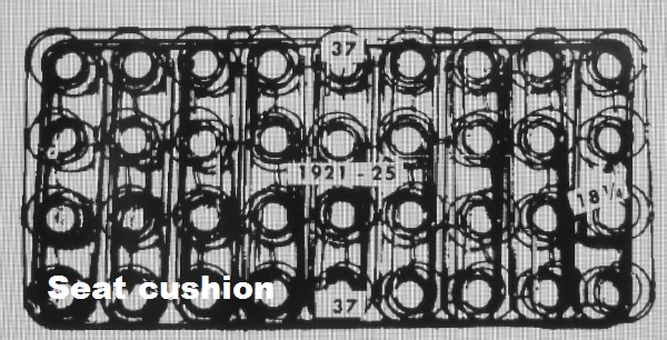

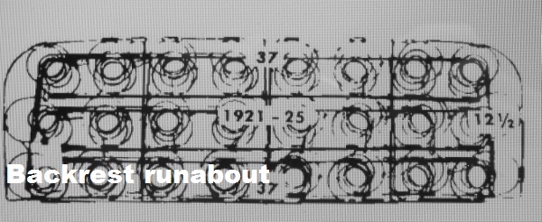

If open car, have a couple of pics like this, don't have dimensions of closed car. What year and open car body style and which seat or backrest spring are you needing?
