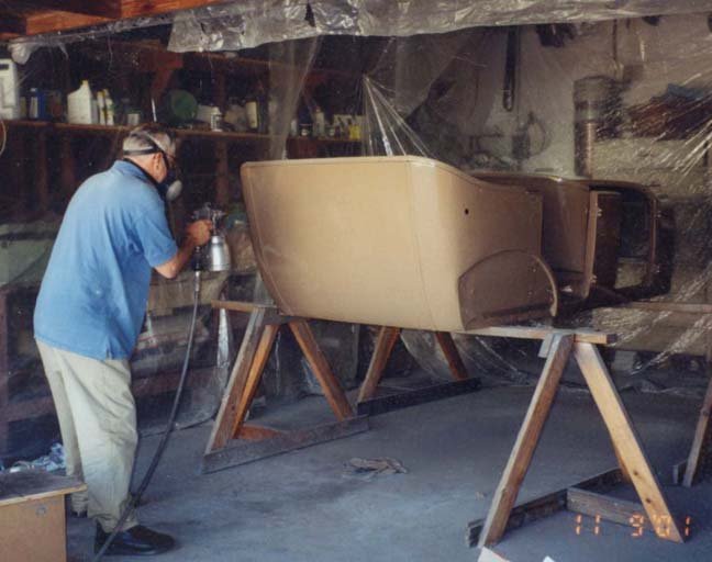

Here is a picture of stands I made for my 26 when I was working on it. This picture shows me painting the car. I could also get under and paint the underside of the body. If you turn the body around, you can back the chassis right under the body. Then two men can can lower one end of the body onto the chassis then the other end.
