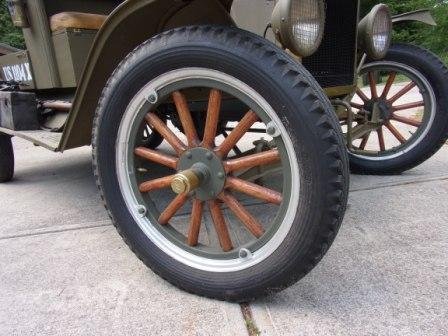

Re: Will motorcycle tubes work in T tires? Static display.
This is waht I did on my 1915 War Wagon tires and wheels. Used the 2" rubber valve stem but covered them up with a brass rifle bullet casing cut off at the bottom. Selected one that fit the threaded part of the valve stem perfectly and the cap kep everything in place. Will probably go this route again but not paint the rims galvanized or aluminum but keep everything OD green. The ambulance will be a lighter yellow shade of lusterless OD green and I am leaning towards painting the wheels a darker shade of an OD gloss or semi gloss green just to break up the shades. In reality, no color standards for the military in WWI and parts supplied from various vendors would all be slightly different in shade.
