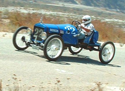

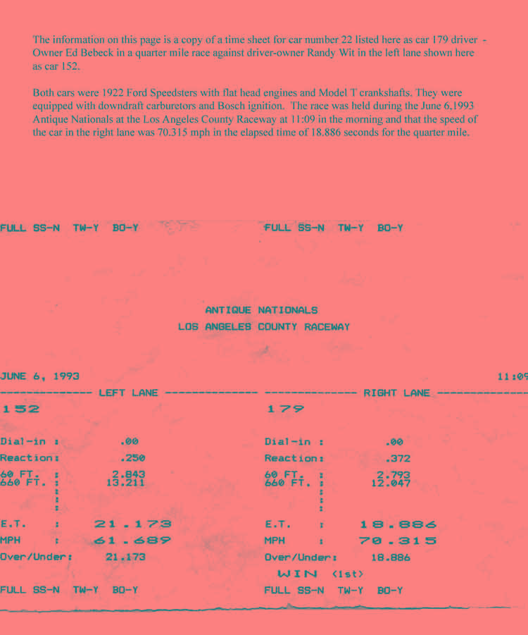

Jon Codman: Because some of us go 70 or more and we used beads
Frank at Speed on the Hill at Devore.jpg (54.73 KiB) Viewed 11165 times

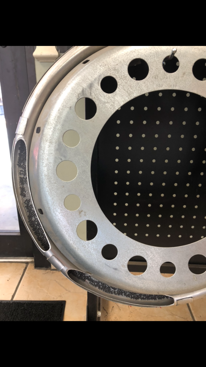

I was at a tire shop for big trucks and saw this display. I was talking to the man behind the counter about it and beads in Model T tires (I’ve never tried them) and he said that NASCAR uses powder to balance their tires.
