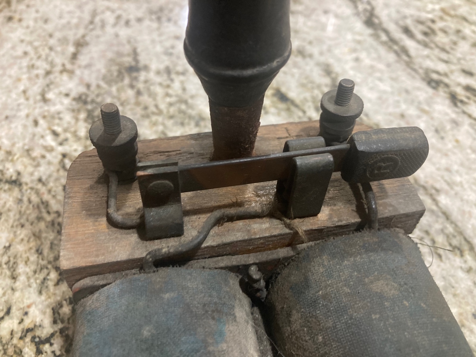

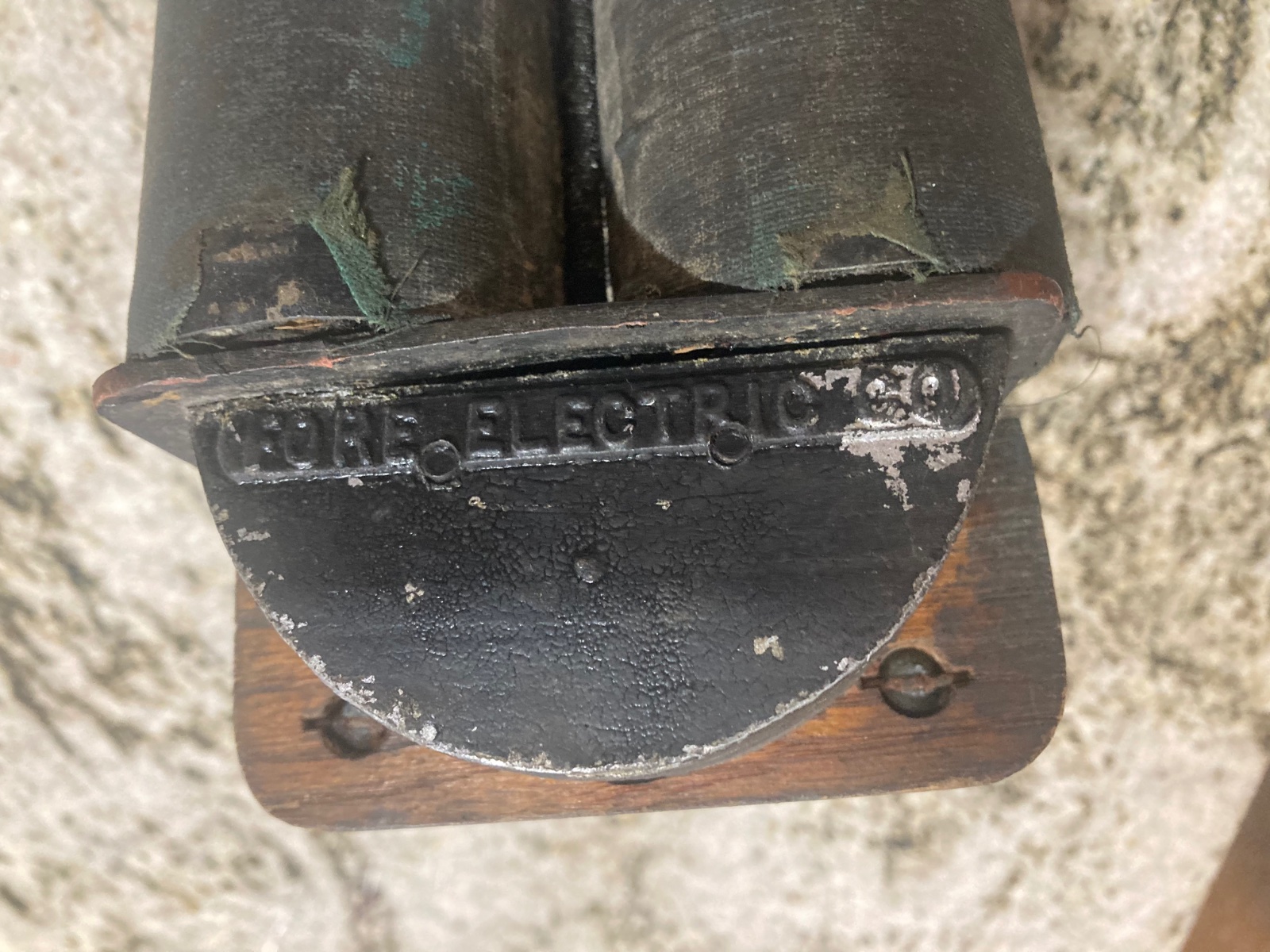

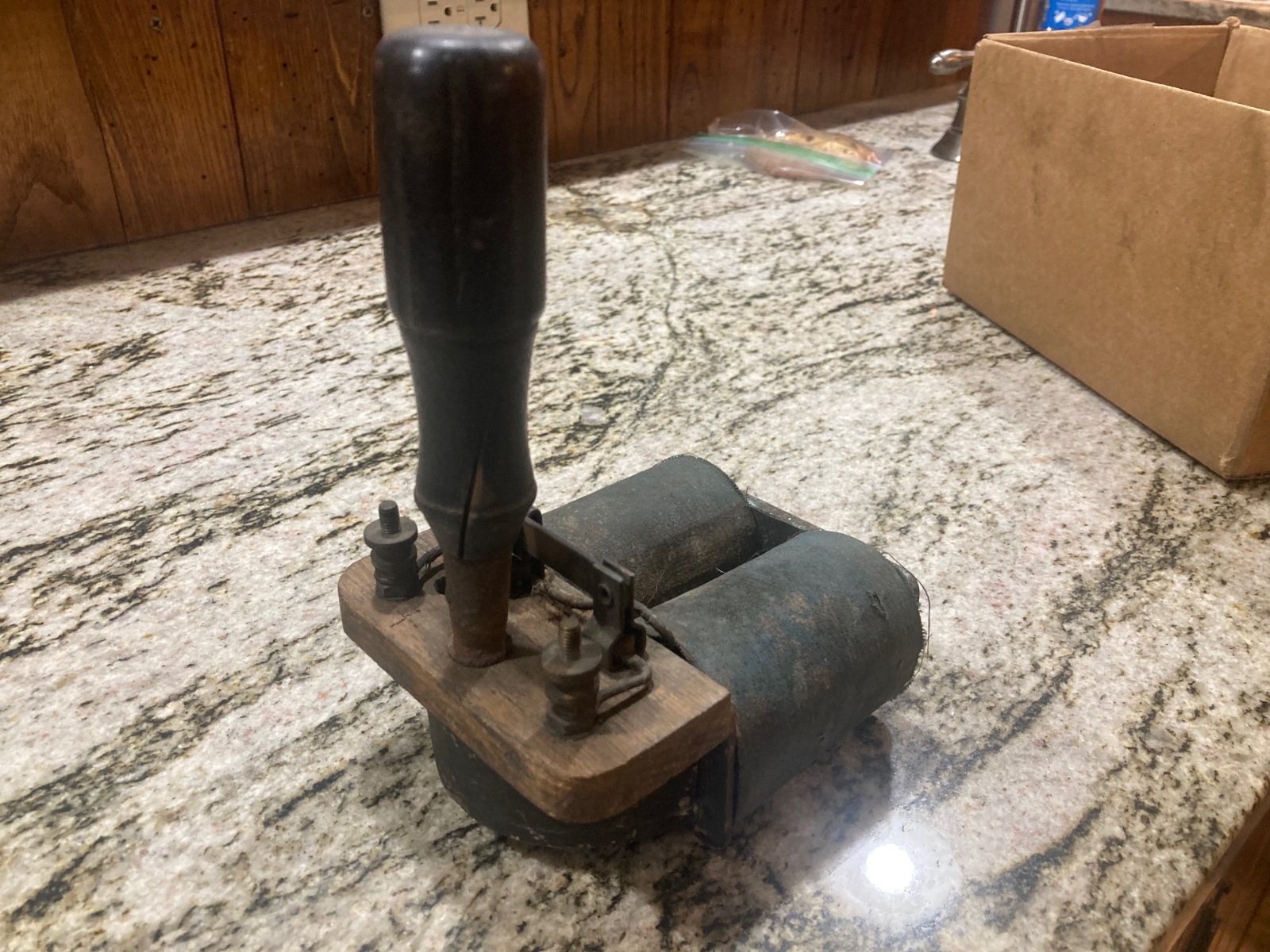

Hello, a club member is trying to find out information about his magnetizer and I thought I’d post it on here to see if anyone could help. Google has not turned up anything useful so far when searching “FORE ELECTRIC CO.” You can see a + and - symbol pressed into the wood next to the terminals. I’d like to find out what voltage to use and for how long to charge a magnet. We do know that this unit was used in the past and it is in good condition.

I believe it was originally connected to a 6 volt battery. Don't leave it connected for very long or it will become toast.

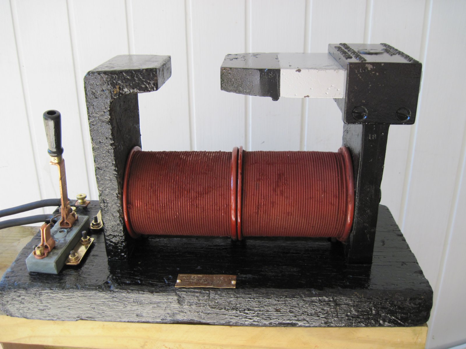

I own its grandfather that was made to charge magneto magnets.

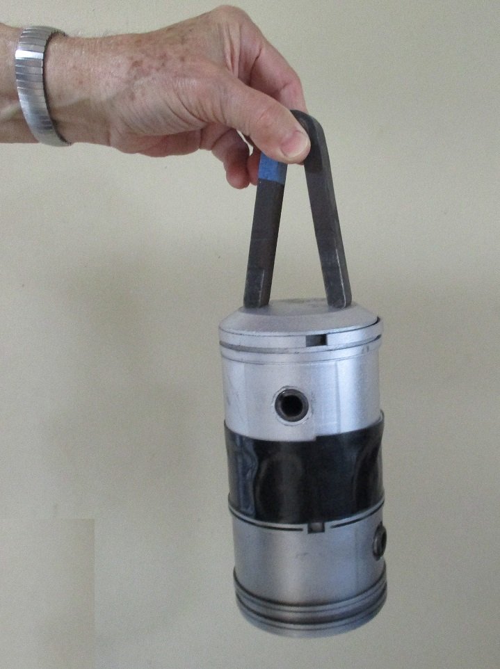

I Zap the magnet three times, laying on its side with a one inch over hang, flipped to the other side with a one inch over hang, and stood up in the middle area.
Each position gets a 5 second Zap.
Henry Ford says the magnet only has to lift an iron piston and they weigh about 2 1/2 pounds.
My magnets will lift two pistons taped together with no problem.
